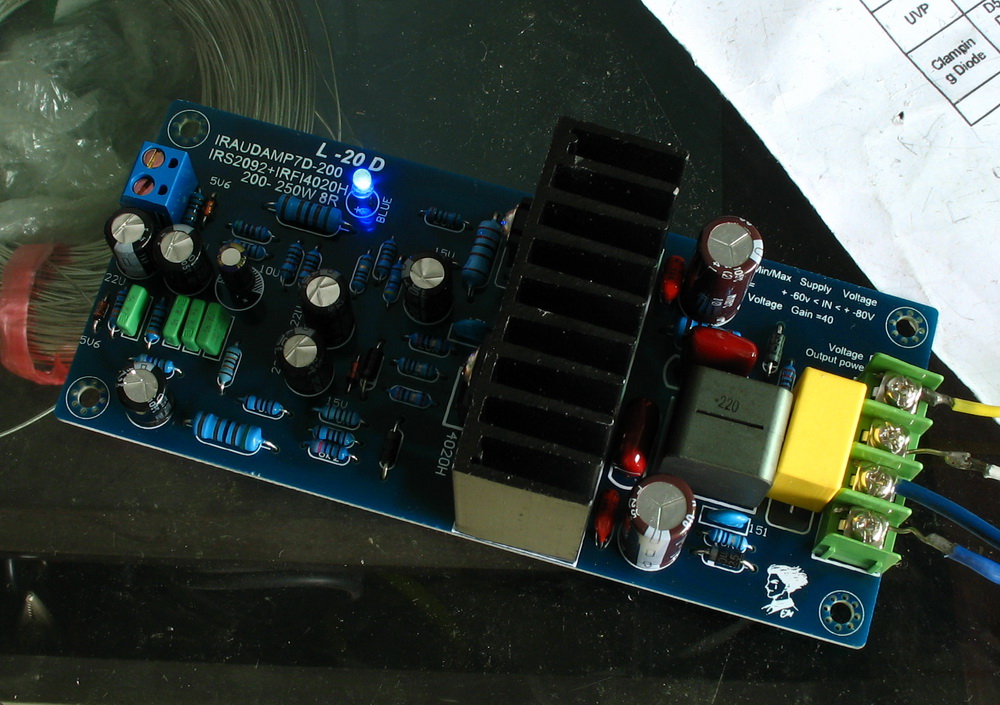

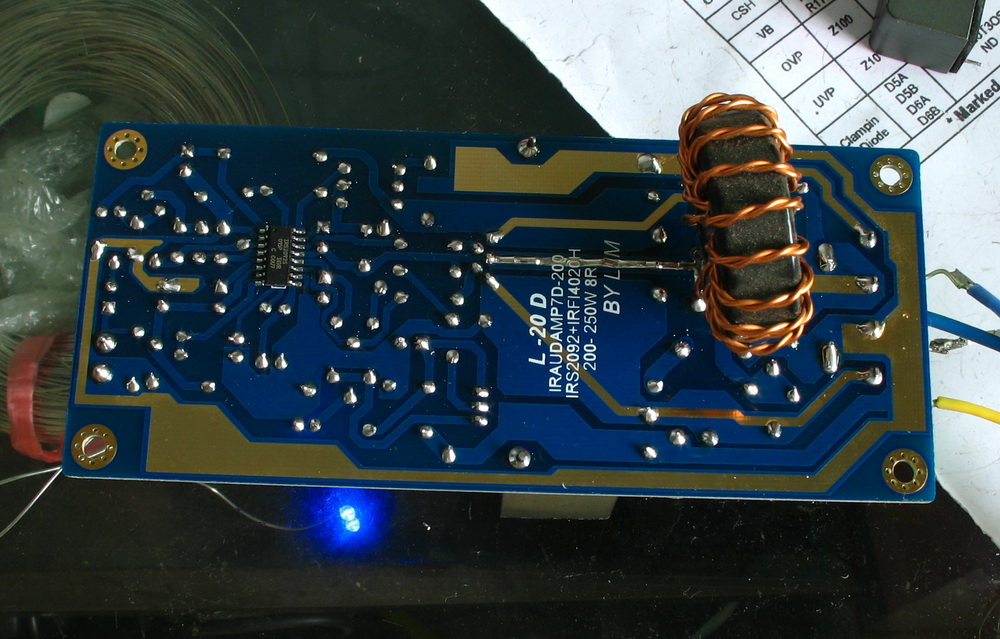

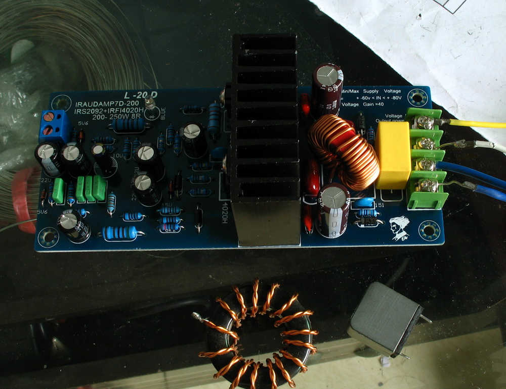

My design L20D IRS2092+IRFI4020H 200W8R
This is me a new design of the AMP. He had since the IR company demo version IRAUDAMP7S-200.
It USES the IRS2092 driver IC, and the IRFI4020H special mosfet output
Its power can do 200 W 8 R (+ 65 V). So I call it the L 20 D.
This version after four times improved. Scrap a lot of PCB to attain my design requirements.
In the test of the wave and test performance he almost and IRAUDAMP7 is same.
And before the same circuit design out, but often appear waveform distortion phenomenon.
I'm glad someone can like this design. It is very small, very beautiful. And a good voice, power is big enough.

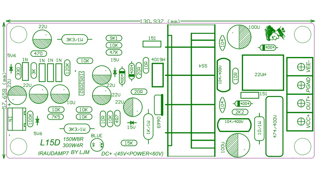

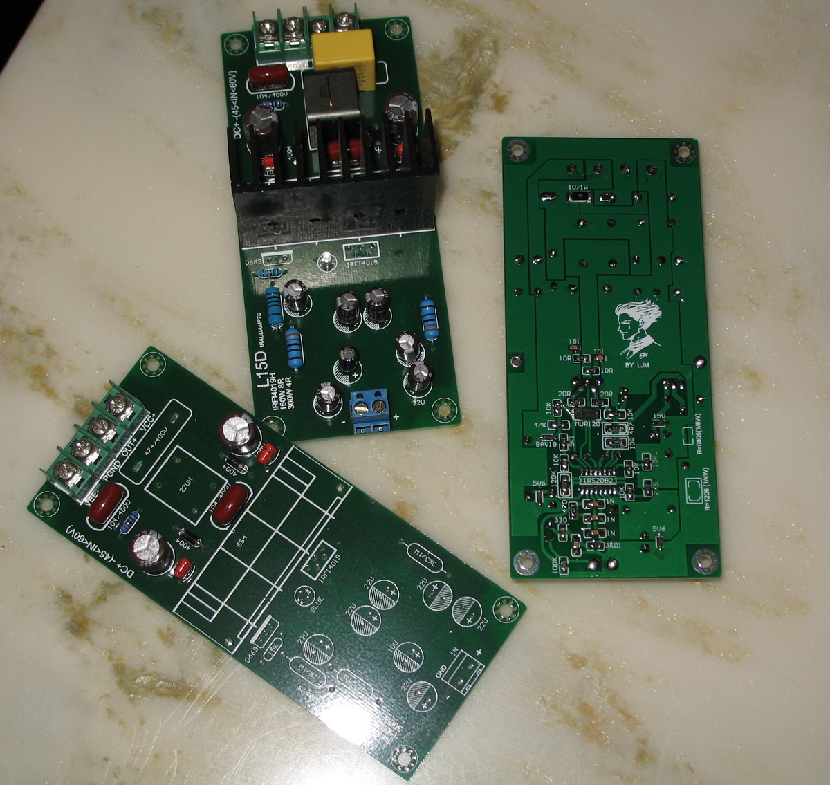

Before that I also had a similar design IRS2092 + IRFI4019H design.
It USES the double-sided PCB. This design more simple,
In the case of relatively than, I prefer this one more.
Perhaps because of a single panel more trouble, design a little more difficult.
But the single panel PCB line of the generation between capacitance can more small some, in the test performance will be better.

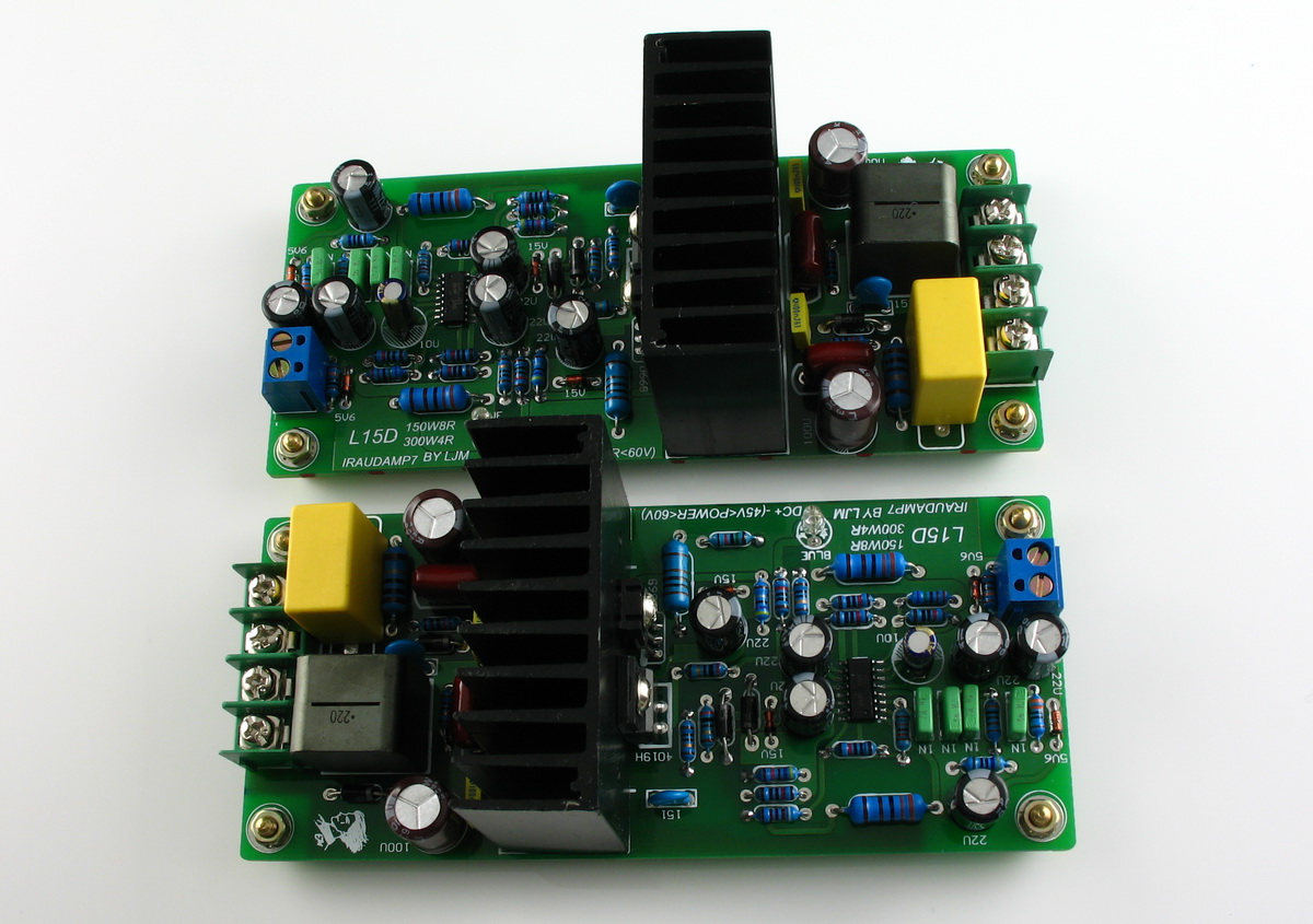

What's wrong with your L15D? It looks similar to L20D.
L15D I designed two kinds, one kind is straight into parts.
A is for the spare parts of the piece.
Straight into version without a problem, it's very good. L 20 D is in L 15 D straight into in the modified version.
And L15D SMD piece for the version failed. It appeared not normal and stable phenomenon.
This is the stable operating L 15 D.
It USES the IRS2092 IRFI4019. Work in +-about 50 V
Can output 125 150 W 8 R

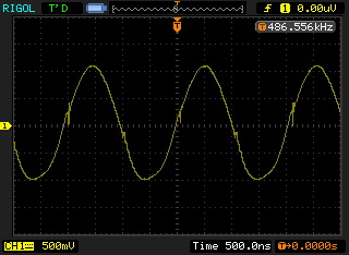

About inductor measurement
In this. I want to test several commonly used in digital amplifier on the difference between the inductance brings.
I found in this more formal test domestic few. Most with the words to describe the sound science describe inductance in digital amplifier the difference on. I think not reliable.

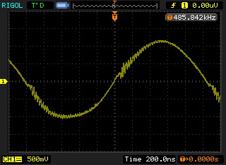

Test I put the frequency of the power amplifier L20 D set for 480 K, this is most commonly used frequency of D, too much can cause serious low efficiency, low fever will affect the sound reductive degree.
The first test of like can be used for FM radio frequency and so on the red ring inductance T94-2. Because Tripath company was in their TA2022 demo version was used in the inductance, that a lot of people think that red digital amplifier inductance is on the special pronoun.
In the test the inductance of the performance
Can see. The output of the wave appeared after LPF of obvious oscillation, similar to the self-excited shape.

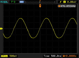

The second test of the inductance is TAH gave me, he used in high power professional digital amplifier above, iron silicon aluminium inductor.
This the inductance of the core is expensive. Import words want to a few yuan. Because it's their bulk, I only have put this in the back of the PCB soldering.
From the above test can see, iron silicon aluminium inductance performance is very good. Almost no problem, to know the switch of D will have a little bit of burr process. The same circuit different components of the PCB and get the line can have a big impact, of course, the smaller the better is....... To see now that I used digital amplifier special inductor

Ljm_ljm, I notice that International Rectifier do not suggest using the iraudamp7s containing the IRFI4020 with a 4-ohm load. But the IRFI4020 seems to have a higher current rating than the 4ohm-recommended IRFI4019. I am assuming that if I drop the supply voltage to nearer +-50V that the L20D will drive 4 and 6 ohm loads OK? Am I correct?
Thanks.
ljm_ljm,
FYI - the L20D from this Ebay source has 63V bypass capacitors on the supply rails. The board is labelled as handling 60V to 80V :confused:
2pcs L20D IRS2092 200-250W X 2 Class D amplifier sc | eBay
When testing amplifiers, the first thing I look at is the bypassing. At least the L20D had ceramic bypasses on the supply rails (100V rating) (so many don't), But the main capacitors measured 0.12 ohms ESR and so were headed to the junkheap as soon as they crossed my doorstep, as I draw the line at about 0.05 ohms right now But you might be more interested in their low voltage rating
Incidentally, my two boards only needed about 45 volts to start operating properly, and I haven't taken them above 55V yet. They are running beautifully there, giving my 100W 4/6/8 dummy-load a run for its money at that voltage :)
