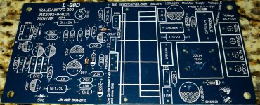

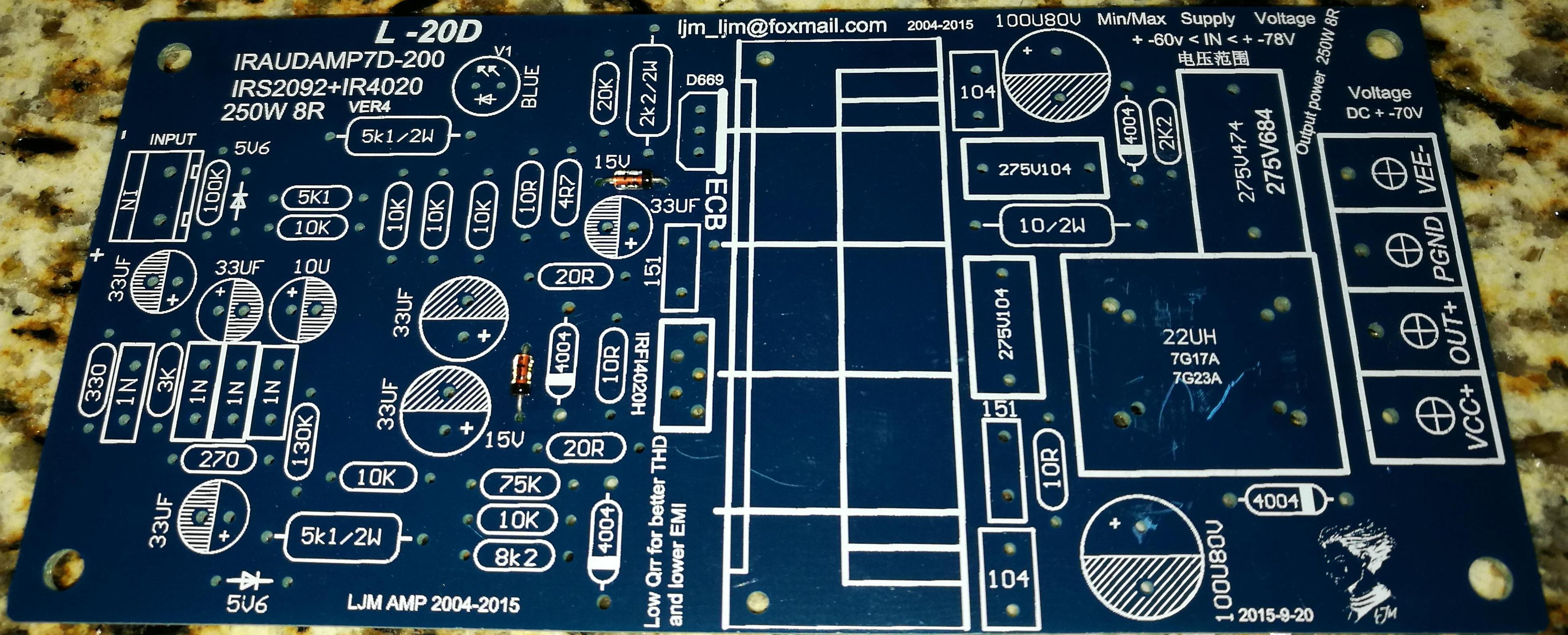

Seems to be a v4
EDIT: What are the differences between V4 and V5... V7?
Hi again I have 4 L20d amps 2 working and 2 not, I have changed the fake D669 transistors and IRFI4020h and IRS2092 ic with genuine ones and checked voltages which look good but they just wont start, the led doesn't light up, anybody got any clues as to why?
hi
nigel is normally one expert at this IRS2092 boards. i read that if the FET are gone "normally" they take the IRS2092 chip too !!... so check if the chip is sane.
chris

I often found the 2092 was taken out when the mosfets blew.
As mine were in sockets it was easy to change it at the same time.
If the gate/drain on the mosfet blows it shorts 2092 outputs to b+ and takes out the 2092.
After changing blown mosfets then finding they blew again I just changed 2092 as a matter of course each time.
