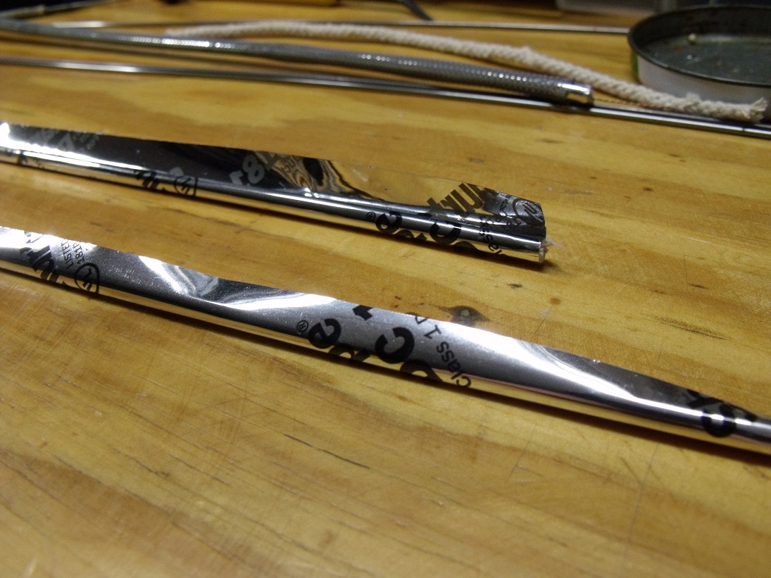

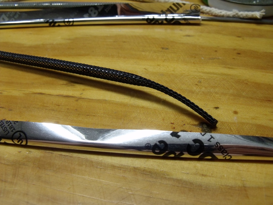

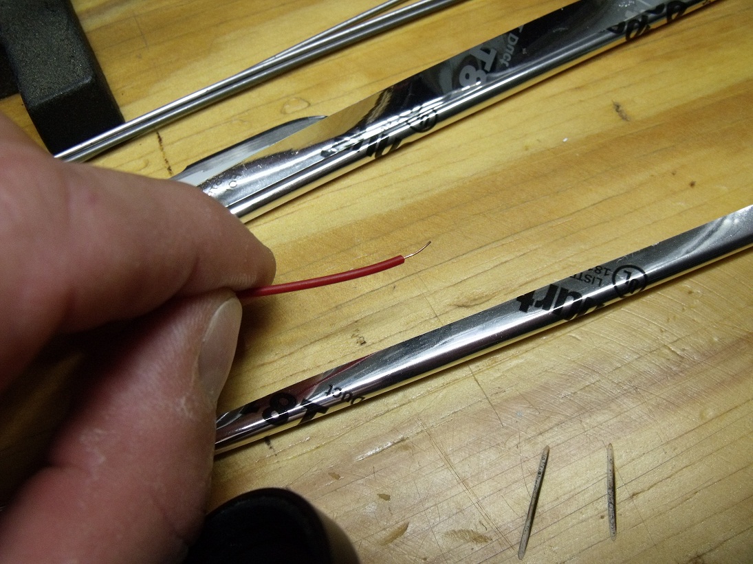

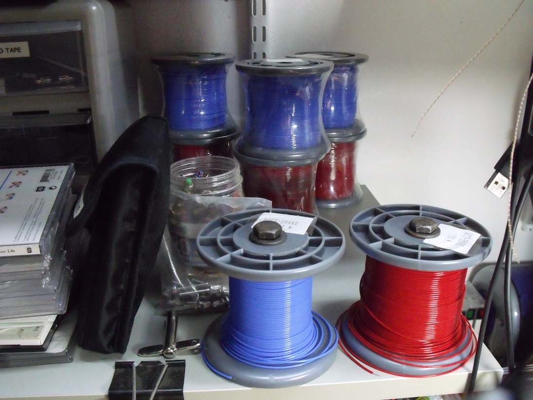

I wanted to get a quick few pics in showing what happens when you don't sheath the shielding after construction. It unwraps itself a little...but it can be easily re-rolled. If you wrap it in some texflex immediately after, in a few days it will not come undone. Also, here is a pic showing the 28 gauge silver and wire bundles that I purchased from Neotech. The conductors come encased with teflon...and if I remember correctly, you can choose the option for PVC when ordering.
Since I have plenty, and do not see myself making 100 more cables...I will post a thread in the SWAP MEET section for those interested in purchasing a few lengths of either copper OR silver. This way you can design your own now that I have shown my techniques.

Sorry for the delay...the weekends pass by too damn fast.

Actually, the foil shielding is airtight. You see, the adhesive works to keep the air/moisture out. That is another advantage that I have not gone into yet in this thread. If you seal the ends where the conductor connects to the RCA with hot glue...it is a moisture tight environment. Here is another interesting thing....the foil shield is just the right stiffness, that allows for a coiled cable (as seen in one of my pics)...BUT keeps it from kinking. So, in essence, your valid points are easily self cured by the foil tape.

3 years after construction, I cut one IC in half to see if there would be any oxidation. Nope. Shiney silver/copper.

It's not just the glue we are referencing here. There are approximately 4-5 layers of foil tape surrounding the cotton. The foil tape is made up of aluminum layered onto a polymer with adhesive attached. The adhesive is designed to adhere well onto the surface it will bond to. This foil tape is used in air conditioning/heating ducts to prevent AND SEAL adjoining surfaces.
