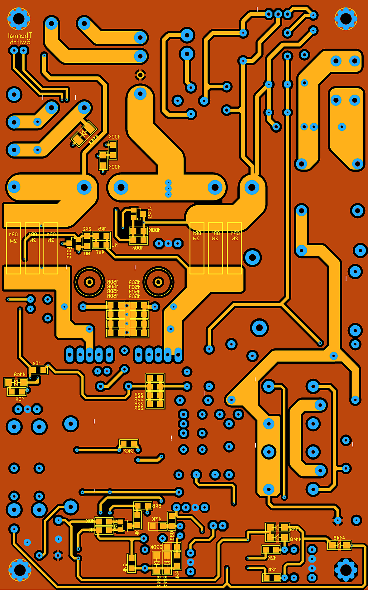

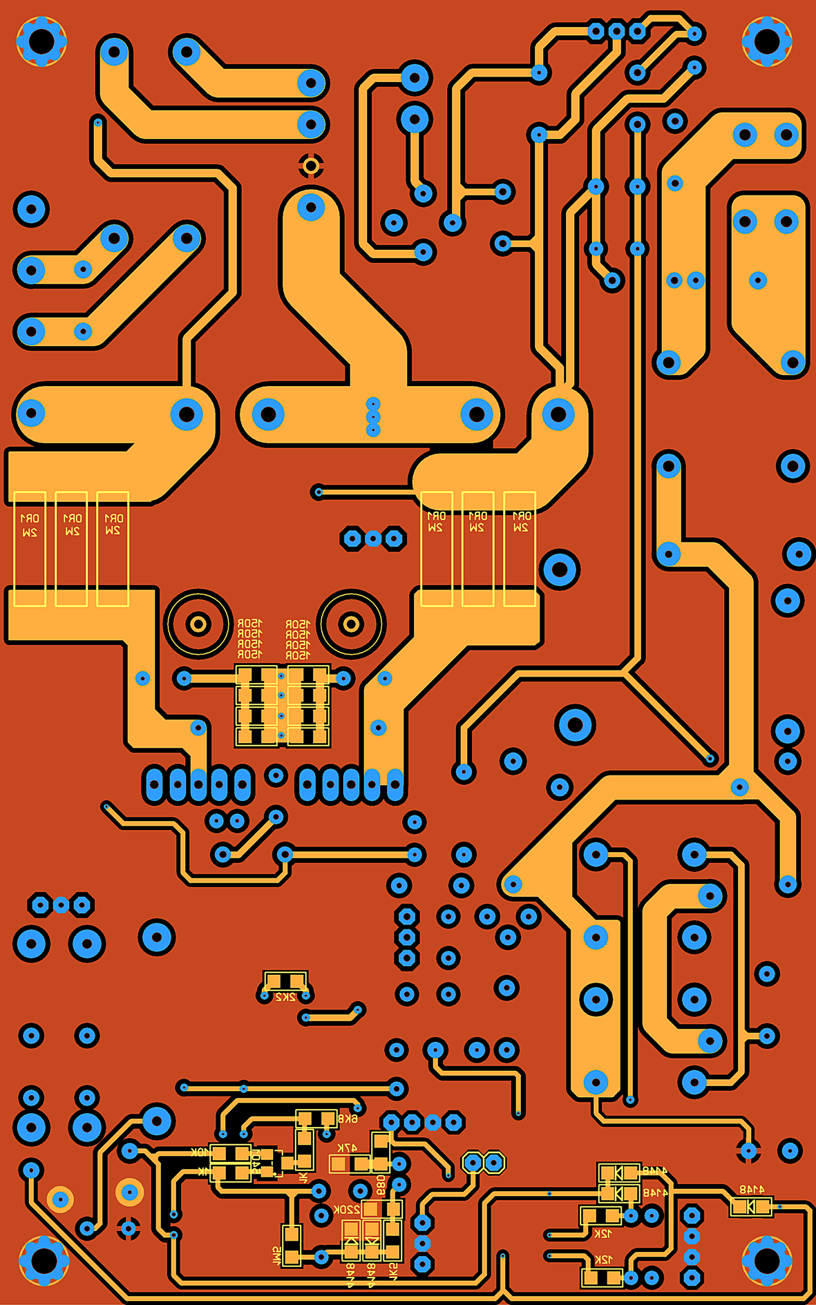

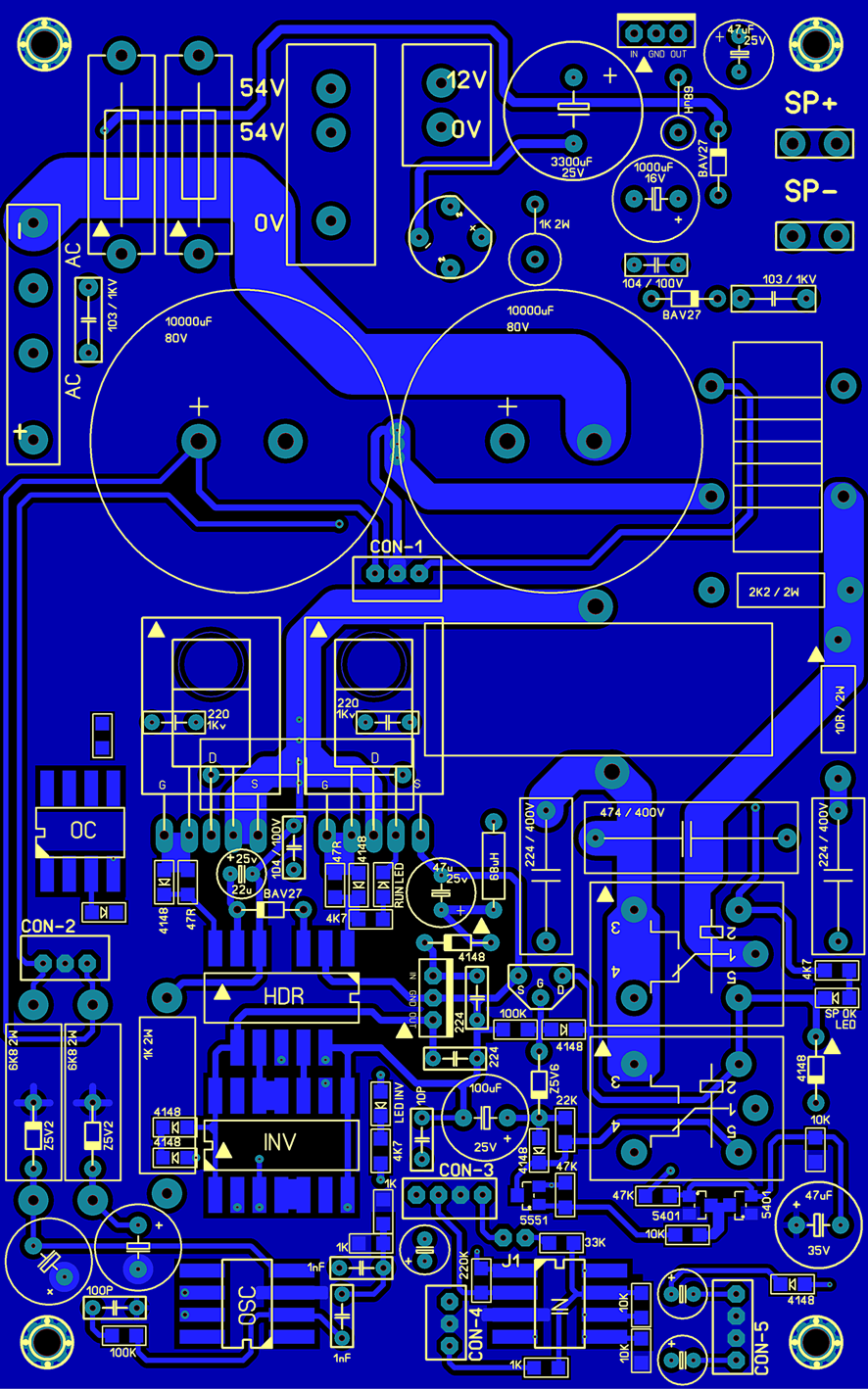

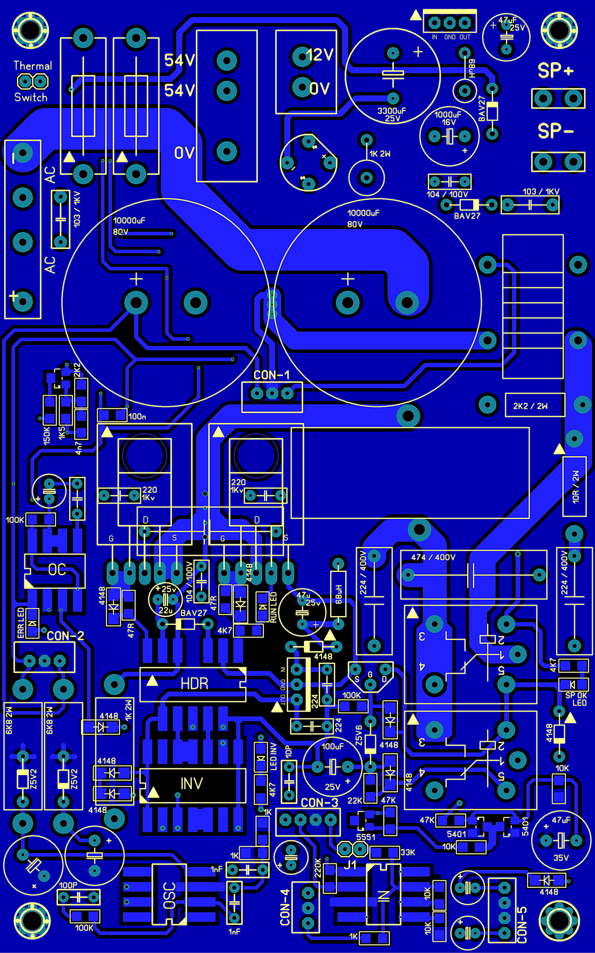

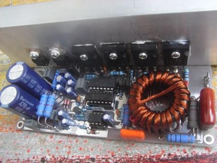

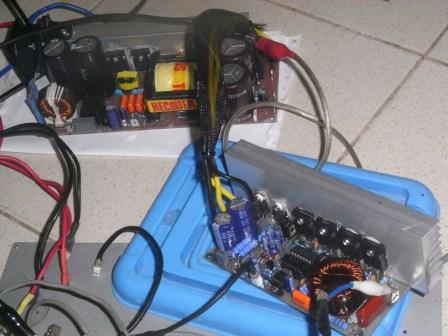

Hi All,
Thank you for Manojtm's Aud900 schematic . This is mine,without protect and balance input section. Sound great compare to IRS900 . All ICs are cool, but fets and coil are warm to hot. So fan is needed . Test with SMPS +-80VDC.
There are some modification.
