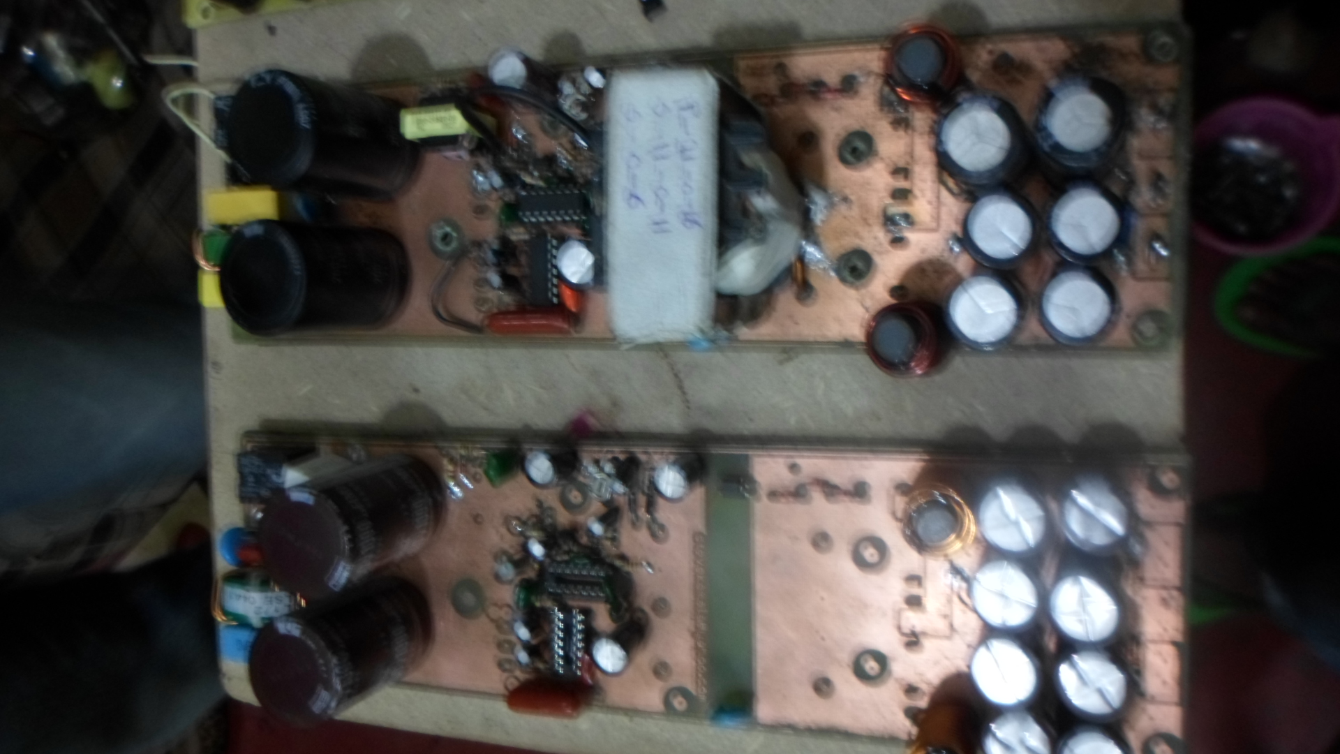

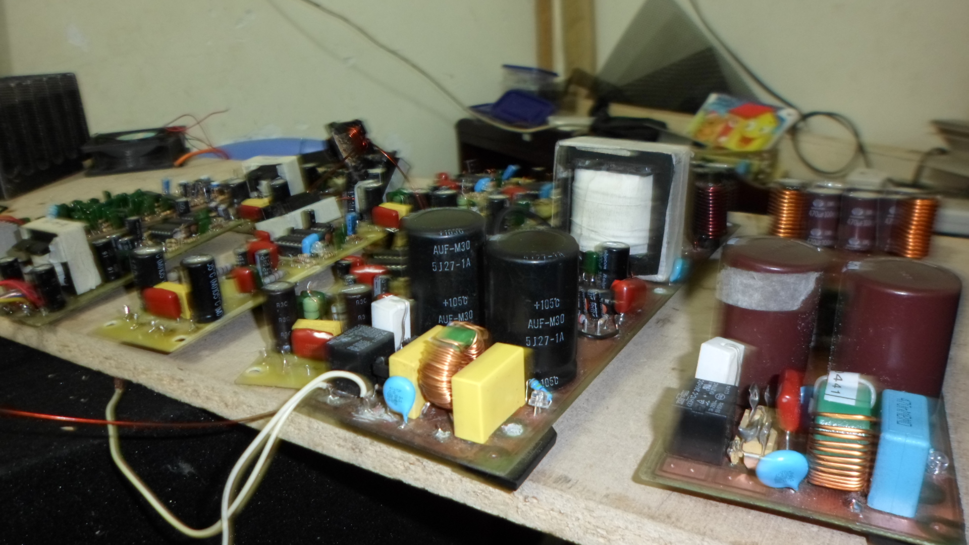

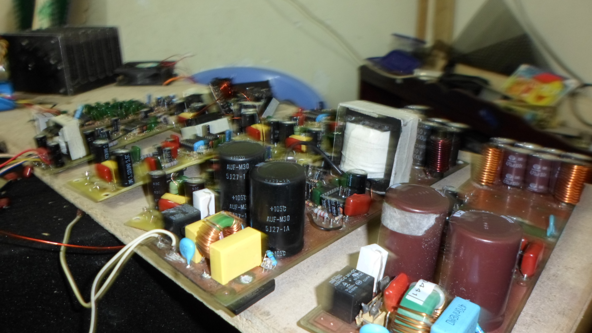

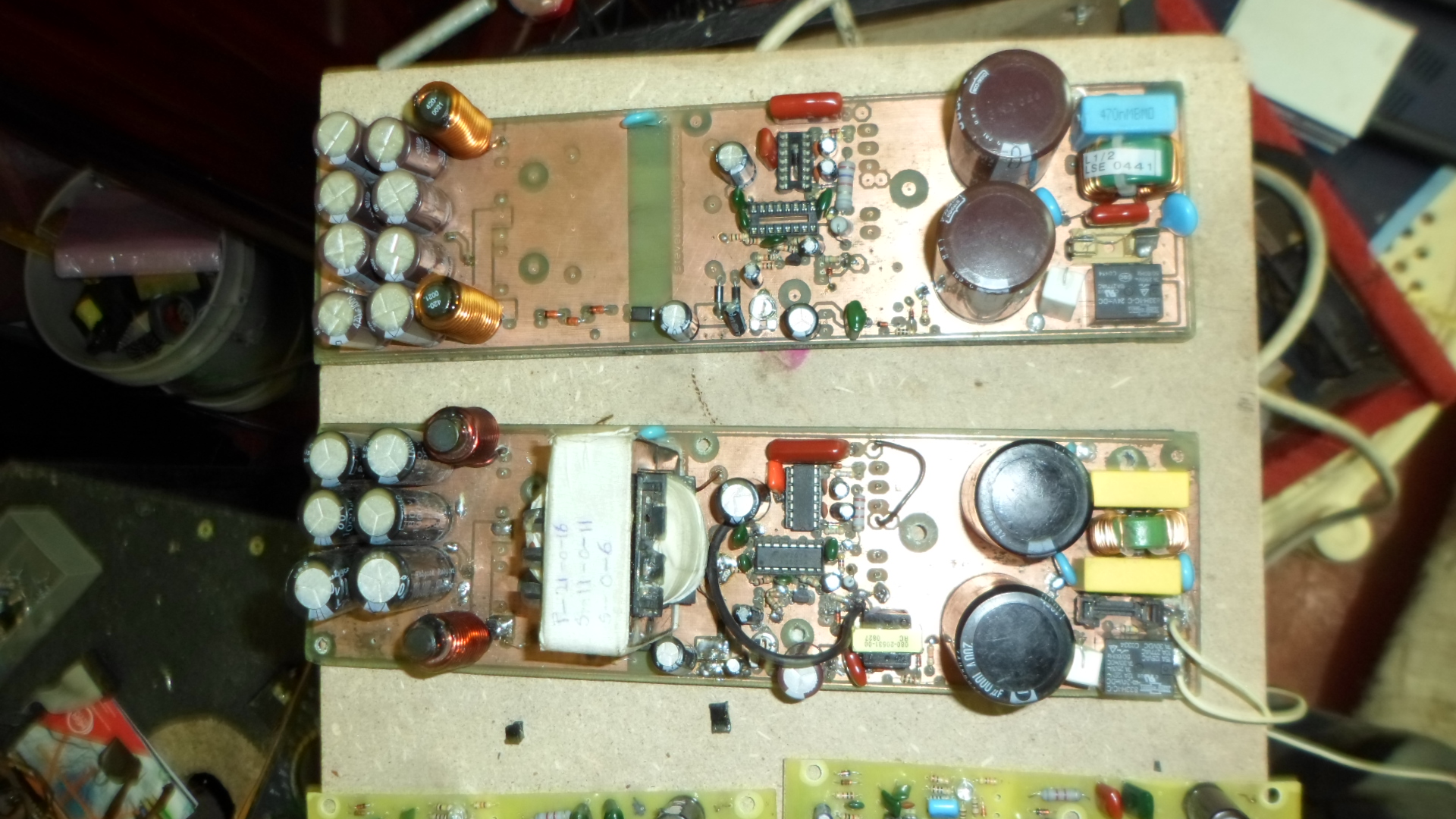

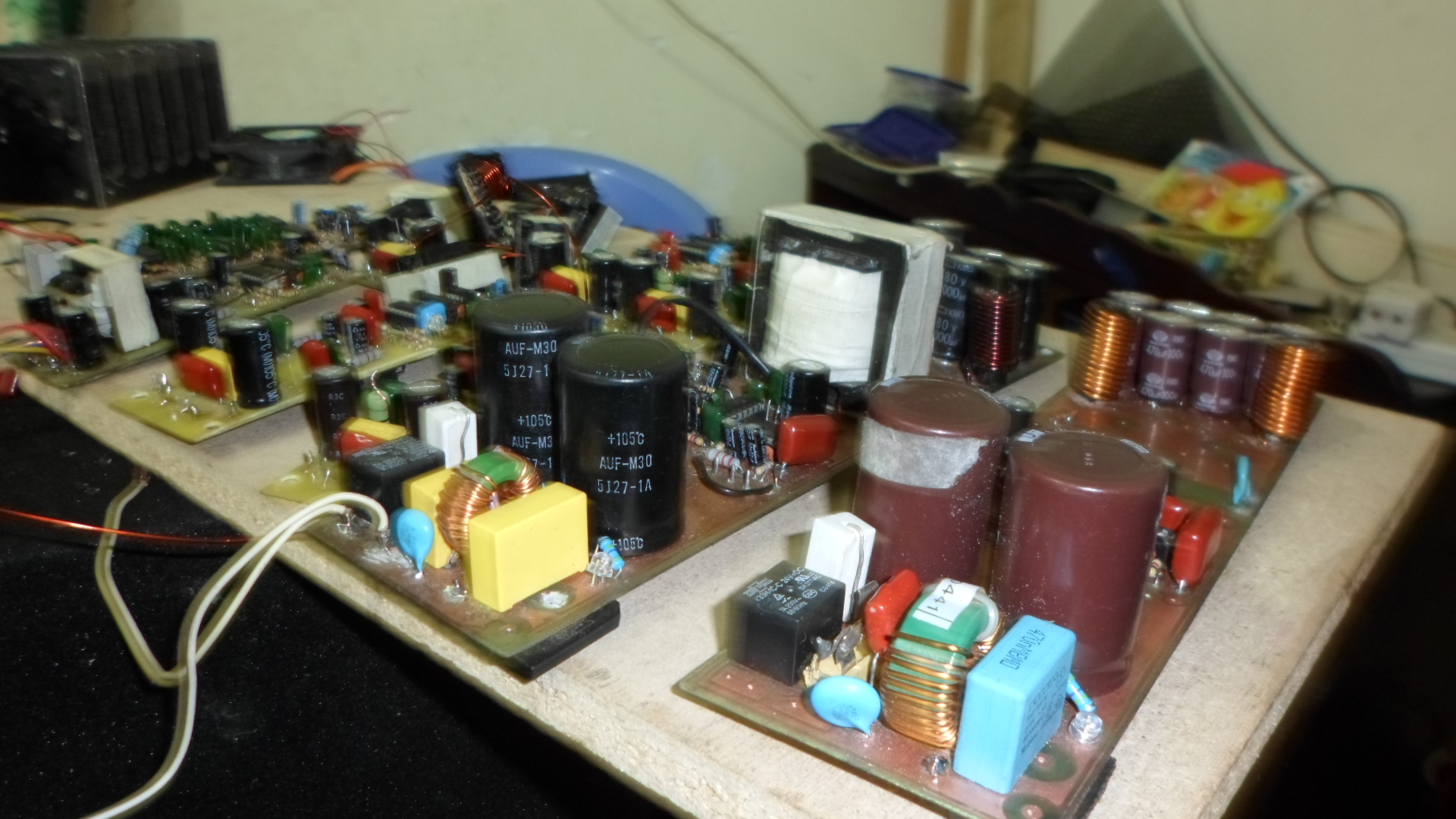

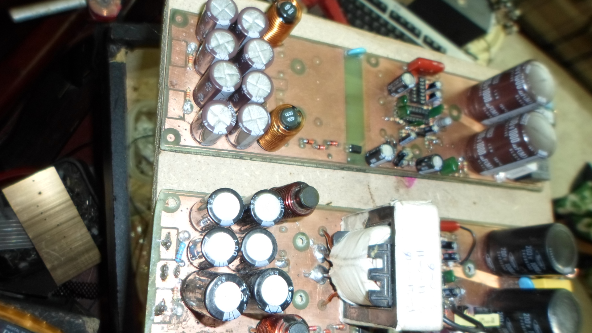

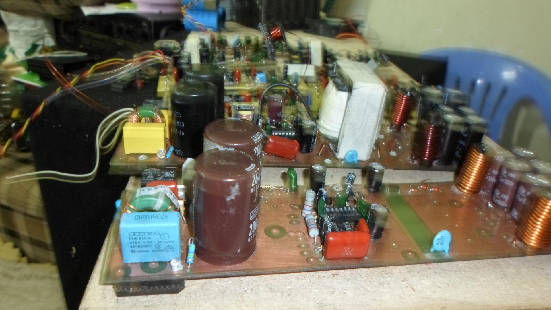

hi all pictures of the smps
i added the primary turns so as to cool the outputs . i pushed it a bit hard without a heatsink both for the outputs ,the 7815,and the diodes rbv5006 and the mur1560 except a small heatsink to the mje350
