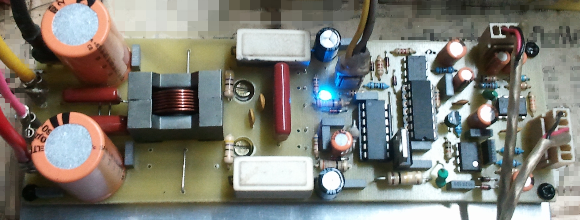

Hi All
new Coil received for testing 450KHz switching AUD600 class D amp
Regards
MANOJ
Hi Manoj: What is the advantage of those cores?
I have arranged T106-2 & T157-2 from micrometals.
Raj
Hi Raj
Dimonis recommended this coil says good for low THD.so i order sample
http://www.diysmps.com/forums/showt...-amplifier-based-on-IRS2092-Commercial/page17
post #164
Regards
MANOJ

Hi All,
AUD600 Rev1.1 with IRF540 MOSFET and Coilcraft filter, Supply rail +/-45V amazing power
i feel proud on AUD600 and it will give same power (my feel) on 45v supply no need 75V rail
Regards
MANOJ
Hi Manoj: how come coil can contribute for power outpost? I mean that huge difference? 45v and 75v is huge dirrerence.
What is the fsw?
Raj
What is the fsw?
Hi Raj,
using coilcraft filter with IC7404 fsw= 325KHz;IC 4069 fsw=205KHz and IC7414 fsw=110KHz
i want fsw=400KHz so i will change MOSFET IRF540 to other one
not actual watt, i said it was my feelI mean that huge difference? 45v and 75v is huge dirrerence
Regards
MANOJ
Hi Manojtm
greetings #292 nice coilcraft filter any part no how does it compare to T157-2
Hi andrew,
thanks. sound quality and power is good compare with T157-2 and very very low RF noise
Disadvantage is it will warm like 55/65 deg. temp with in 25 min. run and fsw will reduced to 280KHz(recheck again due to coil OR 74hc04)
can you tell me where i can get IRFP4227 MOSFET???
Regards
MANOJ
