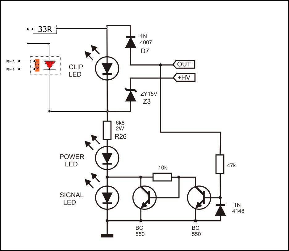

Hi Manoj:
I am trying to make a complete board where BIAS and all kind of protection will be present.
Please have a look and modification instruction is welcome.\
Raj
