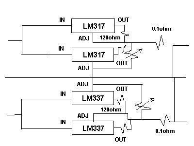

well, if i paralled the LM3x7 for both + and - rails and placing those 0.1 ohm resis. the schematic will be like this:
am i right??
deepanger said:
hey good guys..dont leave me in the middle of it!! :(
ineed someone just to check the previous diagram plz..
Unfortunately, it is not clear from your diagram which lead is which, and at a quick look it doesn't seem to be very consistent.
Whatever you intend here, each similar lead from the same polarity device must be attached in an 'identical' way for the two devices to be truly in parallel.
Conventionally, when using a 'box' to indicate a 3 terminal reg,
it is shown with the input at the left side, the output at the right side, and the adjust (or ground for fixed regs) lead at the bottom and in the middle.
If you have used this conventional arrangement in your diagram, it will not be correct, but you show no labels to indicate which is which.

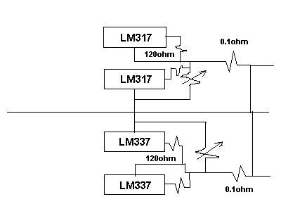

As I suspected, this is not quite correct.
Bear in mind that the 'adjust' resistor needs to run between the adjust pins and ground.
If the unmarked horizontal line is ground, it looks like with the LM317 that this upper 'adjust' resistor goes between the adjust pin of the upper 317 and the adjust pin of the lower 317, and then the connection goes via ground (if this a *connection* where it crosses the horizontal line?), and/or then on to the 337's adjust pin.
AX tech editor
Joined 2002
bench
Bob is right, the top and bottom regulators don't do anything. You need to connect ALL regs as he said: all need to be set up for the correct output voltage independently. Then, for say the pos pair, each output must go via a separate 0.1 Ohm to the final pos output. Same for the neg pair. It really is much simpler than you seem to think.
Jan Didden
deepanger said:
i think its right now!!
"this s for the pos. side only of course"
Yes, that looks fine now, but I cannot vouch for the 0.1R resistors at the outputs as they were not the result of my recommendation. But this is what some of the other posters have said, and I have no reason to doubt that it is a good thing.

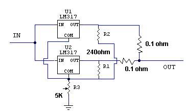

hi again..
ive build the pos. side of the schematic with 2 paralleled LM317s
the output volt. is ok (from 1.3 upto 35V noload) ,when the circuit
is loaded providing about 13V and about 0.5A, one of the reg.
gets too hot that it cant be touched for 2sec. while the other reg. is so cool :clown:...
dont know its obvious that the 2regs. dont share equal amounts
of current, ive swapped em so ican guarantee that theres nothing
wrong with the wiring, but the same reg. is so hot and the other
is cool, i tested each one alone, both working fine "albeit they
gets really hot caz of the dissipation (35-13 * 0.5 = 11watt)"
any ideas about whats wrong?

AX tech editor
Joined 2002
bench
Revieuwing the schematic I see you are running the two regs from the same ref (common 5k pot). Since they will never be exactly the same, the outputs will not be exactly the same, and one will supply the bulk of the current. The normal cure is using low value resistors as shown. Maybe you need more here (try .5 Ohms Bob?). You can also try to supply the ref from a single 240 Ohms from the final output instaed of from each reg output.

u mean those small 0.1ohm at the output of each reg.??
all idid is to place some diff. value resistors b4 the input of that
reg. that gets too hot, by the way am working now with two
identical regs. (both from radioshack from the same manufac.)
but the same prob. happens ,
anyway are there any guaranteed methode so i can make the 2regs share the same amounts of current even using a more complex methode?
