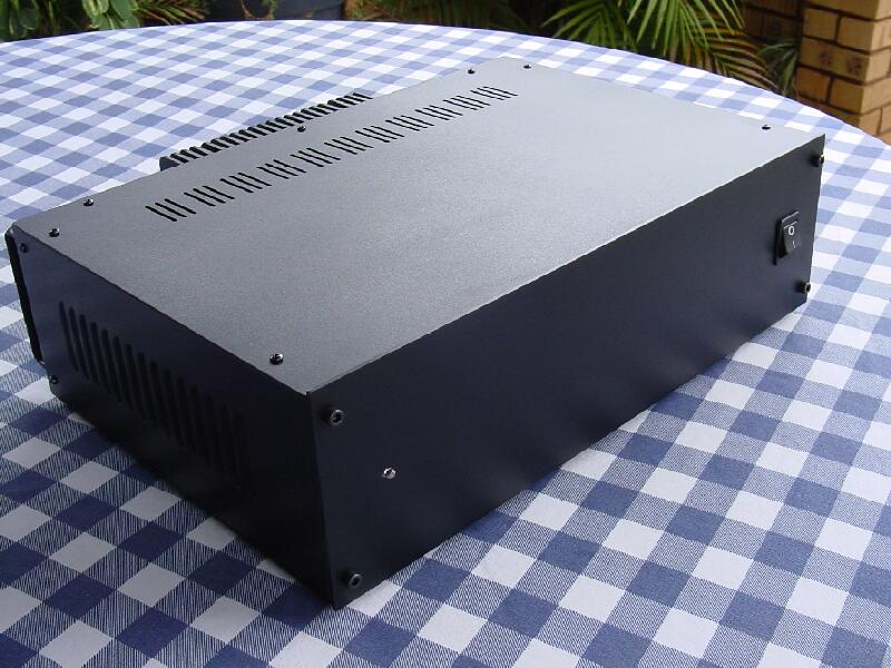

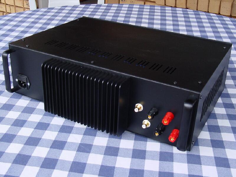

Some pics of my new amp
Here is some pics of my newly completed amp.
The transformer is a 550VA C-core one with 4x 28Vac outputs. There is space for a second one, for future upgrades.
The blue caps are Sprague 10000uF caps.
The sound is AWESOME! The bass is clean and precise while not drowning out any detail.
Great design Mauro! Thanks Rudi for all the help with this amp project. Appreciate it!

PSmithMX-
Really beautifully done work. It looks like you have done these before. What kind of case is that? I like the layout.
I agree with you on the sound. I was most impressed by the combination of excellent detail with a total lack of solid state sheen. Everything sounds coherent and musical.
I have put my $1400 tube amp up for auction- this sounds better, at least in my set up.
