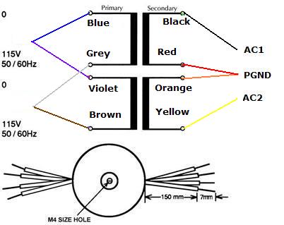

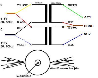

Brian-
As a new poster my messages are delayed, but I think your diagram clears things up.
I have modified it to match my color scheme I think
If I interprete things right, my AC primary inputs are fine as they are. Secondary Black goes to both boards AC1s, Blue goes to both boards AC2s, and the red/brown junction goes to both PGNDs.
Please confirm before I solder - also - please that my Avel transformer is the right rating - that is, this amended hookup will result in 25 volt output given the Y236801s standard 25v output ratings.
Thanks in advance.
George

There is a problem with the way you have it stated...
On your trafo, BLUE is a primary and Yellow is a secondary.
Here's the picture with your trafo colors
[EDIT]: Looks like your picture was wrong but text description was wrong, probably confusion due to the colors not matching the words in the pic. I think you have it though.
Disconnect the trafo from the boards. Then try to connect the secondary as Brian said...don't connect to the boards, you have to control the tensions on the secondary before, just to be sure.
You have to find something near 50/55V (remember...there is no load connected) between yellow and black and 25/28V between the center tap and the black/yellow.

groch said:
Their wiring options are shown here: http://avellindberg.com/images/misc/tech notes/ps_configurations.jpg
Hi Groch for the secondaries use the wiring diagram which is on the lower right hand corner of the image you have above. Only for the secondaries.
You will then run two wires(one for each board) from the black lead to AC1 on each of the boards.
You then will run two wires(one for each board) from the RED/ORANGE(which should be joined) to GND on each board.
You then will run two wires(one for each board) from the yellow lead to AC2 on each of the boards.
Wire the primary to you mains as shown in the diagram on the top left that is join the blue and voilet, and connect them to mains hot. Join grey and brown and connect them to mains neutral. It is not critical which mains lead goes to which pair. But it is critical that you join the trafo pairs correctly.
Don't forget to use a fuse (I am sure you already had) I would use a 2-4 amp fuse.
Brian's diagram looks right on.
Cheers!
Russ
