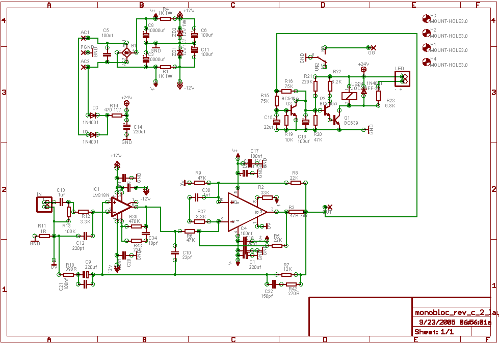

Sorry got tired at page 30, where is the final circuit diagram for the Rev C? unfortunatley there was no circuit printout in the package (nudge, nudge, wink, wink), I assume connecting a component to every hole on the boards would not go down so well....

Nordic said:Thanks Russ, very fast, you can get back to the building guide now,
PS the circuit you posted excludes the PSU?
PSU is basically the same as that for rev A at the beginning of the thread.
Give me a few and I will post a complete schematic from eagle.
