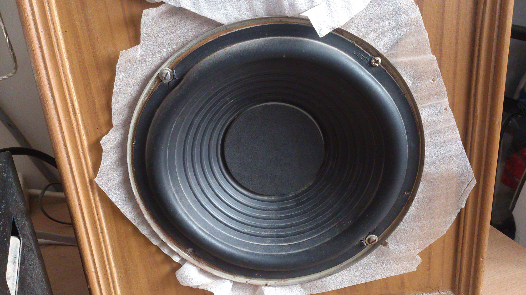

I experienced this with some Spendor sa1 speakers
