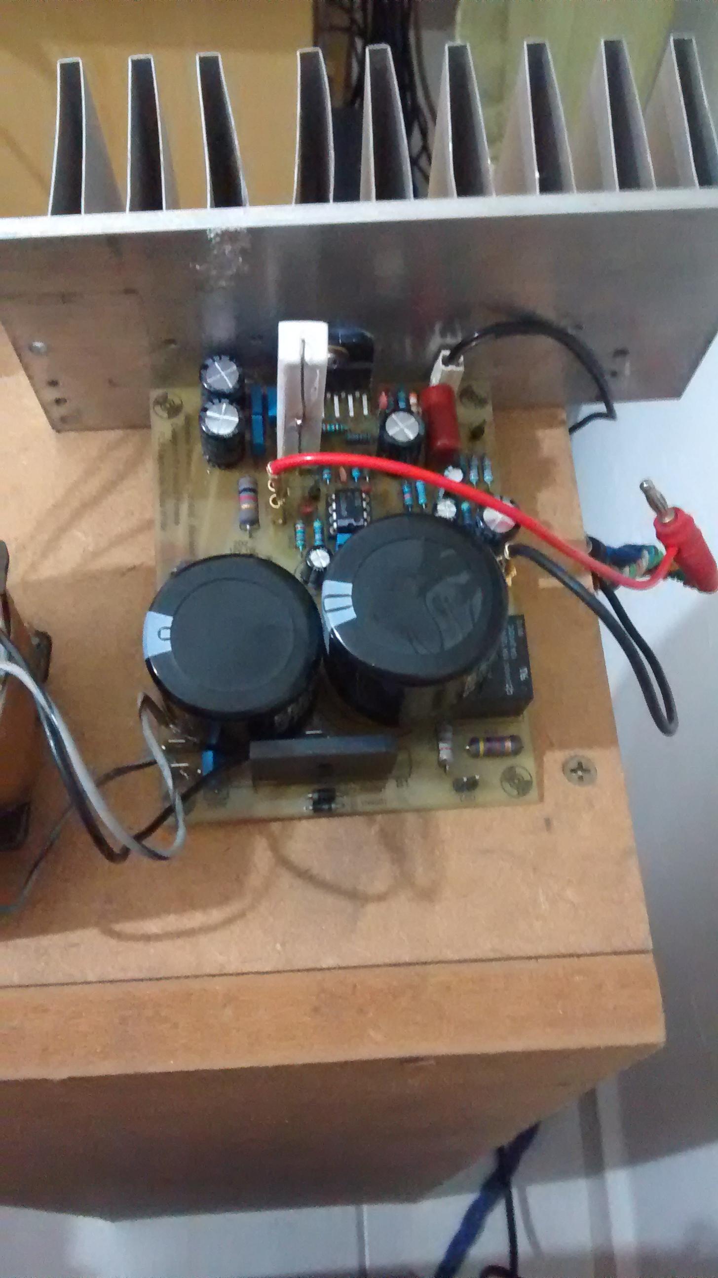

I just wanted to humbly make available my single side "REV C" monobloc design which is suitable for REV-A/B/C (with a little simple re-arrangement).
PDFs
The PDFs are suitable for the toner transfer method as the copper side is not mirrored, and the component side is.
Please enjoy it if you are capable of etching your own boards.
If anyone makes a good amp with it then this journey has been worth it for me.
Thanks to everyone who has made this a lot of fun (and very educational) for me. The results are largely thanks to you. Thank you Mauro most of all.
Cheers!
Russ
EDIT: fixed the link.

Question about using 318.
First, to the OP I would like to say very nice implementation and congratulations.
It is curious that you chose the 318 instead of the more popular op amps. I haven't seen one since the 80s. I realize that it is very fast and has good DC performance, both probably useful for your circuit.
Did you use any overcompensation on the 318? It was often recommended for audio circuits, and the couple of times I used one I did it. Did you consider this in your design and prototype?
I'm working on a design for a nested 3886 amplifier. It will be much more modest than yours. After looking at your circuit, I was thinking about trying the 318 for the front end. For a simple nested, buffered inverting op amp type circuit, is their any advantage to using the 318 over say one of the fancy Burr Brown devices?
I'm going to Miller the front end out around 300 kHz f3 for a start. The 3886 will be a simple non inverting 20 dB nested gain amp used as an output buffer for the input stage. So would a 318 be overkill or maybe even a liability for this simpler configuration?

Mauro (the OP) has left the premises, though he's still around in the real world and usually replies to email.
However, I'll try to answer some of the questions from the information generally known about the MyRef Rev C.
1) Compensation: The Rev C uses a fairly elaborate compensation schema, of which feed-forward plays an important role.
... is their any advantage to using the 318 over say one of the fancy Burr Brown devices?
Mauro liked the sonics of the LM318 from the Musical Fidelity A-370 developed by Tim Da Paravinci and others. He wanted to replicate the sonics of the A-370, but with a chipamp power stage, and the MyRef is the result. Several other opamps are usable as the outer-loop opamp in a MyRef, but the sonics are mostly worse.
If you want to use a wide variety of other opamps in a composite amp, check out the MiniRef:
http://www.diyaudio.com/forums/chip-amps/184165-miniref-schematic-pcb-layout.html
Not a direct answer, but the Miller configuration would be closer to the MyRef Rev A (except the LM3886, which is still a Howland Current Pump in the MyRef). Generally, the sonics of the Rev C have surpassed the Rev A across the board. If you want see a voltage-voltage composite amp with the LM3886, there are a few (perhaps including the Modulus).
For fresh designs, I would suggest looking at other opamps than the LM318 for the outer loop. As mentioned earlier, it is required for the MyRef because the compensation is very specific to it, and gives excellent audible sonics. However, I have used LT1361, LM6172 and other opamps in composite designs (not the MyRef) with excellent audible sonics.
