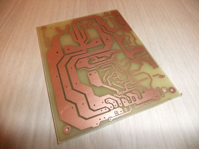

I've received my pcb's based on Rudi's design. Hopefully Mouser will send me the componentes fast.
