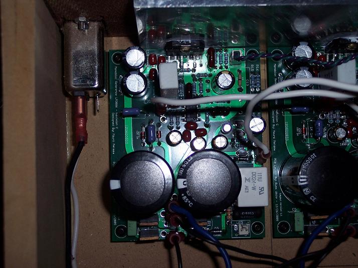

My "audiophile" LM3886 approach
Another picture, closer in.
Notice I am not using input caps. I have a jumper there instead as I know I have no DC from my source.

moreismore said:
Russ, there is no ground on the IEC block. How is anything to find ground?
You do not need a connection to "earth" for you circuit to have a "0V" point which unfortunately is also labeled "GND". The circuit GND is simply the midpoint between the rails. The chasis is wood, so there is no need to connect "earth" to the chasis. Mains ground is there for protection, not electrical function.
Mains ground and circuit ground should not meet as if they do you can introduce all sort of ground loop issues with other equipment which may be attached to your amp. This is a huge source of frustration for people, but it is so simple. Isolate circuit ground completely from your chasis (your jacks/binding posts are important here), and never connect mains GND to circuit GND.
Now some people try some techniques for joining the two GNDs, but there is abosultely NO valid reason for doing it. Circuit GND is virtual, it is a moving target, it is not provided by an external source like the wall socket. :)
Cheers!
Russ

chipco3434 said:
I'll hang up and listen for your answer.
Short answer is do what works for you, but I have never connected circuit GND to the chasis, and all my amps (including this proto amp and my mains amp which is in a par-metal case) are dead quiet. All of the gnd points only ever meet at their respective amplifier PCB which is where the star is. If you place a star anywhere else you have multiple stars, which would not be better. To maintain the itegretity of the star GND you need to make sure nothing can bypass the star. The star GND is built into the design.
Cheers!
Russ
