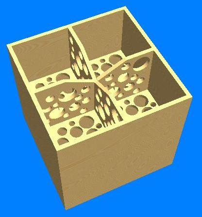

I have built the 100Hz LPF, and now that the sub is now only playing bass frequencies, I get a real boost.
As per the response graph (Attached), there is very little response below 65Hz, so I cant wait to have sound down to 35Hz. I cant wait to finish the LT! This will flatten the response to 35Hz. (Attached)
