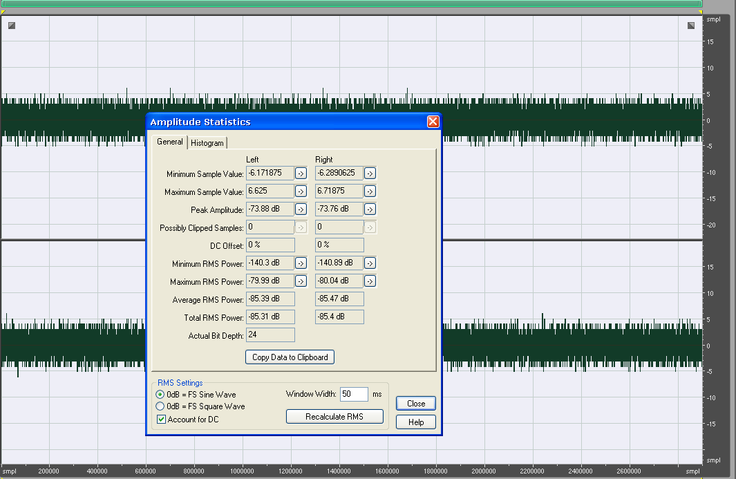

The mystery continues ... in Audacity did a precise alignment of cap1 and cap2 and subtracted, better than a 70dB null - the spectrum of the diff file looks just like what Barleywater posted.
The 'perfect' alignment gives null below -80dB with average RMS -85dB.
I am more than sure that different hardware may make some difference during replay. Yesterday I have mentioned my experience with my "office" sound system when playing the difference file.

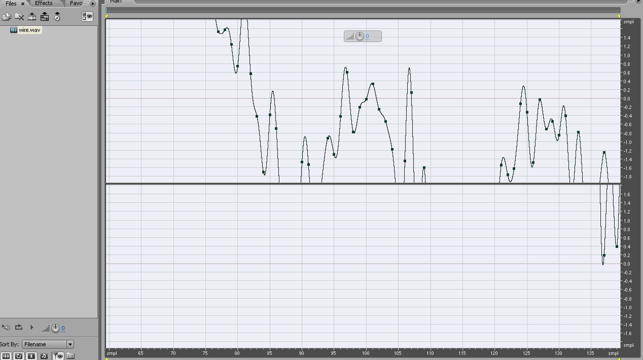

When we analyze first samples, we may see we have more than 16-bit resolution (24-bit A/D and file was used). Attached is a grossly zoomed portion between samples no. 60 and 140. Top trace signal is pretty low, and we can see it there. "1 smpl" refers to 1 sample in 16 bit resolution. For samples no. 90 and 91, we can see the amplitude difference is about 0.1 of 1 16-bit sample. This is why I like 24-bit resolution, IMO even analog noise should be sampled well.
With 24-bit analysis, and limited mess caused by D/A and A/D components errors, we are able to discern reliably even between caps like Mundorf polypropylene and Roederstein polyester - by file analysis. Barleywater has proven this. We need hardware (for file replay and recording) above certain level, to be able to do this. The question remains - what makes that difference. IMO, it is the slight difference in capacitances and thus slightly different amplitude response, as I have shown in the beginning of this thread.

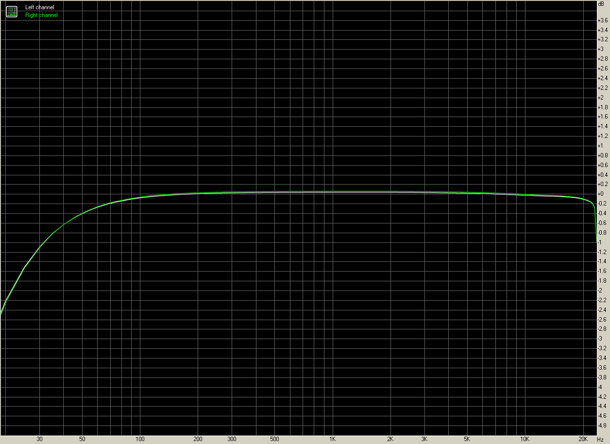

Except, the PC speakers I use have zero output below 100Hz ...
However, there is a chance that the difference in LF content being fed through the analogue circuitry, at some point before the speakers is having an effect - I'll try a copy and paste of that content, to see if it makes a difference ...
The LF difference may reflect in mids and highs subjective perception - this is well known and in case you are doing listening tests above design changes, you will find it as a rule of thumb ...
