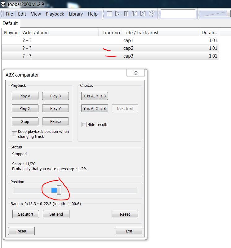

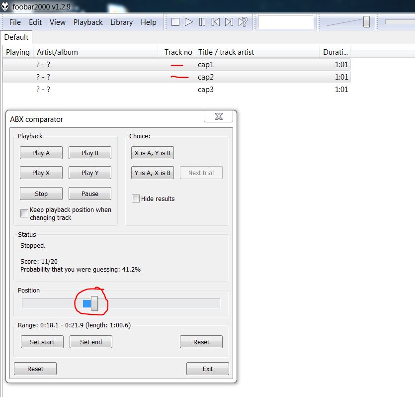

I thought I could detect differences but the results show otherwise. I would go "play A", "play A", "play A" and then play X or Y and think... same... or different, and vote... but it seems the differences are not real to be audible. Imagination

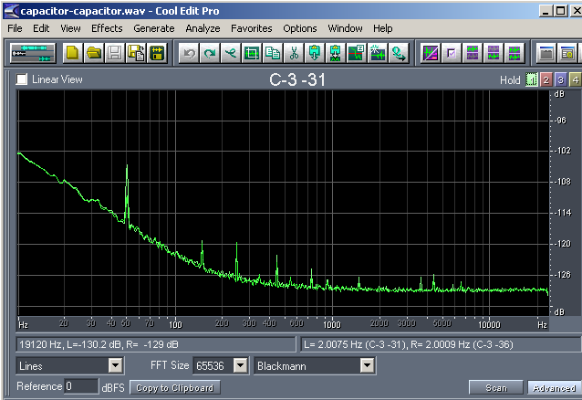

With E-MU 0404 residual music is just discernible in difference file of cap-cap, and more so with difference file rodenstein-mundorf.
I think you will find both capacitors have significant transducer properties. Recordings made while gently tapping, stroking, and perhaps just shouting at from close distance will make distinct recording. Likewise, across power amplifier they will sing along with whatever you play. Which is higher sensitivity transducer? Which one is more easily squeezed? Which one has more charge redistribution for a given volume of surface displacement?
Scanned spectrum feature of Cool Edit/Audition reveals mains and harmonics with Cap-Cap difference file:
I didn't use difference file technique in differentiating Cap1-3, but this certainly works in this case.
Pavel,
How did you determine start points of cap1-3? Are they at first non zero/non dither only point of captured signals?

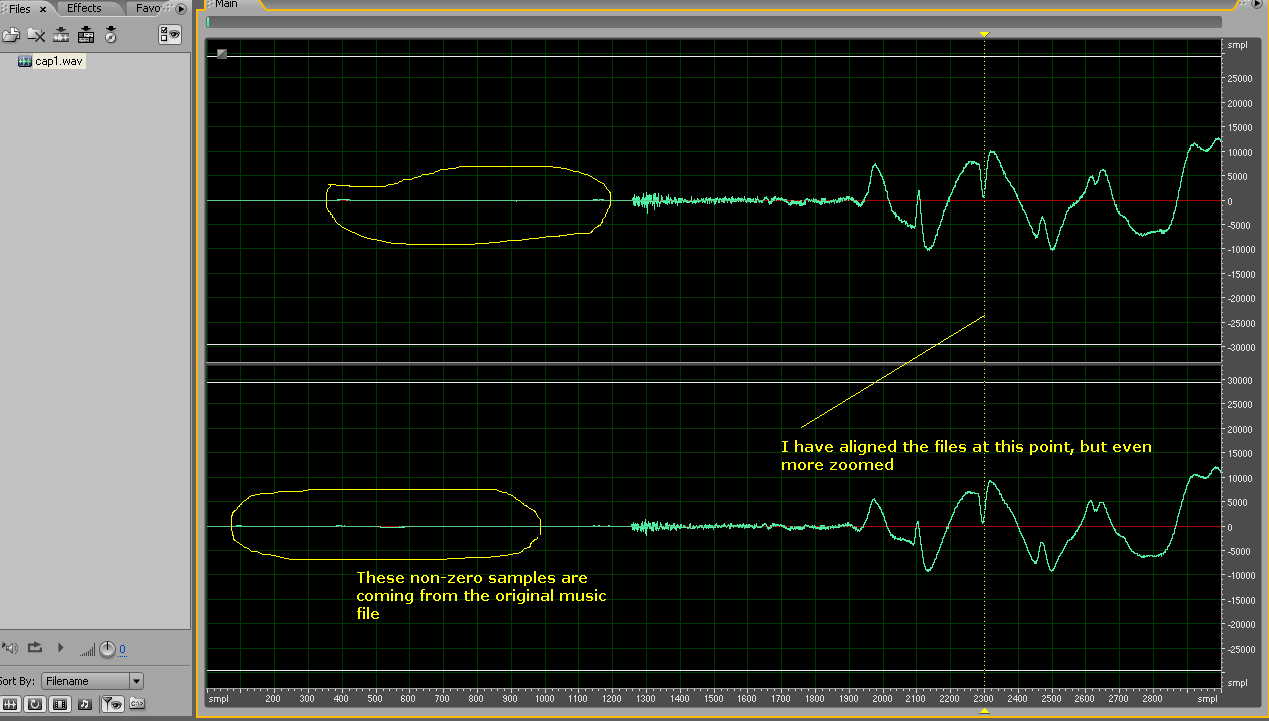

Pavel,
I have aligned the files according to image attached. In fact more zoomed and the point were I aligned them was sample no. 2296. I have deleted the blank space in each file, before the start of music, to always get this sample at 2296. The first non-zero and non-music samples come with the original data file.
Your capacitor-capacitor.wav FFT analysis is similar to mine. The 1/f LF noise is most probably because of decreasing impedance of the coupling capacitor at low frequencies and input resistance of the soundcard is not so effectively shunted then.
I did not know about that revealing option of foobar. So we have to appreciate your revelation, for the reason that someone else might use it as well to get his result.
The original post was deleted. What is the problem with ABX foobar plugin?
I was looking on the net and found this one: I found a way to reliably CHEAT in foobar2000's ABX utility... (this one can be easily fixed if one has plugin source code)
Is it there another way?
It's trivially easy to cheat the foobar ABX, which is why it's the wrong tool for this sort of test. The linked method works, but there's a far easier way.
foobar ABX is extremely useful for testing yourself. It has no ability to incorporate even the most basic controls for testing others unsupervised.
The image shown by Jay showed a possibility to assign statistical data of X and Y files in a pop-up chart window. Comparing to A and B one could tell which is which. Such is internet . I have not had an idea about this option.
