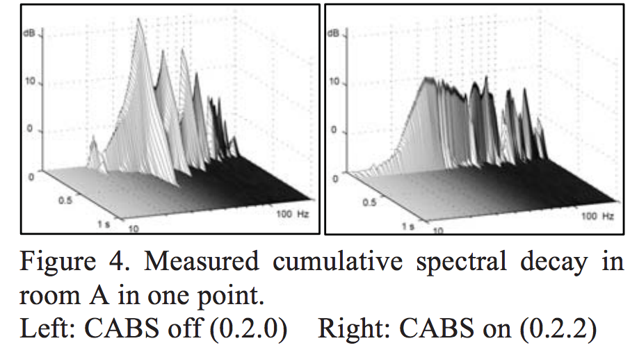

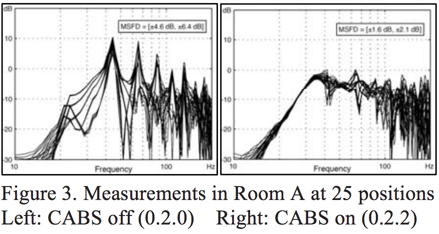

I'd like to have your comments about the CABS system as presented in this paper: http://vbn.aau.dk/files/62729209/LF_sound_field_control.pdf
I find what they have demonstrated to be a compelling argument for the DBA/CABS method. I have attached a couple of their graphs (these are MEASURED, not just simulated)
Here's what I see as the main takeaways from these measured response curves, and the overall implications of this paper:
1) The main room nodes aren't just smoothed out, they are eliminated. The attached curves show a MASSIVE reduction in room modes - as in near zero.
2) The positional SPL variations are almost completely eliminated throughout the room - see the attached charts. We're looking at +/- 1 dB over the great majority of locations on the rom - and as you pointed out, it's very, very hard to get that kind of response with just damping and tube traps. Near impossible in fact.
3) There is no need to EQ or average out or smooth out the frequency response with additional woofer locations, it is already near perfect.
4) CAPS also reduces the broad-band bass transmission into other rooms by 1.5dB to 5dB
5) The "complex impedance" differences in the lab walls (previously offered as an objection) don't look like they affect the measured performance by a whole lot - the variation of the in-room response looks to be very, very low - and if we read the paper, at least these walls were described as being relatively flimsy.
Overall, it looks very much like the DBA/CAPS arrays present a very compelling improvement over conventional damping and bass-traps.
Like Duke said, starting at +/-9dB and then achieving +/-3dB throughout the room is very hard to do with passive absorption methods...
And then when we look at the +/-1dB that the CAPS method shows, throughout the room...
I will let you draw your own conclusions, but it sure looks clear to me that the DBA/CAPS has some MAJOR performance advantages.

I was skeptical but that chart on the right is really convincing. (Not hard to make a single seat sound good, as on the left chart.)

Yeah, but... the measurements are showing the waves and phases are NOT doing that. The DBA/CABS acts like a unified planar wave moving through a tube, not like separate sources bouncing around....trouble digesting the concept of that kind of active treatment for a room with waves and phases bouncing around in near-infinite variety.
Hey Ben, I also found it difficult to intuitively grasp the notion that the output from the 4 driver main bass array (and the back one also) would NOT be bouncing around. I would have thought something more along the lines of a 16 driver front wall would be necessary...
However, the actual measurements show that for all intents and purposes, below the frequencies defined by the driver spacing, their output sums to a flat or planar wave. And the measurements they posted aren't sims, they are actual measurements in a real room, and one with flimsy walls at that! (Yes, flimsy walls with complex impedances)
