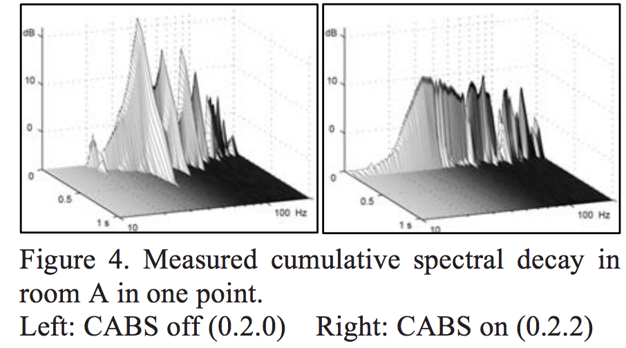

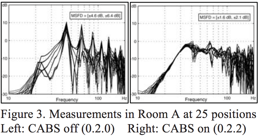

Here's a link to the CABS paper for rectangular rooms. This one is more useful to this discussion:
http://vbn.aau.dk/files/62729209/LF_sound_field_control.pdf

Not at all, in previous replies I think I've already mentioned (about 3X, in fact!!) that for critical applications the room still needs to be treated for the frequencies not covered by the DBA or CABS...
The fact that your room and decor and financial situation allows you to use massive amounts of damping material and bass-traps is great. Not everyone here has that kind of situation!
Also, this part of the discussion wasn't just about YOUR room, it was about whether active bass absorption can work instead of having to use huge bass traps...
I think the papers and research we have cited prove it, and we've established, beyond any reasonable doubt, that it can and DOES work.

It is in the range BELOW 100 Hz that the active bass cancellation systems like DBA/CABS work best, and provide a superior solution in rectangular rooms.
why superior?
weird that you now think with the limited amount of research on the DBA method that your able to be certain that DBA method works better then pressure based absorption and velocity based bass traps under 100hz. seriously, you jump to conclusion to support your biased view. I mean this respectfully.
2) Would you be willing to address ONLY the 100Hz and below issue? Are you STILL going to sit there and insist that even in rectangular rooms passive absorption just HAS to be better ?
I dont insist that its better to use absorption, simply that we still have very limited of comparison and information on DBA method.
