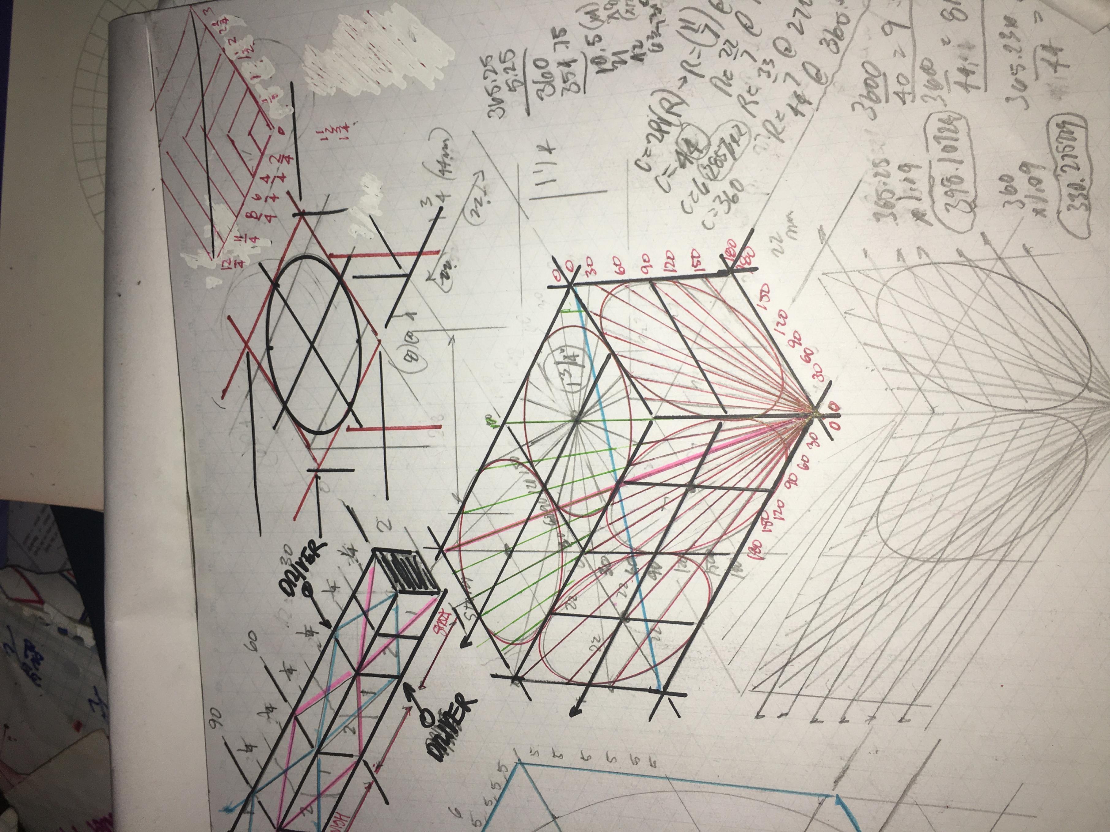

so true! If you drag this out as 3 on 1 compounded and drive it from each end at 1/3 and 1/9… you’re golden to whatever area the acoustical shape can’t help ? This straight off our very own time domain and planet. The secret is in a 33 x 33cm x33cm (think 33/7) cube that fits a sphere in it from the start at each end as 0.5236:1 including the exit ‘end ‘. ?

Isn't an array of spaced drivers an acoustical solution?
