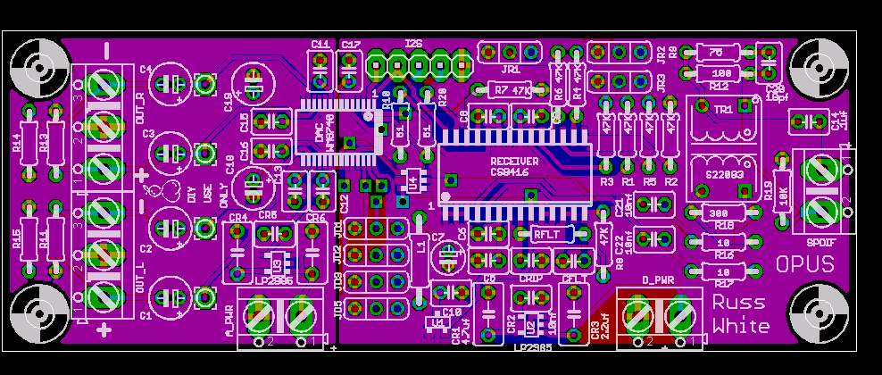

That is a nice pcb.
Please do not directly AC couple RXN to GND. AFAIK the reset circuit you have doubts about will do its work as it should.
Please reconsider the thought of the 3.3V and 5V regs on the pcb....
Russ White said:I adjusted some package sizes for the parts Brian has actually specked out. Thanks a ton for that hard work Brian.
Also adjusted a few cap values.
That is a nice pcb.

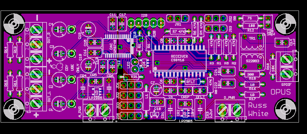

Mid weekend progress....
Ok guys (especially Jean-Paul) I hope this makes you happy.
Thanks Max, and the rest of you for you help too.
Notice the added optional VREGs(just jumper them if you don't need them) and the inverter for muting the DAC when there is a signal error. Also note the added small value resistors for the clock inputs.
Cheers!
Russ

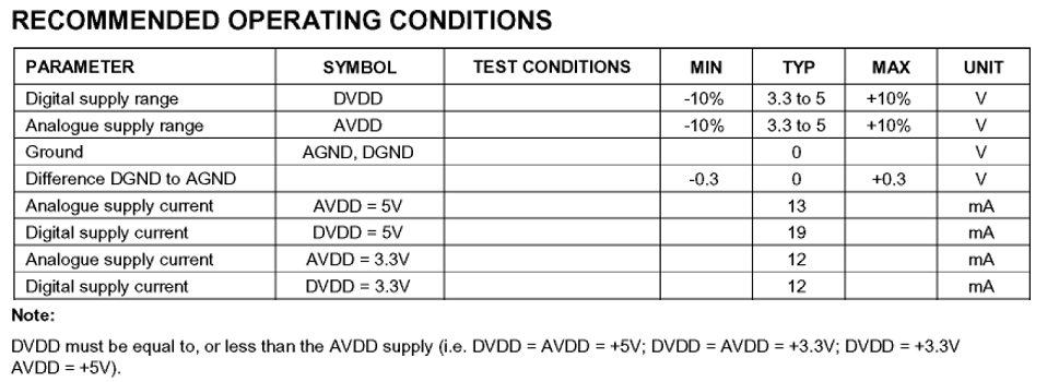

It seems I should connect the two ground planes. Maybe with a Ferrite/inductor and/or a small value resistor,
From WM8740 data sheet it appears that DGND and AGND must be at or very close to the same DC potential.
So whats the best way? A simple resistor/jumper? Or Ferrite/Inductor? Or maybe both....

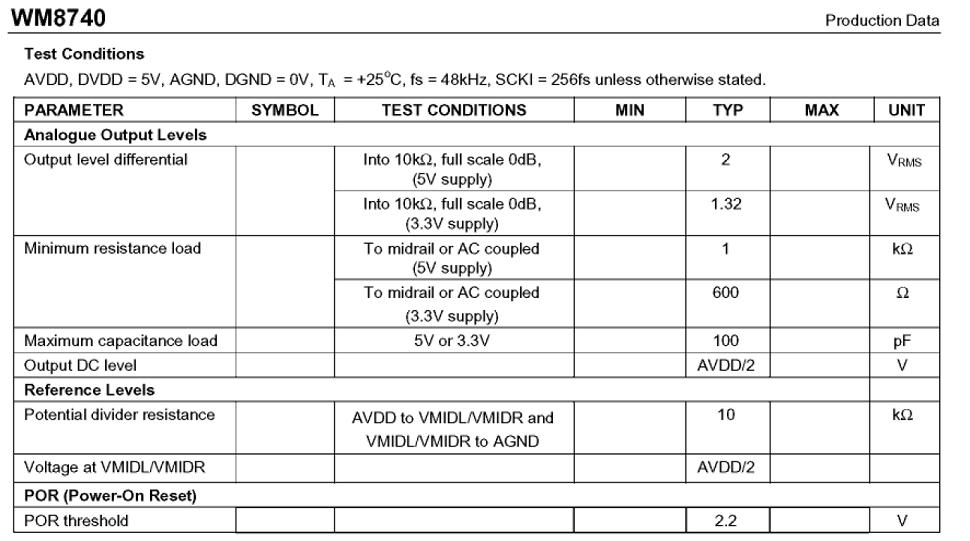

A note about the voltage output...
I have had a few questions regarding the output. The WM8740 data sheet says that it can drive a load as low as 1K, so if you have a good high impedance stage after the DAC, you should not need any buffer. Even on the evaluation board you can bypass the output op amp circuit which in that case is not really a buffer, but a filter circuit.
My planned chain is this:
DAC --> Joshua Tree attenuator(with about 4K worst case input impedance) -->Twisted Sibling balanced preamp (100K input impedance) --> Twisted X Overture balanced power amp(2.2K input impedance) --> various sundry speakers 4 and 8 ohm.
