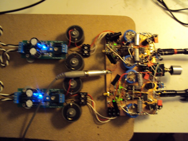

So whats up next ? As you know i am now investigating PSUs and made a decission to go with shunt regulators with CCS. The Salas Hypnotize sounds so far the best and that is only the most simple implementation. What it consistently brought was a more quiet stage ( soundstage and phonostage ) much deeper and controlled bass with a lot of "sock" and heft and much better transparency with a deeper and better focussed picture. I have also ideas how to adopt Salas regulators better to the needs of my stages but first i will try his sense-force technology buy building the V1.2.

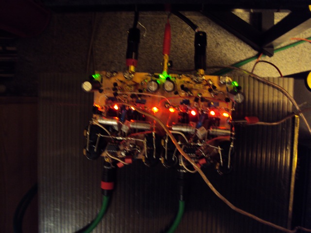

i promissed to bring my work into cronological order. First i studied Transimpedance MC input stages. They are usually build by using BJT transistors at the input in common base arangement, that means that the signal is coupled into the emitter of the BJT and not into the base as usual. This has advantages and disadvantages. Advantages are tremendoes speed ( a modern BJT in common base easily goes up to 5Mhz because the miller capacitance between base and collector is not amplified by the gain ) and a certain range of automatic gain matching because the gain of that stage is dependend on the impedance of the used MC cartridge. A cart with low impedance gets amplfied more and a cart with higher impedance that usually also has a higher voltage ouput gets amplified less. Usullay a Transimpedance stage is set up with a fixed ( low ) input impedance that makes experiments with loading unnecessary. The main disadvantage is, especially in a parallel symmetric circuit ( that i prefer beacuse of less noise and cancelation of second harmonic ) that considerable DC offset can be present in the cartridge because Ube voltage in NPN and PNP transistors is not similiar and considerable current flows though the emitters. A probelm can be radio demodulation and some carts do not sound right when connected to such a circuit because they sound overdamped. Usually a cartridge with low impedance is more happy with this circuit and i found no sound probblems with my collection of Lyra carts that have around 6 Ohm. Some designers claim less noise in such a circuit but i did not find that this is true in praxis and the literature sais that noise in a common base stage is the same then noise in a common emmitter stage provided the gain and the idlle current is the same. i looked over 6 month into improving circuits like that because i got good sound very quick. Usually the sound is dramatic, dynamic and very robust. Quite a shock when you are used to the typical IC Opamp input stage. I whould like to recommend two circuits for DIY. One is the Rosi and one is the Nobrainer i show here with and without the 75uSec timeconstant inplemented also in Transimpedance mode, thus converting a modulated current into a modulated voltage. The cuircuit use two different methods to avoid DC in the cart. The Rosi uses a floating supply so there is no current flowing in the ground and the Nobrainer uses Offset Cancelation with a trimmer. In the Nobarainer Offset has to be set with the cart connected or a similar resistor as dummy because before cancelation there is an emitter current flowing that produces an offset that is dependent on loading of the source resistor in this case the DC resistance of the used cart. I came up with a third method to cancel Offset that is even more elaborate but at that point my Fet stages had gotten so good in sound, also in terms of dynamic punsh that i saw no reason to walk that road any further. So here come the schematics. One little thing : Bias in the Nobbrainer is adjustable over a very wide range so you can experiment with different transistors and also you have some control over the input impedance. Raising the iddle current lowers the input impedance. You can also use several BJTs in parallel like in the Rosi. The output transistors in the Rosi are BC516/517 darlingtons for least distortion but you can use high Hfe transistors like BC550C/560C with very good results too.

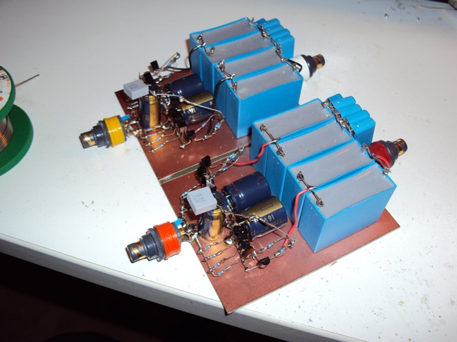

The Rosi is simply an adoption of the Rositter circuit shown in AudioXpress. I used better parts like RIFA polypropylen caps for coupling instead of elcaps and redesigned for easier to buy transistors. 2N4401/4403, BC550C,560C and 2SA1015,2SC1815 and a host of others work well. I use the Faulkner circuit for noise reduction and i put in emitter resistors for a degree of current feedback that helps matching. Those resistors are not absoutely necessary when you do not like them in the signal path. The Nobrainer is designed completely by me and Holger Barske will put the circuit on a PCB and present it in Klang&Ton. See my prototype on Holgers website.

Parallel to Transimpedance circuits i looked into Fet inputs and the 3 circuits i recommend are the MPP Frickelfest also known as the MPP Nova, the MPP Nova with Transimpedance RIAA and finally the MPP Tanskonductance-Transimpedance that is also use in modified Form in the L`Art du Son Phonostage.

Sam, this list will go on but as Rüdiger found, the Trasconductance-Transimpedance is the most recent design and has a very clean signal path and the best sound. Wait some days and i will show my latest open loop buffer that has not the problem of the overshot of the modified JLH buffer, is even a bit faster and can swing 70mA in class A. First prototypes put behind my Hoerwege Pioneer player gave such a boost in realism that i was seriously surprised. I am waiting for low noise voltage referesences and they should be there is some days. I will post a conceptual drawing in the next 30 minutes.

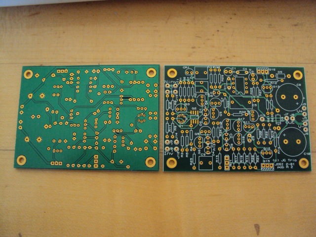

Now here comes the JG Open Loop Buffer. Ones i had the concept it worked in two hours but optimisation has taken me the best of two weeks.
