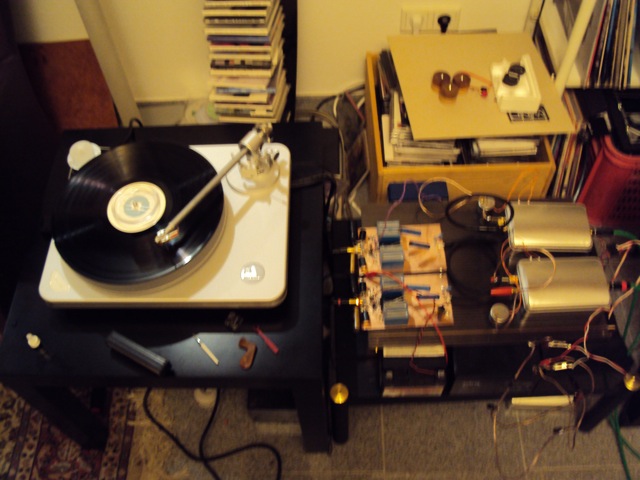

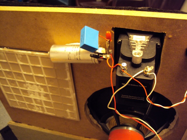

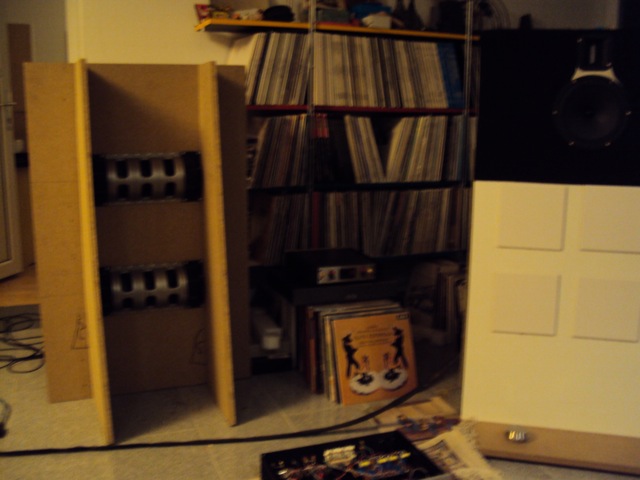

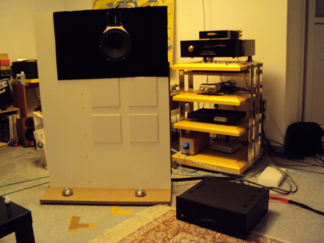

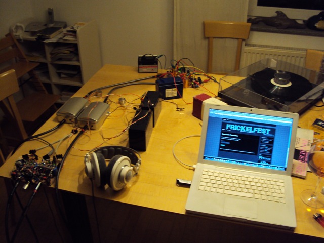

Today i listened a lot to music and started to decide what i bring to the Frickelfest. Sure, i bring my MPL with dipole subwoofer. I am now using MKV caps for the tweeter feed and they sound wounderfull. I also ordered some better coils from Mundorf but i am perfectly happy with my wax dipped self made air coils. Let´s see if the Mundorf coils bring an improvement.
I was planning to bring my JG-Self but i had some bad luck. I had just rewired the input to be able to switch between the Ina and the simple balanced stage. That is an interesting comparison. I still prefer the Ina slightly, it sounds a bit fuller and warmer without loss of detail. Then one clip of my batteries got loose and made a short circuit.
Everything broke down with a very loud cracking noise. Today i started repair but this is a complex beast and i still have some problems with offset.
So i connected my Ultra Low Noise Rosi to the Inductive RIAA and that into my High Speed Preamp. The result is fantastic. Very analog sound with a huge soundstage. As i already mentioned Inductive RIAAs seam to have the edge in midrange resolution. Somehow the energy center is shifted from the treble downwards to the midrange and that sounds very convincing on my system that is not shy in treble. Anyway, i have a good replacement and maybe i can repair the JG-Self and bring it too. Also today one of my LA Audio Tube Monoblocks stopped to work so i have to use the Beredsen Special Edition. A lot of colateral but that is normal when you do fundamental research like me with constant changes.
On another issue i had a long discussion yesterday night with Jürgen Hensler. I am building a Low Z Discrete Ina with Balanced Inductive RIAA at the moment and i need a lot of high value elcaps at the input. Jürgen sugested a transformer instead. First the idea was to use a 1:1 Transformer but after a lot of calculation we found that this is not easy if we want low impedance at the input for lowest noise and wide response in the bass. A 3.6 ohm winding would need over 100mH to reach down to 20Hz -3dB with a cartridge like the Titan i. After a lot of head scratching we found a 1 : 2 transformer could be done and we found a Lundahl model that could do the job. If we put the primary in series and the secondary in parallel we get 3.6 Ohm resistive impedance primary and slightly over 50 Ohm secondary. That has also the advantage that the Opamps in the INA need not to drive such high current that is necessary in the active version. Frequency response in the treble should be very wide with such a low voltage gain and the low impedances used. Theoretical the transformer could reach 500kHz -3dB but we expect more something like 250kHz -3dB.
I will post that circuit and pictures of my Frickelfest system later.
What i do not know is what turntable i will use. I am afraid my Spiral Grove could get some damage and my little Rega is not exactly what i would like to use eather. Maybe i ask Frank Schroeder for help.

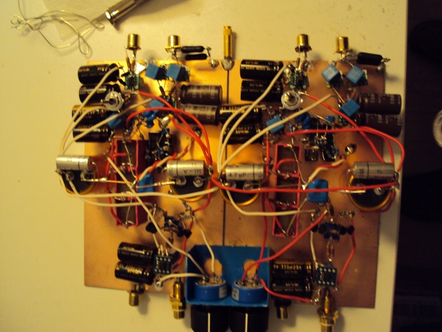

The JG-Self is working again. The output had substantial DC offset so i was asuming that the error was in the output stage. In fact the LME49713 opamps where faulty and i replaced them with LME49710 because i have no LME49713 spares. It works fine but i will substitude them for LME49713 in matal cans i expect to get next week. The LME 49710 sound different, a bit more nervous so i will replace them soon. Maybe the LME49713 sounds more solid because it can drive 100mA of current compared to the 25mA of the LME49710. Another explanation is that the transimpedance amp can drive my 2 5m interconnects with substantial capacitance more easily.
Today i had enough. The LME49710 in this amplication does not cut the mustard. I drive 2 5m long cables with this Preamp, one with a 10 Ohm resistor to the woofers and one with a 75 Ohm resistor to the tube amps. Maybe the LME49710 simply can not drive that. I took the LME49713 from the inductive RIAA and everything is fine. Much more relaxed sound. The LME49713 is really neaded in my system.

Today i had enough.
Well, so do I
Not even the opamp rollers fanatics ever dared to directly substitute a voltage feedback opamp (LME49710) with a current feedback opamp (LME49713) and then (assuming the thing is stable) claim a "more relaxed sound".
Speaking about stability, current feedback opamps are about the worst you can get to drive capacitive loads like long cables. There are enough high output current voltage feedback opamps that you can successfully use.
Really Joachim, this is a friendly environment, but at the trade shows you are participating you may encounter an engineer and the whole thing may blow in your (red) face. Not to mention your next sound reviewer potentially using a supa-dupa cable and, due to the capacitive loading, getting a horrible screech instead of a clean sound.
Good luck!
Hi folks ! Thank you that you care about my sound and even about my reputation.
A passive transimpedance RIAA could be done like you do Allen and Russ White of Twisted Pear has exactly done that in his Retro stage. What you loose is overload margin, not a big problem in your tube designs that have generous voltage swing i hope. I could be persuaded into a hybrid aproach with passive 75usec and the rest done active. Cancelation whould ocure more in the treble i guess. Even then you whould loose 14dB overload margin in the treble. I have done circuits like that and i must admit that they worked fine in practise. On the other hand, the latest Mark Levinson CD player has a fully differential anti alias filter and measurement look fine. The final circuit will not have that RIAA topology anyway. It has one inductor and one capacitor that is shared by the positive and nagative side. Actually it is so stupid simple that i first whould like to build it until i post it, so watch this space.
To SYN08 : The original circuit was designed around the LME49713 in mind. With a high enough feedback resistor i had no stabilty problems. The 10 Ohm output is for a headphone that the LME49713 can drive just fine with it´s 100mA current output. The LME49710 i substituted may have benefitted from a 75 Ohm resistor in that line too, but i did not try that because i wanted to ceep the headphone output. I have critisised other Opamps swappers of careless praxis without measurements and now i fall in the same trap. Thank´s for alerting me. I should not talk about the sound unless i am sure the circuit measures well or others ask me.
See the circuit i build. The quite high feedback resistor makes sure that the current feedback Opamp does not oscilate.
Hello Joachim,
Syn08 has beaten me to the punch , both the LME49713 and the LME49710 talk of being able to drive 100pf in their respective data sheets and I would say both opamps would have both as much difficulties driving 1nF directly without additional precautions, the +/-100ma current output capacity of the LME49713 does not mean it can drive a capacitive load any better than device that can only drive +/-26ma like the LME49710.

Pheonix, you are right, they need decoupling resistors to drive that load. Still, whenever i use the LME49713 as output chip, i prefer the result over other alternatives provided the circuit is stable. I use the LME49713 also in my High Speed Line Preamp with a BUF634
buffer in a feedback loop. With some compensation and an output Zobel i got a frequency response up to 25MHz -3dB. Squarewave response is clean and i am able to drive 2m long exotic cables without problem. I did not try longer cables though because the Line Pre is not far from my mono blocks. A big challenge was the volume control because potmeters in a standart arangement have high stray capacitance at very high frequencies so i designed a shunt volume and balance control. Here a compromise between input impedance and noise has to be found. An input buffer can be used if a source with a high output impedance is to be used like a CD player with a tube output stage. I also encountered problems with crosstalk in the balance control and i solved that satisfactory too. A major project that whould deseve it´s own thread but i am too busy at the moment.

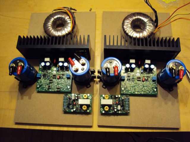

After some thought i did the basic layout. The hyper fast diodes are simply bolted to the cooling profile. They need some isolation though. The transformer is on the oposite side of the cooling profile to have it far away from the input.

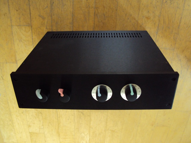

I am also building a case for the JG-Self. The photo is not that good but in reality it looks decent. I will add a mono switch and an input switch for CD. The volume controls are seperate with dials.
I have trouble uploading the photos. I will try later. Maybe i can make a better photo of the pre.
