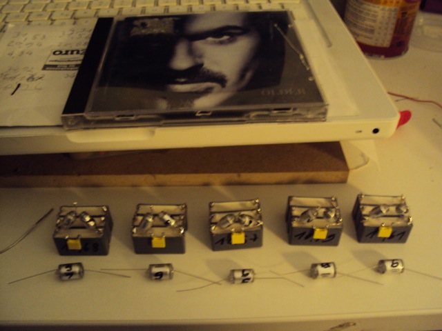

The next hours i spend building 5 ! pairs of precission caps for a super accurate RIAA encoder for a fellow DIY´r. He was so nice to me that i agreed but this work really neads a freak like me with good measurement equipment and a huge collection of precission parts. His goal was accuracy to 0.05% !
This is like a game of Chess, Domino and cracking the Roulette Bank the same time.
Anyway i got it done.
I will not do this anytime again soon so please do not bug me for precission parts.

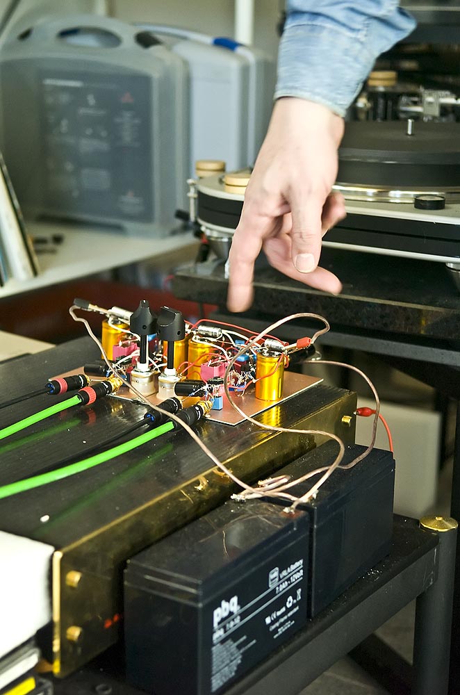

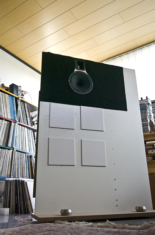

Been to Brilon today, visited Joachim, and had the chance to listen to his system. I was deeply impressed by the sound of the quite special setup with two way OB speakers plus OB subwoofer (have a look at Joachim's MPL thread for more on the spaekers).
Of course this was fed with vinyl: TT from Alan Perkins, Lyra Titan cartridge and Joachim's "JG Self" phonostage. The sound is... well, a slap in the face. Unbelieveable open, dynamic, fast, and detailed. Somewhat remindes me of horns, but completely lacking coloration. Nothing for those high end listeners, who want it nice, gentle and pleasant - this one really bites you.
Great stuff, Joachim, hope to get a more intense impression at the Frickelfest.

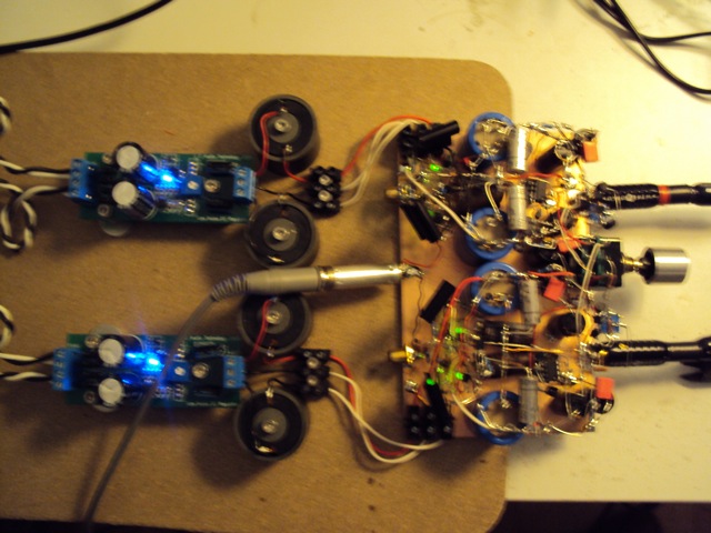

I started to work on my masterpiece.
A fully balanced, parallel symmetric Phonostage with balanced inductive RIAA.
The input stage is working and i get the rest of the components this week.
Hope to have it working on the weekend.
I will come to the Frickelfest. I hope to have my poweramp ready until then although i could feed that MPL with my preamp.

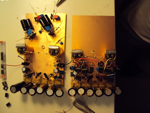

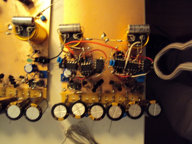

I am working on the Balanced-In, Balanced-Out, Instrumentation, Inductive RIAA for several days now. It is quite a complex beast and much more delicate work than i thought. For my own use i am building a Low Z version because i simply like the slam and drahma circuits like that provide. The input stage of one channel is ready. I have not closed the feedback loop yet. I wait unil tomorrow and will chek everythig double.
I hate to see smoke or OPamps with red ears. I will post some photos later and will stop to build today. I need a rest.
P.S.: I am looking forward to see you Heinz. I hope to bring a complete DIY system.
What is still missing is a poweramp. I am collecting ideas. Maybe something single ended Cass A or let´s see what Brianco is getting together.
It´s a novel topology with advantages i hope. Needs only one coil for balanced.
I will publish the circuit when it works. To do this with tubes whould be imposible but i use this "dead bug" groudplane style all the time now. No problem with hum and easy to change and repair.

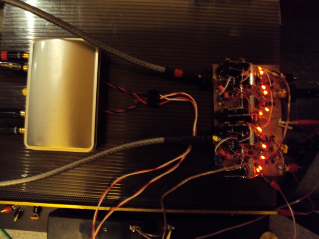

I am just building the latest version of the High Z MPP with transimpedance 75usec and capacitive RIAA to make the listening test. I will build that in a proper cabinet.
Dear Salas, i am still not finished with your Shunt but i have all parts now.
Resistor swapping
Today i did the first round of listening to loading resistors. I am using the latest version of the High Z MPP Transimpedance, Capacitive RIAA. The culmination of 1 year of hard work. It sounds just w........
Picture and circuit included. I use a current and voltage buffer to drive my 5m long cable to my high speed ( 25MHz -3dB) reference preamp. I use my MPL speakers.
The reference resistor is a Dale NS-2B 300 Ohm wirewound. That resistor sounds better then a 1kOhm TX2352 naked foil in my system but i will try a 300 Ohm naked foil tomorrow. So let the cat out of the sack as we say here. The resistor i listened to for comparison is a Dale Mil.Spec. RS65E i got from Simon.
i comfortably trampled the NS-2B. The soundfield with this resistor is much more populated in the midle and tonality is much more homogenious like listening to a full range speaker. There is no doubt any more what kind of instrument is playing. a Flugelhorn is a Flugelhorn and not a trumpet. Distortion is subjectively very low. I know that beacause i can play louder as usual without my right ear starts to distort. Distortion always starts in my right ear first. I think i have to go to the doctor to blow some dirt out. I did that ones and the gain in sound quality was amasing. Voices are magically 3 dimensionally delineated. This resistor is highly recommended and not so expensive. Ceveat : It is BIG. It has a 1/2 watt military rating but it looks more like a 2 watt.
