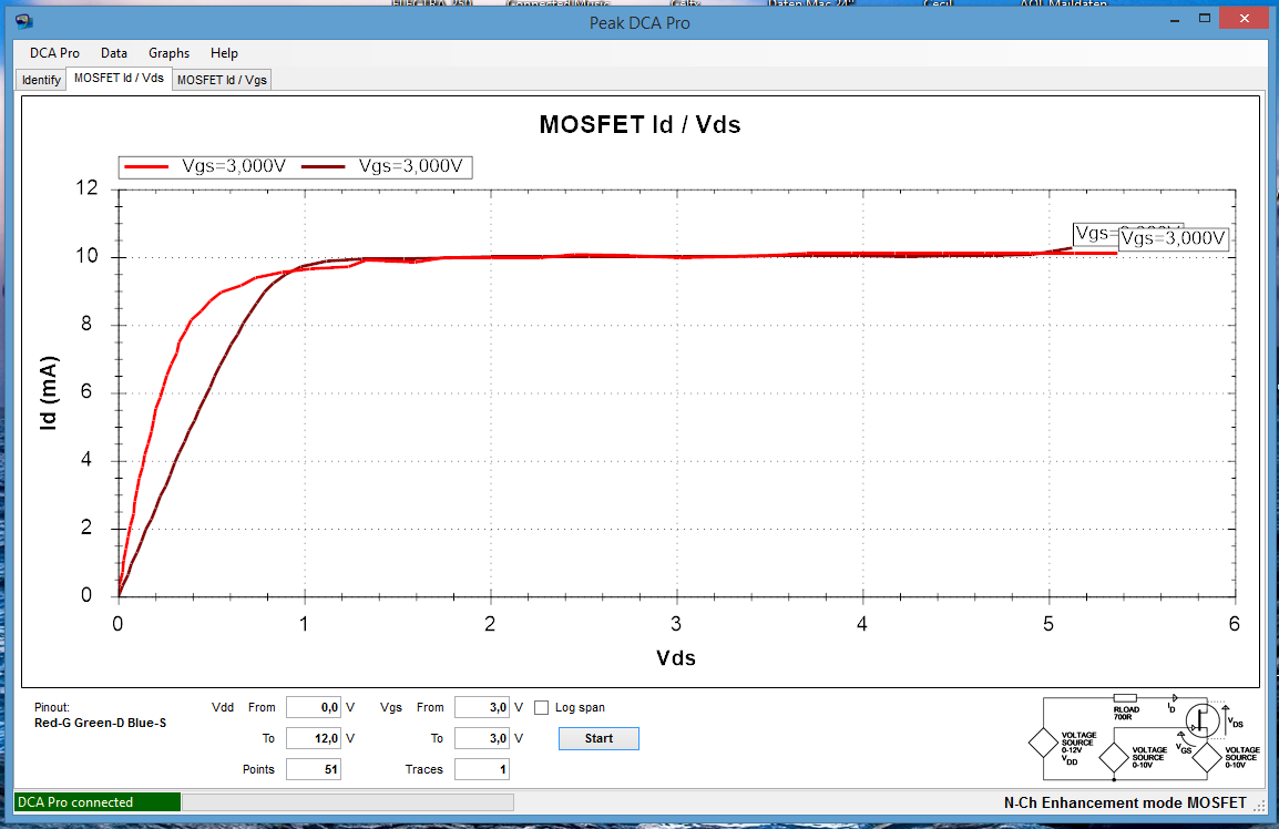

I am working with my curve tracer to find out how i can make a symmetric N-P channel MosFet pair.
Glad i did. Found a strange kink in the first N-Channel i picked random.
The second sample was fine. Maybe it was fried by static charge.
Be carefull when you use them.
See the overlay of one P-channel and two N-channels. one was faulty.
