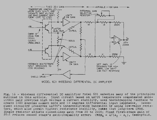

INA163 that works fine but the necessary gain resistor in the intrumentation amp reduces the noise performance to something like 1.4nVQHz.
You can take this idea down to .6nV with 2XMAT-02 and appropriate feedback resistors. You can extract the values if you do a noise analysis on the Earthworks preamp assuming the classic in-amp architecture. The date on that BTW 1968

I have already answered why I use a bipolar/tube cascode in the RTP phono stage.
The First RTP (~1982) was all tube, and 1/ needed very carefully selected tubes and 2/ very high gain in the line stage (30dB) to have enough gain overall to handle low output MCs.
Later RTP's used a jfet (2SK147)/tube cascode in the front end, which solved the noise issue completely, and increased the phono gain significantly so the line stage could come down in gain to better match CD player outputs.
But this still didn't give enough gain for really low output MCs, so I tried a MAT02 bipolar under the tube, and gained an extra 10dB gain just in the phono stage, and IMO, even better definition.
Clear now? Any more niggles "I haven't confronted"?
