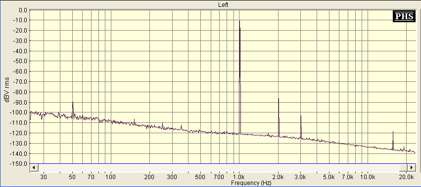

From a 56dB gain 1 jfet input build non cascode, just Rload drain, I got this for noise floor ref 0dBV=1V out. I used a 1/200 10k series 50R parallel attenuator to obtain 0.5mV from 100mV Emu Tracker Pre usb box generator and I put the phono in its loop. Without Lpad, gen's output is rather noisy under 500mV and can't be controlled precisely under 50mV for asked output. That high frequency blip is an artifact, most of the times isn't there. Is this noise floor result possibly fake?
P.S. I found the output impedance of the card at 580 Ohm when I calibrated the levels for different loads.
Not sure how your attenuator is built, but for noise measurement purposes you'd better repeat the measurement with the input shorted to ground. The generator and the attenuator may add much more noise than the pre itself.
