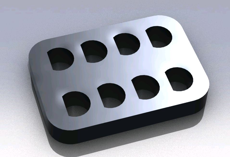

Hi Michael,
yes thats true, in my small test I measured output DC voltage with no servo inserted, and blowing on the input transistors made the offset change by maybe 100mV or so, went down again to steady state just as quickly with no overshoot or similar.
My conclusion is that the servo is more than capable to handle that, and it is best to have a closed cabinet in order to prevent any airflow around the input stage. Maybe even putting a small cover on top of those transistors....
No cover! It will accumulate heat and you will have a high risk of overheating (even on devices that seem to be cold (have an environment bound temperature)).
Think that would be hard to implement.. at tuning would require distortion analyser...so for a practical unit...we must assume that the cartridge makers know how to do their work..
regarding cover Iam thinkin in therms of a small aluminium lid glued on top of the 8 input transistors...call it cooling or temperature stabilization
Think that would be hard to implement.. at tuning would require distortion analysee...so for a practical unit...we must assume that the cartridge makers know how to do their work..
I agree on the heat accumulating. It will also eventually take days to stabilize thermally.... EUVL (over in the Pass Labs forum) has used a heatsink with holes for TO92 devices with great success, it is shown on the cover of the latest of Jan Diddens "Linear Audio". Maybe we just want to create a aluminum plate with corresponding holes, and then put a regular heatsink on top?
If someone send me a exact measured Footprint of theMaybe even putting a small cover on top of those transistors....
Q's in question, (means their position to each other)
i'll see wat i can do on that.
Copper ?
Something like this:
....but with multiple holes.
