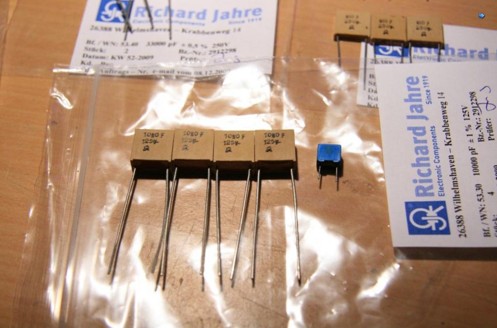

I have talked to Jahre and i got some interesting answers. I wanted to know what the smallest case is with 1% precision for RIAA use. It is case 53.
Here are the dimensions :
6,8nF 125V 12,7 x 12,5 x 3,4 10.2mm between wires Case 53.10
13,6nF 125V 12,7 x 12.5 x 5,3 10.2mm between wires Case 53.20
40,6nF 125V 22 x 12.2 x 10,4 20mm between wires Case 53.50
i get a price quote soon
