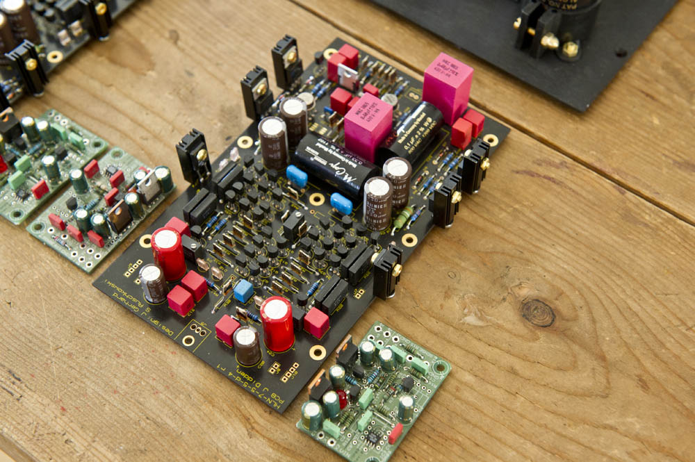

That is the Opus Magnum. I build them by hand after the specifications of the customer.
This one goes to Bangkok and the customer is a mechanical engineer that totally rebuild his Goldmund Reference including the arm. He had collected parts over the last 10 years and wanted to put them into use, so he send me Black Gates, Bulk Foils, etc.
Even the trimmers are Bulk Foils, 50,-$ a pop. The rectifier bridges are IXIS Silicon-Carbite, 90,-¢ per piece. The snubbers are REL-Cap Teflon. The common mode coils are
Lundahl ( 250,-€ a piece ), the PSU caps Slit Foils. I chose the Mundorfs because i am very friendly with those guys and can pick the stuff up, selected for me directly at the headquarters.

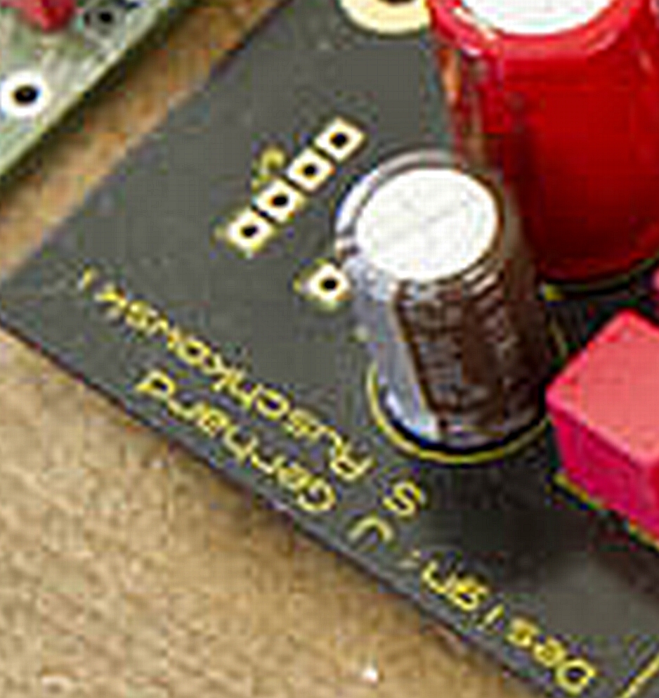

you had better give me some credit for this design as I and you co-designed this MCRI
Joachim,
you had better give me some credit for this design as I and you co-designed this MCRIAA amplifier. The regulator is my design.
Attached is an enalargement of the photo of the design.
Jan Didden did the PCB layout with me as reviewer, and Jan should get credit for the excellent PCB design.

Joachim,

I am pretty certain that these acknowledgements were given by Joachim some time ago.
It was a great honor for me to work with you and Jan on this complicated project. You always supported me.
Thanks Joachim. I remember burning a lot of midnight oil going up and down to Sigurd to figure out the sizes of these special caps and resistors and how to get them all placed with shortest tracks, lowest parasitic C and as much star grounding as possible and a few other 'non-negotiable' specs. It's nice to see the result in Holgers picture. Maybe I should twist your arm to get some boards for my own
jan
Yes, Sigurd and i can be a pain in the b..., actually it is more me. Sigurd is the perfect gentleman.
The result is phenomenal though.
