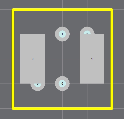

here you go guys, a footprint that will accept LCR caps, both WIMA and Roederstein RM5, and also the RIFA SMD Caps..... eats up a lot of space though, need to rearrange some components....
love you too ;-)))

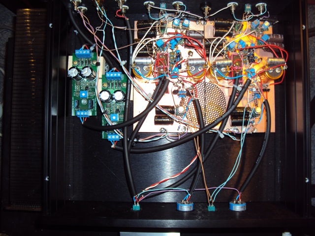

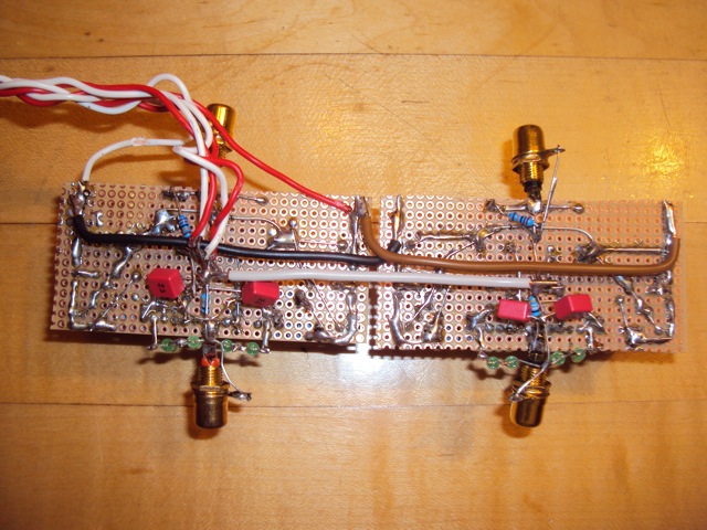

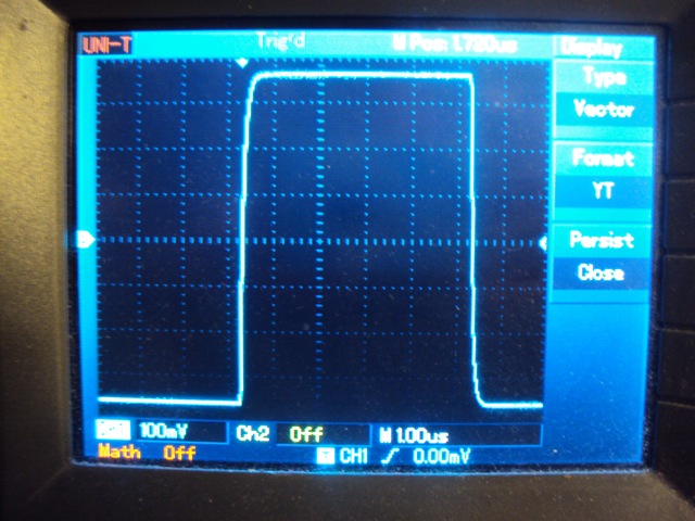

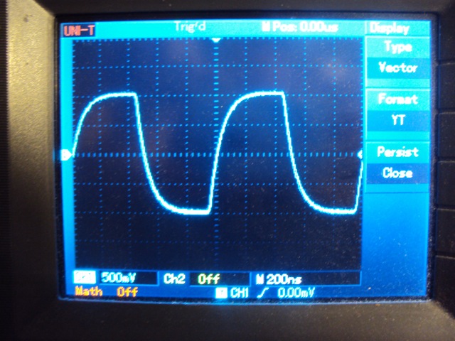

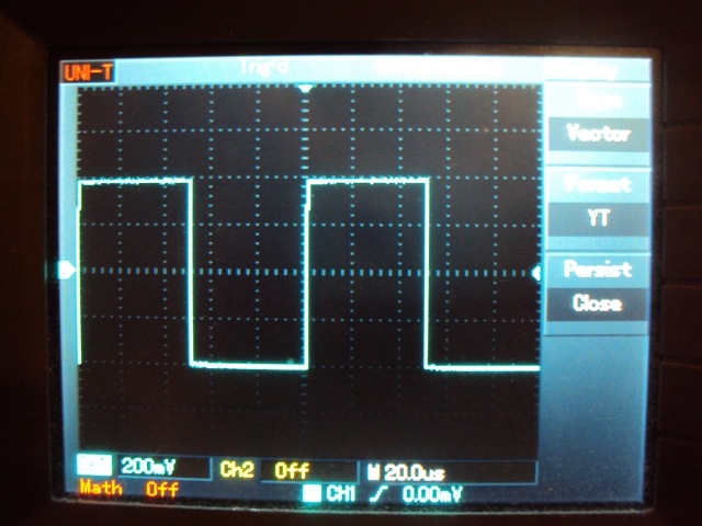

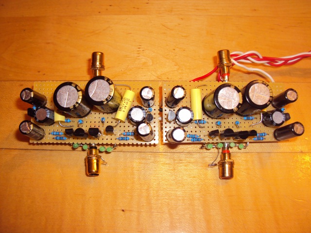

I was curious how good the Sanyo transistors are so i build a little pre-pre that uses a simplified version of the Paradise input stage. I will listen to it tomorrow because the family is in bed. I measured it though.

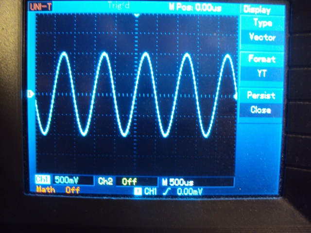

The circuit has very good speed. With a gain of 23x i got a -3dB point of 4.3Mhz with a little underdamped overshot. So G/BW is nearly 100MHz. I build in a 6dB filter to limit the response to 1.7MHz. The screen shots are with this filter. The 10kHz square is just a square. CD players can only dream about this performance. That does not say that vinyl per se has no problems with extended range but this Pre-Pre will not limit the input signal. The 100kHz square is nicely rounded after modification and the 1MHz square shows the slew rate with 10V per usec. That is very fast for a low level input stage.
The sine wave shows the response to a 87mV signal, my limit because i use a voltage divider. Theoretically it can throw 12V P-P so this is not the limit of performance. This stage is hard to override. Even an MM can not overdrive it and this is with only 6V over the cascodes. The Paradise is 6dB better because we use 12V. I tried to measure noise but the resolution of my scope is too poor. With a low noise circuit like that i always get around 0.5mV, no matter what it performs in reality. There are some high frequency spikes and hum but this is naked on my bench.
The listening will reveal how the noise spectrum sounds.

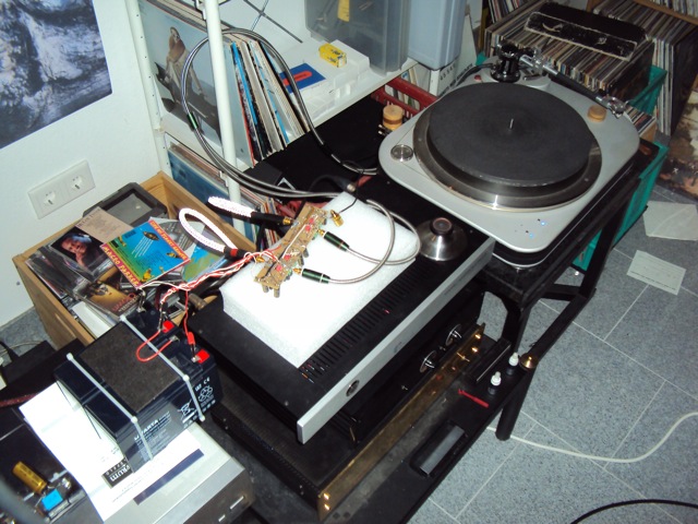

The pre-pre is now in the system. As MM stage i use the JGSelf precision RIIA.
The good news is that the circuit is very quiet. At very high levels on my 98dB sensitive speakers it is hard to distinguish from the back round noise. Fully cranked, ear at speakers the noise sounds very soft and even. No flicker noise, no popcorn noise, very low 1/F break point ( low noise in the bass ) so this Sanyos are very good.
The sound i get is very transparent and has high speed. For something so simple i am surprised. It looked good on the scope though. So this is a proof of concept of the Paradise input stage.

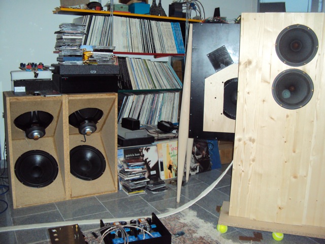

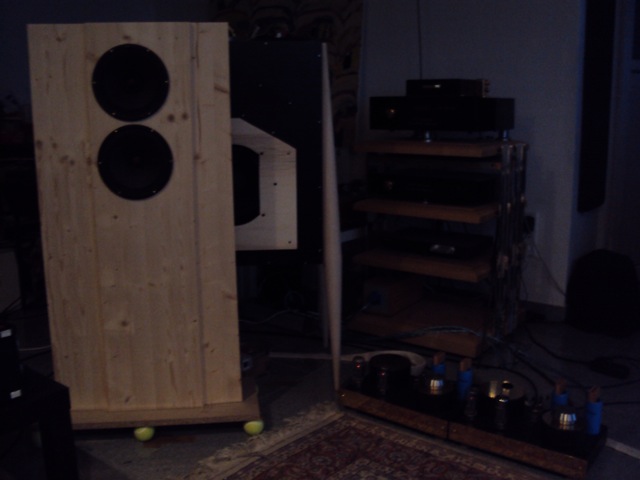

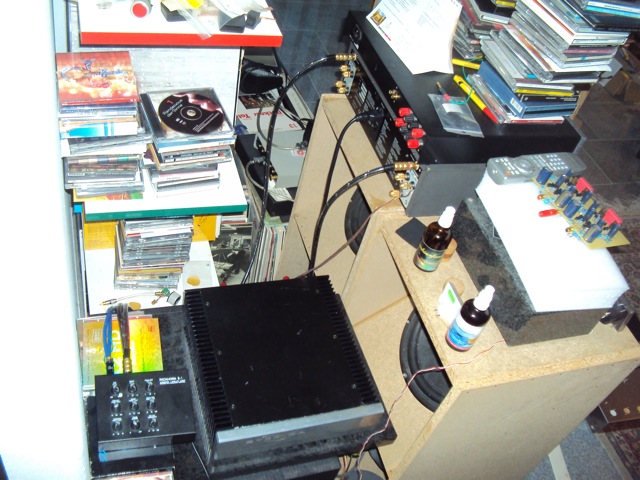

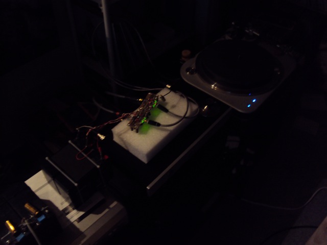

See some pictures of my current system.
