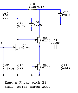

I just had a strange idea for a DC coupled version. Kind of Hiraga pre-pre, Pass B1. It´s an ALFA, so do not build it yet.
Not that strange. Kent is the guy with the tripod steampunk speakers on Burning Amp's photos BTW. Well, those are really strange.

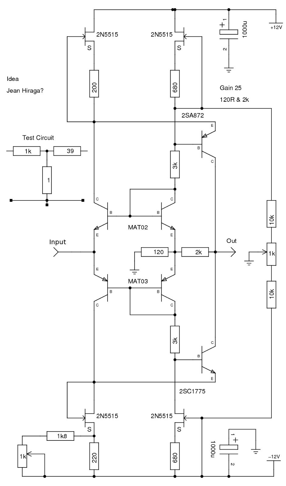

tvi, that circuit is from Rambeyrolles also published in L`Audiophile. It was the first folded cascode that i have seen in audio. Unfortunately the 120 feedback resistor does make more noise then necessary and the MAT02/03 combination is no good for lowest distortion and symmetry because of very different Hfe. The PNP has very little. I stumbled upon that stone also in the beginning of my adventure. Anyway, it did inspire me. it´s a visionary circuit. The 120 Ohm could be much lower if you use stronger transistors for the cascodes. Something like BC140/160. If that problems are solved it should sound very well.
