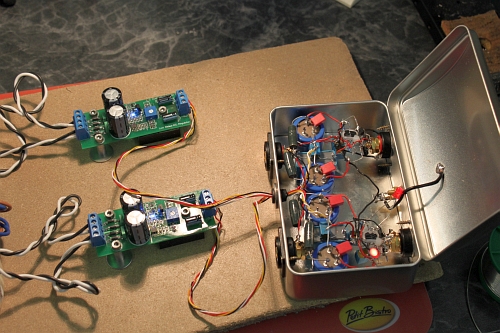

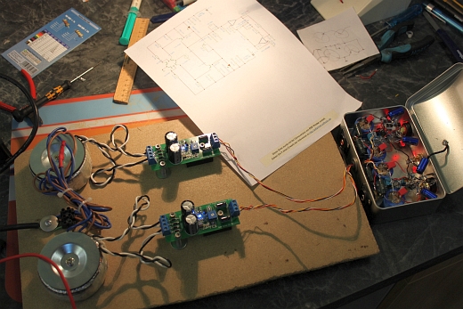

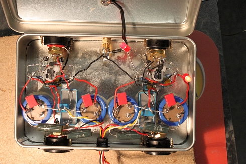

today i iserted LEDs instead of the 220 Ohm bias resistors (until now without low pass).
i measured 1.9V across the 220 Ohm resistors so i choose red LEDs that light up at 1.7V.
one very positive result was that DC offset came down from over 100mV to under 15mV, so i am shure, that after trimmimg the input stage i can DC couple to the servoed second stage. tomorrow i will add the low pass and look at PSSR.

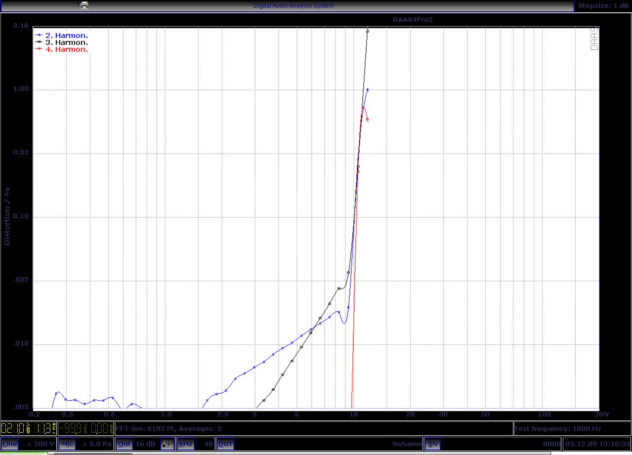

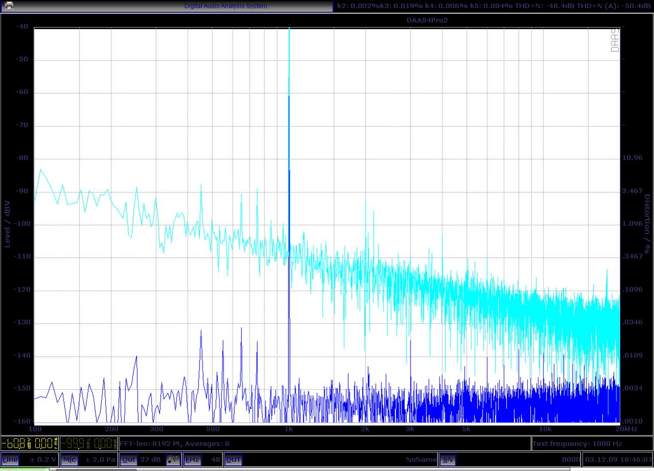

yesterday i have finished the LED bias version of the MPP and must say that i am very pleased with the result. bias in the cascode stage is now very stable and similiar in both channels. i got 10dB less noise (sorry, no 30dB improvement, regulation was already to good) under 1kHz now lying at -130dB and less hum. a added two pot meters for DC bias trimming. i got it better then +-5mV and quite stable so DC coupling to the RIAA stage is possible. later i substituted the pots with fixed resistors. distortion is now under -110dB at 50mV out, mostly second harmonic. one channel did 4dB better in second and a bit worse in third, being also some 0.4dB louder. that can be zerroed in with R1 and R3 but i left it that way. i will post the measurements of both channels paisted on top of each other and also a look at the physical circuitry. i think the circuit can not be improved much any more without bigger topological changes. bias to the input stage could be anhanced with constant current sources and improved current mirrors but regulation and stability is already very good. the bases of the cascode transistors could be tied to the current mirror of the input stage but i like my design better because it allows for independent optimisation. i would call that the definitive DIY version now. it uses no exotic parts not counting the input transistors that can be substituted with other typed i have described here. i will give it a listen today and also build the matchng RIAA stage.
i also like to tell you about the noise performance. noise density is around 0.5nVqHz comparable with a ca.12Ohm resistor and some 6dB better then a low noise OPA. it can be improved by 3dB if you shunt the current mirrors with a 2200uF capacitor. i would recommend Pannasonic FM or Rubicom ZLH for maximum dynamics and resolution or Nichicon Muse or Elna Silmic for a somewhat rounder tone. other mothers have nice daughters too, so there is a dazzling choice of other subtitudes and i have not tried everything. this is one of the nice things with DIY, you can choose your own components.

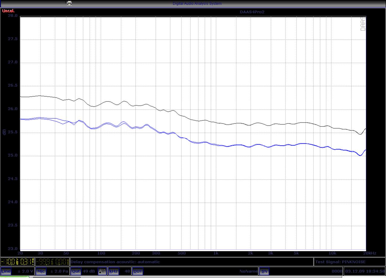

here come some measurements that i did today. first is RIAA curve. the shape of the RIAA curve is absolutely similar on all channels accurate to +- 0.3dB with a slightly falling characteristic the way i like it. my Titan has about 2dB gain on top of 8kHz so in my system there will be no shortage of treble for greater accuracy the circuit can be easily tuned. it is just 2 capacitors and two resistors. 1% accurate parts are sufficient because modern parts have often better tolerance then advertised. as i said one channel is 0.4 dB louder but the shape of the RIAA is absolutely the same. no problem in my sytem because it "hangs" a bit to the left because of slightly asymetric acoustics. i used to control that with the balance knob and the MPP had good symmetry of the soundstage in my system. anyway, gain can be trimmed the way i was talking about. the Neumann constant can be added with a 15 Ohm resistor in series with the 0.22uF RIAA cap. i am not a big fan of that and there is an interesting survey of that issue on the Stereophile website. Keith Howard has looked in that glas much deeper then me. overload was at 12V RMS (33,6V P-P) with +-15 V on the opamps and +-13V on the input stage.
