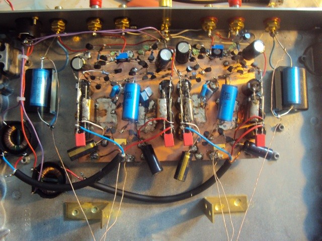

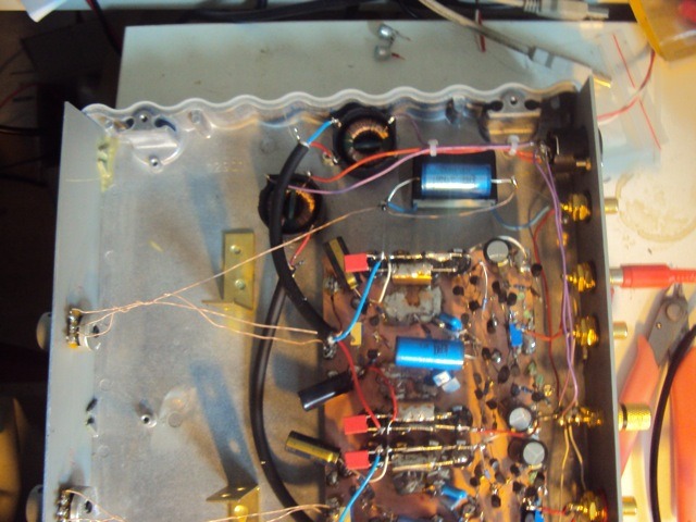

As a proof of concept i rebuild an older stage to recent specs. It did not make all modifications. The current mirror got helper transistors but still is a cascode mirror and not an enhanced Wilson. The cascode mirror does not use feedback so has a bit more distortion but the same output impedance. This stage has only 2 plus 2 2SK170, 2SJ74. That is sufficient if you want to safe some P-Channels. It does not use the servo i proposed. The input stage is AC coupled to the buffer. I measured DC offset before the buffer and it floats around plus - minus 1V.

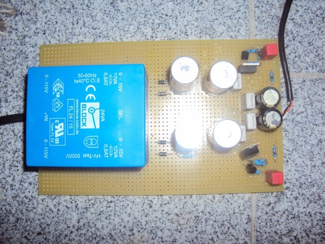

The buffer is still my older improved JLH design. I build a quite simple but i hope effective PSU. It uses LM317-337 with R-C pre regulation and Duttmanns enhancement trick. Inside the phone i use separate common mode coils and again onboard R-C filters.
I will fire it up now and will do a listening session.
I will post some photos and schematic later.
