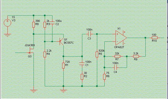

*Schematically lets see Werner's folded cell for instance I redraw to show. 1.7mA in this one available to drive the passive part (low time constant). A bit more, can go 2-3mA depends on gain target, PSU etc. But what runs through Q1 is much more and could be available with a telescopic cascode. Losing PSRR VS folded, but getting it back if with CCS mirror load.

A direct folded cascode like Werners has too little drive voltage to steer an AIOG RIAA with good overload margin.
That may be the reason he only does the 75usec part that way and does the rest in the second stage. The Summer 2011 MPP could be done as a too stage too. See the schematic.
But i decided on a one stage approach.
  • MPP Summer 2011 FET 2 Stage.TSC - TINA.pdf
Another thing I have seen with split Riaa and active high part in OP Fb loop is its very very much exact values sensitive when enough gain is allocated (normally). Difficult not to have bumps and valleys in an average parts selection build for tolerance and no FR FFT check, good LCR for matching etc.
