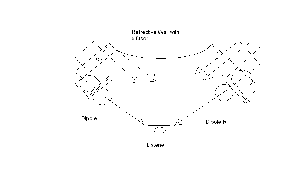

Another idea i had a long time ago is to use Phantom Sources to "Flood" the room more homogeniously. Actually i have a patent on the use of Phantom Sources. The solution i show here was presented to Rick Beveridge, the son of Beveridge and he told me that this is the first innovative roomdrive he has seen since his father died. The difuser is not neccesarry. I build it and it works fine. I have another solution i build with electrostats that is even more surprising. People that listened to it where quite shocked and could not understand what was going on but i remain silent on that until i can show it in public.

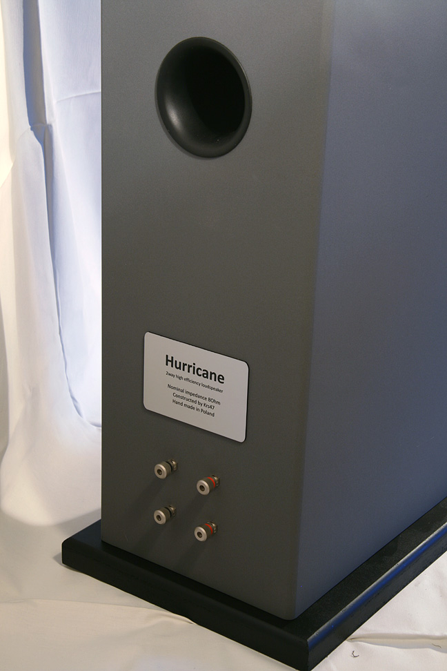

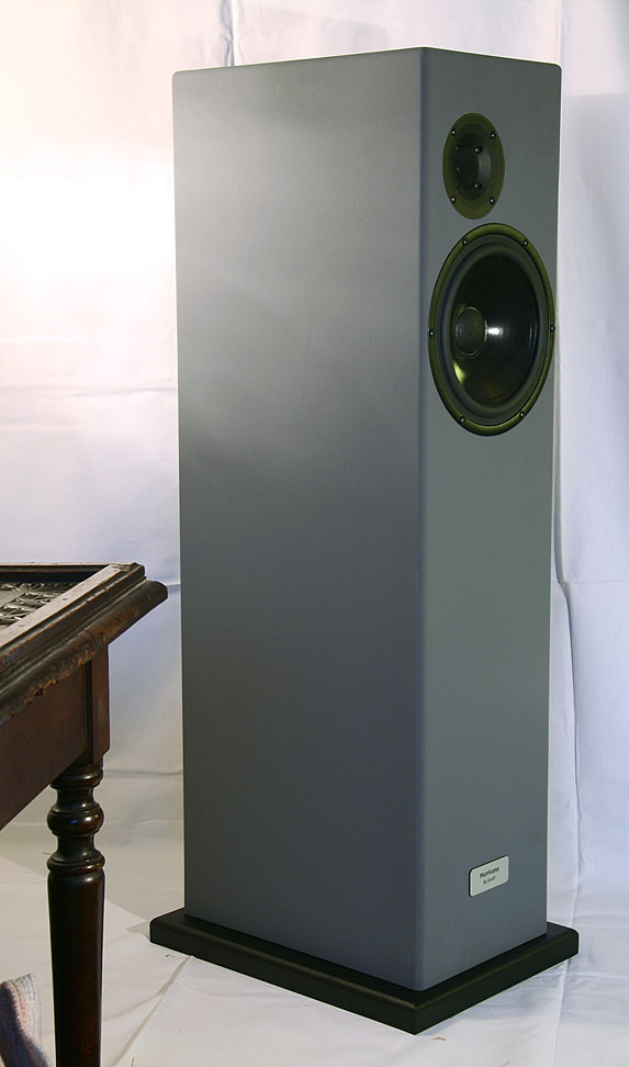

DXT increase directivity to match bigger woofers like CA22RNY. Both gives very nice and clear sound even above 90dB. I only listened in near field as my friend Christopher already made a pair (see below picture of "Hurricane").
I've been to Manger house three years ago. Herr Manger uses bipole radiation with his Zerobox+Sidekick. Sound perspective was stable in the room and SPL limited. We had very nice conversation.
If we look for a universal loudspeaker that will satisfy both camps then it's simple to install rear waveguide plus ground woofer. With bipolar you can make a switch and decide how much your room would you like to hear. With horns phantom image collapses very quickly if you move head - I hope CD waveguide is much better.
very interesting, the system with convex reflector looks a lot like JBL Paragon

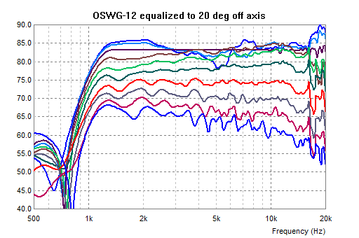

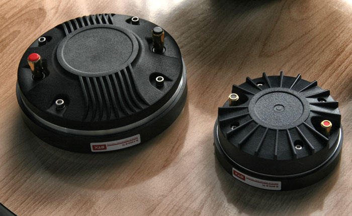

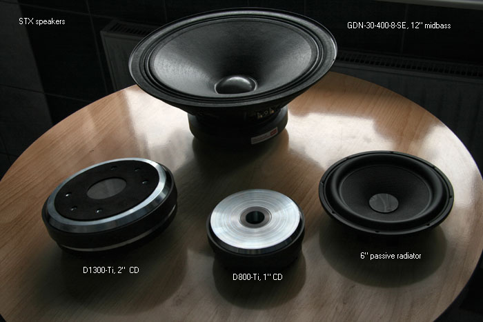

I use cost effective Polish 1 inch STX D800-Ti and D1300-Ti (2"). I wish to have modern compression driver with naked phase plug, without duct that resonate with waveguides. OSWG when equalized to let say 20 deg has nice pattern. We can smooth on axis response with larger roundover.
