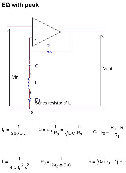

Re: Inductors and EQ
but with a C=1nF, L will be .24H.
Nongyr eq can work very well. In this case we need only 2 or maybe 4 inductors, what can be interesting design.
Inductors are little bit expensive, but to me one old eq with inductors sounds better than those with gyrators.
regards
JensRasmussen said:Well you can use inductors, BUT in the case above you would need one wopping 2.4 [H] ! I think that is inpractical for most people?
regards
it is possible to wound any inductor for audio filter in ferrite body like on picture. (from conrad, one complete inductor will cost ca 10€). I think that we need only one or two eq in active filter with gentle correction (not higher than 6-12dB). Everything more means that speaker or something else is maybe faulty. To many eq's in filter will tend to destroy sound, IMHO. I will make some experiments with inductor based eq (with discrete opamp) for middle decade (from ca 500Hz to ca 5kHz) in next few weeks. Results will be published here.
Regards
PS
In 2/2004 hobby-hifi magazine (German) someone can find good article about active-passive crossovers and derivates.
Regards
PS

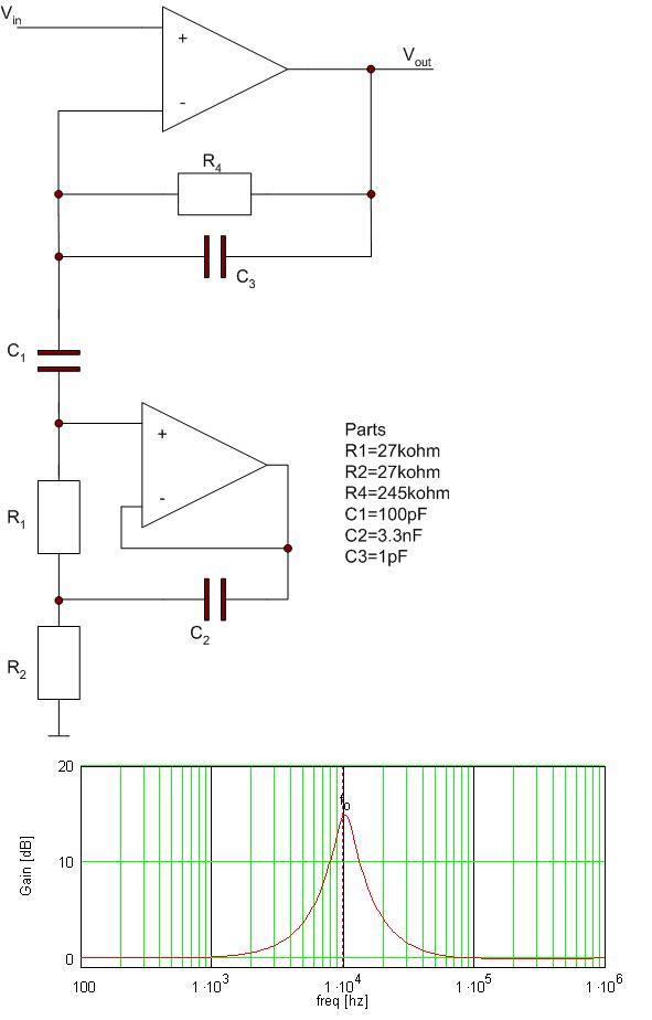

To promitheus
Just a note before you go and calculate alot on the EQ section for your filter.
You can NOT use the formulas for BP and BS filters for your EQ and get valid results.
An EQ section is NOT the same!
This means that the BW=fo/Q equation does not hold.
It's bettet to draw the grafs and see what you get.
\Jens
\Jens
