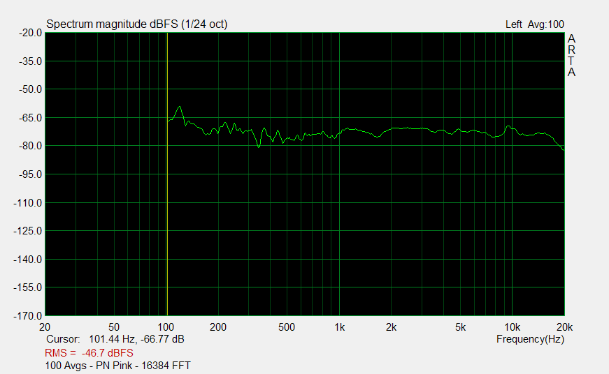

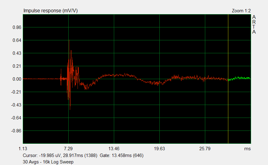

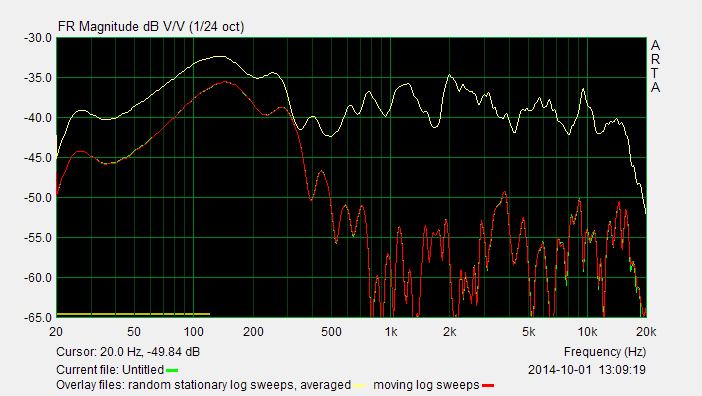

I'm not sure I understand what the different people are pondering over the past few pages here, but these are what happens when I do what I assume is the original suggestion with RTA, and then the mess of an impulse that results when moving the mic around across a bunch of sweeps (averaged automatically without any re-alignment). These are just at the desk, standing to the side and moving the mic around the "listening area", approx. 0.5 m cube.

Impulse responses are going to be very unreliable with moving mic. High frequencies will cancel with small shifts and the curve will be poorly related to the room average. Moving mic is not much different than a multiposition average. Take enough averages and they will converge on the same thing.
When averaging measurements, there are always at least 2 options: a time average or an RMS curve average. Time averaging is only proper if the system is stationary and will lead to the shifted impulse errors mentioned above if we are either moving the mic or averaging multiple positions. You really want to do an energy average or root of the mean of the squares type average. This loses the time element but won't suffer from cancelation.
A lot of FFT units also allow a running average (a never ending exponential decay type average) or an alternative, so-many-samples average (usually called a linear average as each record is averaged equally rather than the exponential weight mentioned. If the FFT lets you specify the number of averages (i.e.32) then that is a linear average and would be the type to use. Set the unit to run and move the mic slowly around the sample area at a rate that lets you complete a loop in the 32 (or whatever qty.) averages.
Averaging is good if you want to EQ across a seating area. You will loose sight of some issues, such as diffraction/reflection effects (not necessarily good) and room standing waves (probably good). Note that the larger the area you average over the more likely a specific spot in that area deviates from the average. That is, the EQ will suit the area average but will be less good for any particular point in it.
You pays your money and you takes your choice.

Not unexpected, but not entirely unreasonable or unusable. Its not like what comes back is total garbage - it gives you something. The question to me is what you get the same frequency response that you would get if you average several stationary locations? If it is then I am very intrigued, because one could do some interesting things with that result.

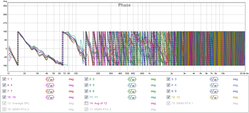

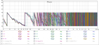

I completed my measurements also. They agree with yours, and what I think we all expected. The IR and the phase and SR are badly distorted when moving the mic (MMM) using sweeps. The SPL is fine however. Averages coming soon.

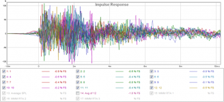

12 IRs using MMM with Sweeps:
12 Phase using MMM with Sweeps:

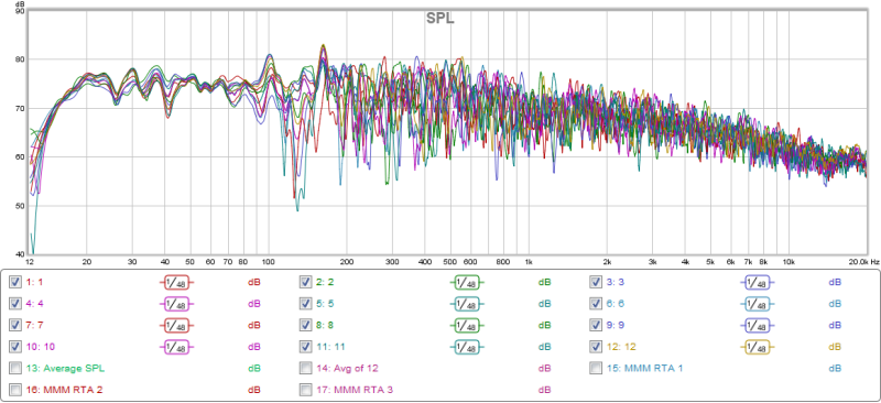

12 SPLs using MMM with Sweeps:
The 12 SPL (1/48th octave) charts are similar to the results with different mic positions in the same range.

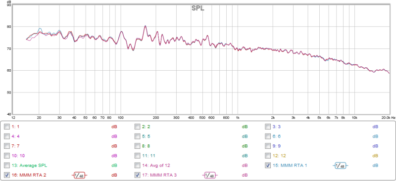

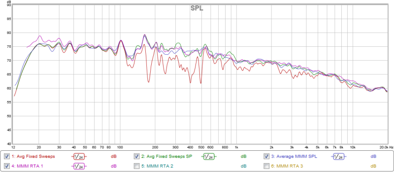

SPL comparison for different averaging methods.
3 methods agree closely:
> Simple SPL average of 12 sweeps using stationary mic positions (green)
> MMM of 12 sweeps (blue).
> MMM using RTA “forever” averaging (magenta).
1 method does not follow the others:
> Aligning IRs of 12 sweeps using stationary mic positions averaging the IRs (red)
The MMM RTA is quick, easy and repeatable compared to the others.

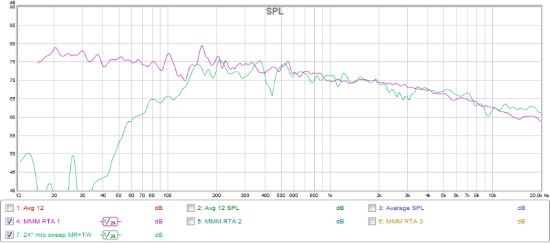

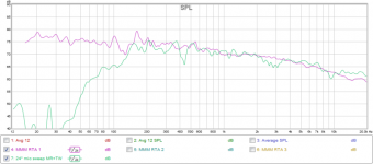

The 3 SPL traces that agree above also relate well to close mic measurements. Below is MMM vs 24” measurement sweep w/SWs off.

This was the main point of the topic, it's nice that we come to same conclusion.The MMM RTA is quick, easy and repeatable compared to the others.
