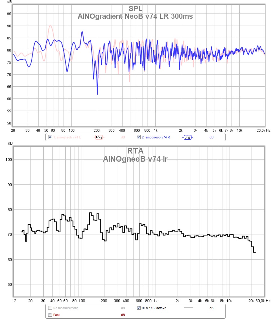

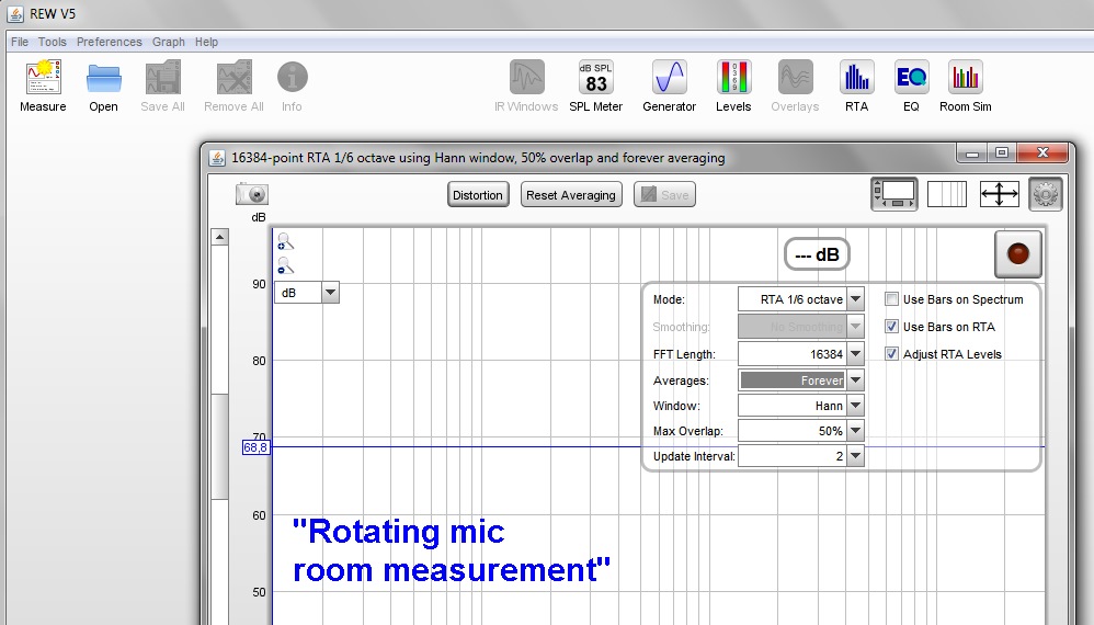

Room measurements should never be done at only one mic location. My friends have learned to me an easy way to do multiple measurement.
We use REW in RTA mode, Forever averaging. Play pink noise or pulsating pink noise with one or more speakers at the time, start RTA recording and move the mic slowly, 3-dimensionally around your head at your "sweet spot". The radius of movement should be 0.5m (2 feet). Continue recording for say 15 seconds. Then after stopping you can toggle for varius smoothing to see how the response looks.
The measurement reflects true room power response and audible spectral balance well. For learning measure several different speakers and compare measurements to your audition (how you hear them to sound).

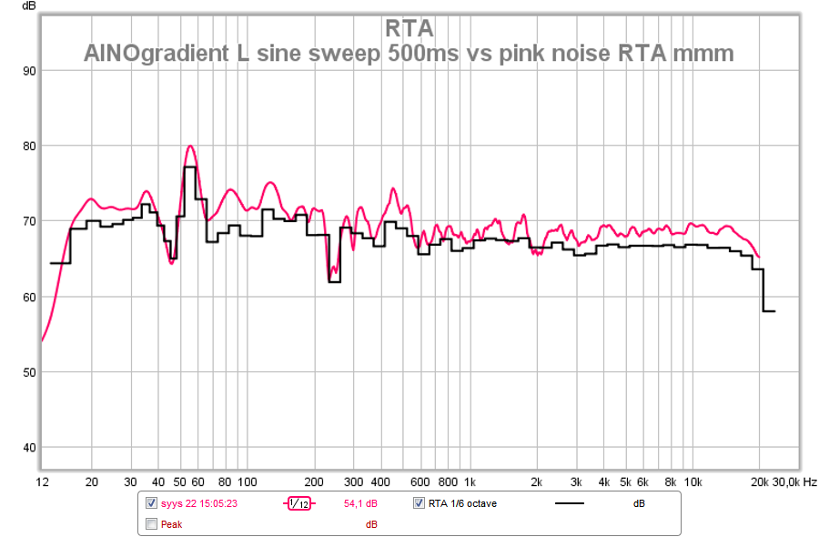

Yes by definition, but pink will measure flat! ½ or 1/3 oct smoothing is best. If L and R are playing simultaneously, highest treble will descend a little because of interferences.

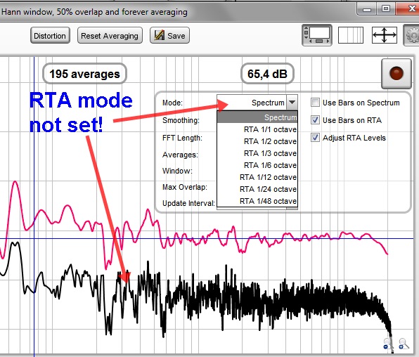

Here's 1ch, non-smoothed sweep vs. pink from listening sofa's back rest (non-moving mic). Pink noise (black curve) has noticeably more descending curve. White noise behaves like the sweep.
Strange! Here are my fresh measeurements - pink noise gives similar response to sine sweep! REW v5.1 beta22, digital out to ObjectiveDAC, measured with calibrated UMIK-1.
I wonder what is causing this difference to Legis' measurements?
Edit -I found it! Legis didn't have RTA mode set at RTA properties in REW
Juhazi, try "Spectrum" view instead of 1/48oct RTA. I Just noticed this, but I don't know why they have such a difference?? Very strange, maybe a bug? Also the level in spectrum view drops drastically. I wondered why I had to play so loud...
When REW is in spectrum mode, it is measuring energy in linearly equal width frequency bins (~ 5Hz for 8192 samples @ 44.1 kS/s). So energy from 40 Hz to 45 Hz is summed and displayed on the same scale as energy from 12460 Hz to 12465 Hz and pink noise shows up with a -6 dB/octave slope and white noise is flat.
With 1/XX octave RTA, logarithmically equal frequency bins are used, so energy from 40 Hz to 80 Hz is summed and compared to energy from 4000 Hz to 8000 Hz, for example. Pink noise is flat, and white noise has a rising slope of 6 dB/octave.
