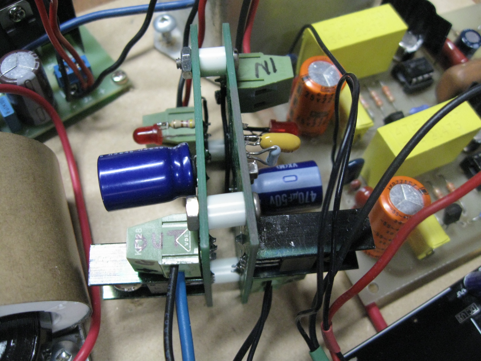

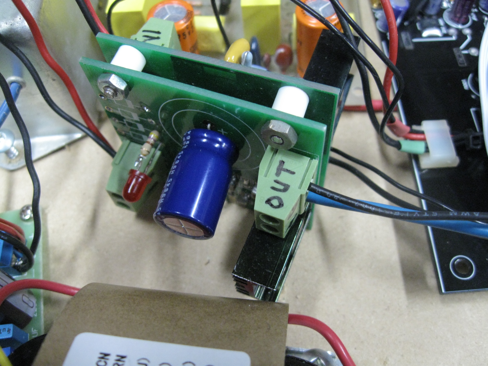

Update. I did install the Sulzer Borbeley Power Supply first.
I will show step by step details.
Turned it on and discovered something. Uh Huh... I was always told to watch out for this. Fixed it.
Then I listened and listened and the conclusion will come later.
Then I went for it and decided to install a couple of LT3042 boosted to 1 amp.
I modified each LT3042 board with a Cset of 47uF Tantalums + whatever was already on the board. I then crossed my fingers that the slower ramp up would not cause issues.
None. Turn on was smooth as silk.
Listened and listened. Wow....this time the LT3042s sounded great in the low end unlike my experience I had with them on the 9038Q2M. There it probably was not the LT3042 but something else.
Bass is fantastic. Chorals...superb, Brass with real bite. Pianos will pound your chest when the player wants. But when you want soft vocals, the sound could indeed seduce. Yah.
I'm a fan of PRAT and this has it all in spades let me tell you.
Advance thanks for MarkW4 whose work on the 9038Q2M board inspired me to get into better digital and I am glad I did follow his guidance. Learning that smoke indeed runs ICs. I am keeping it inside this one!

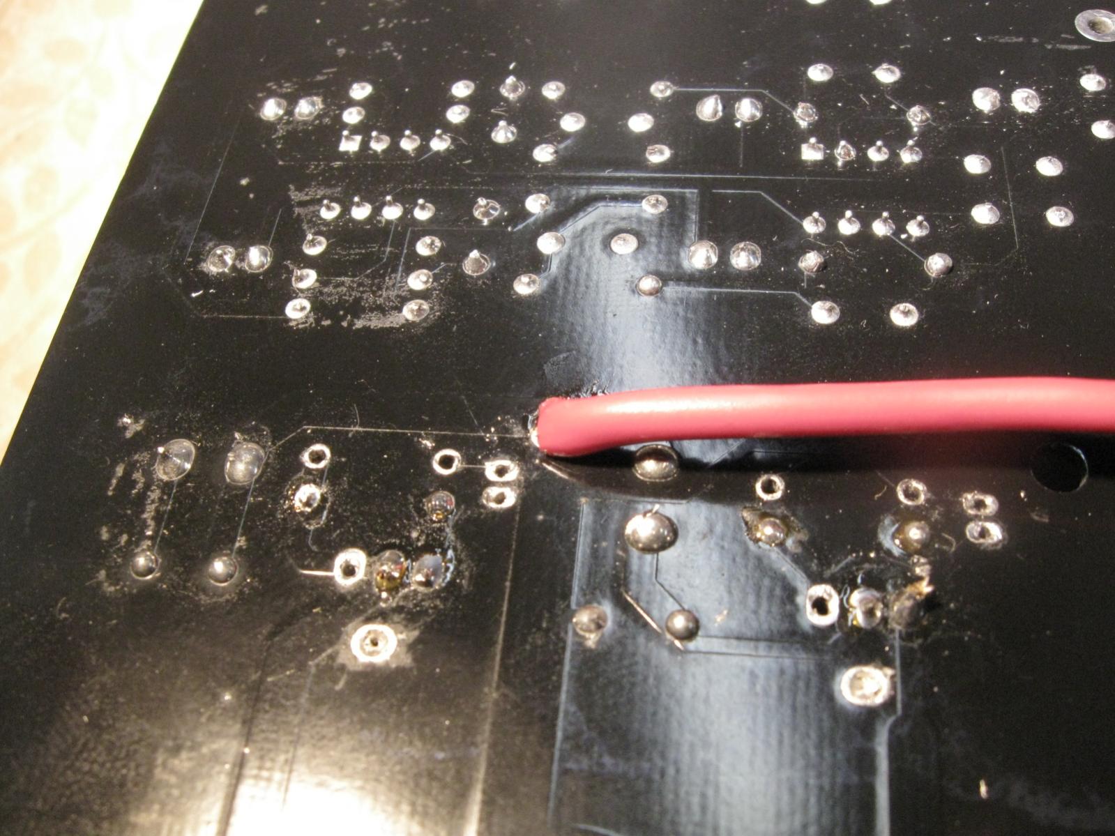

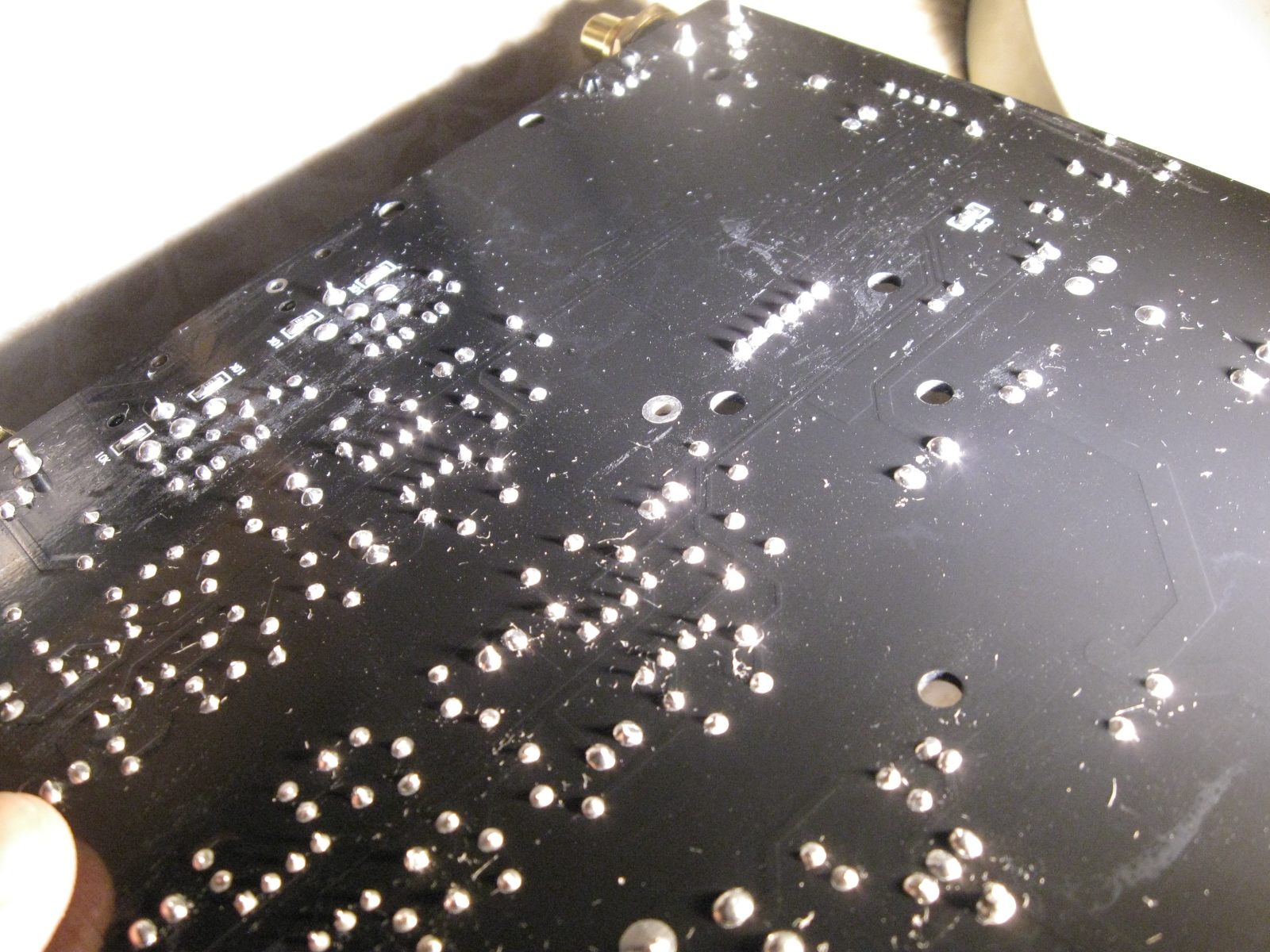

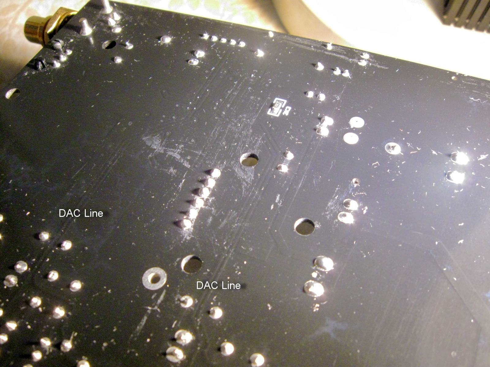

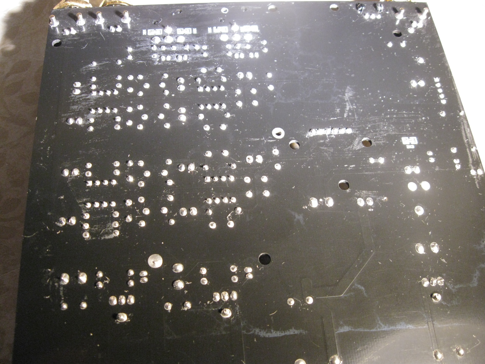

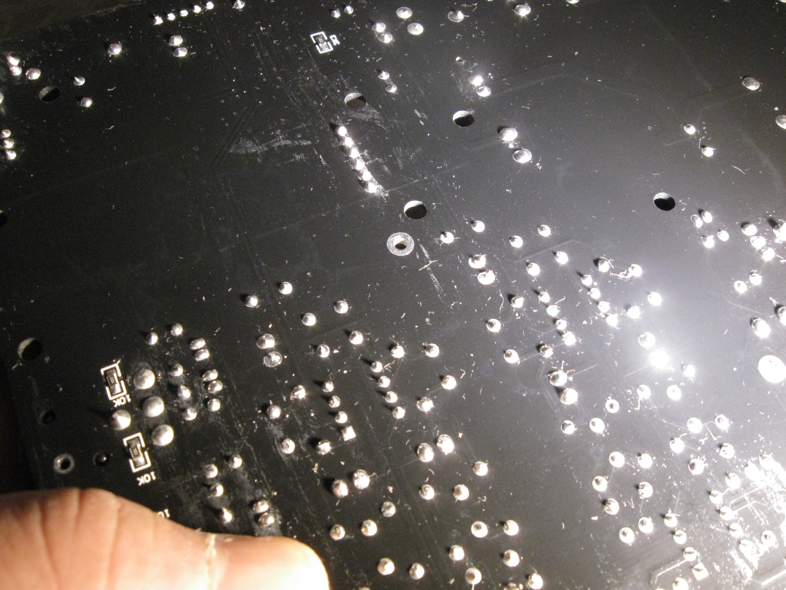

While I had the board out I would show the undersides.
The lighting was adjusted as best I could to enhance the line shadows.

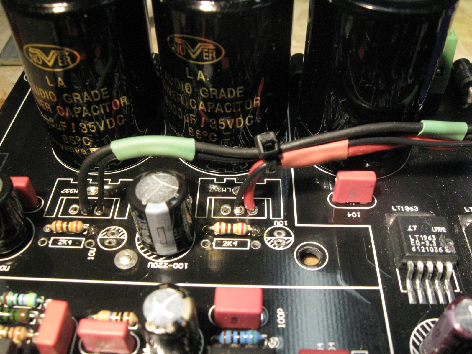

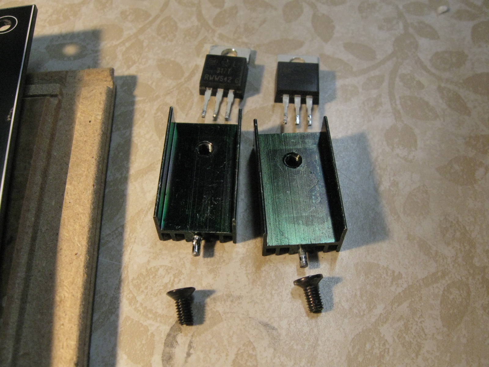

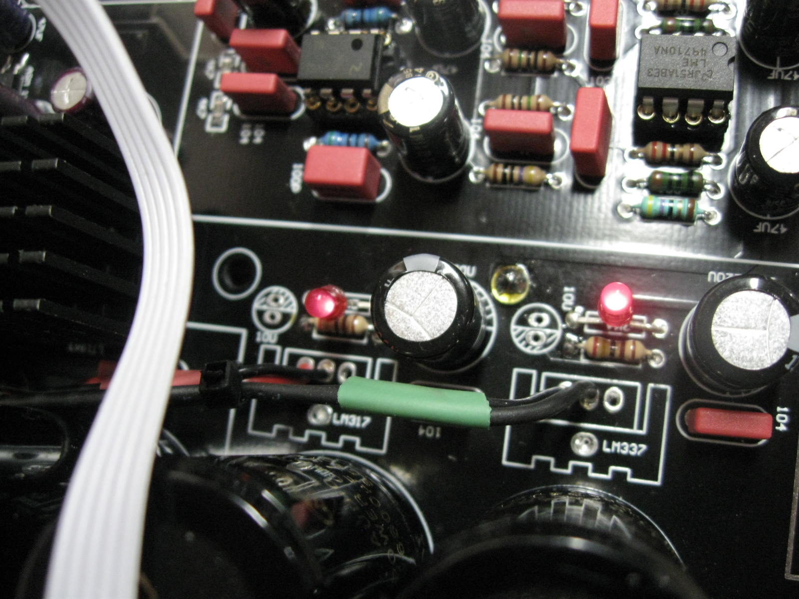

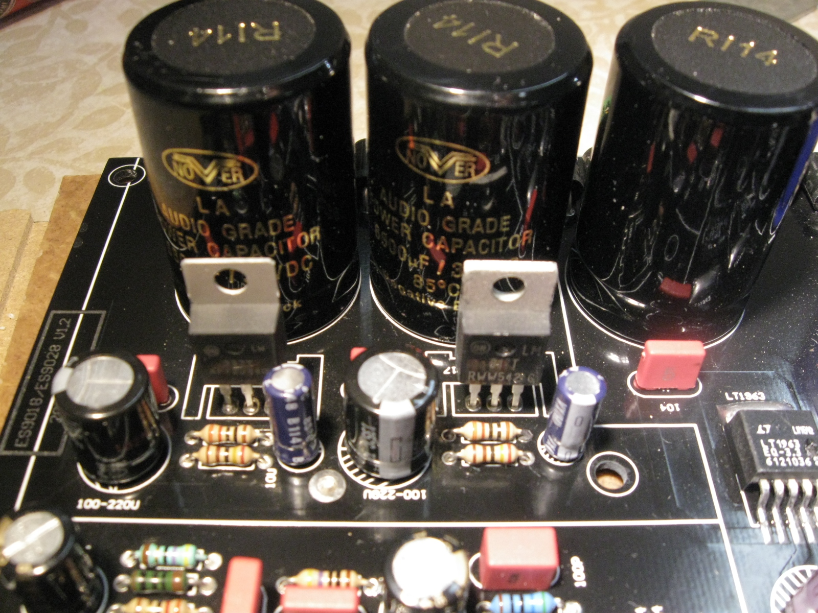

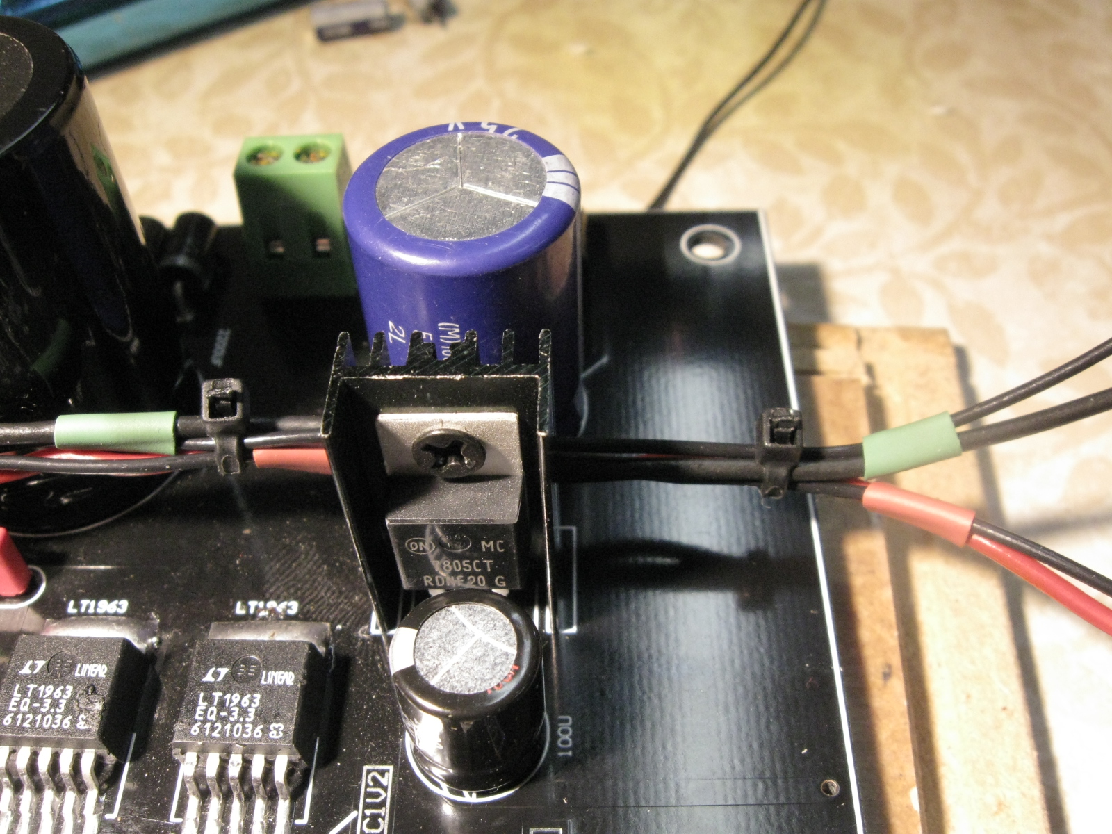

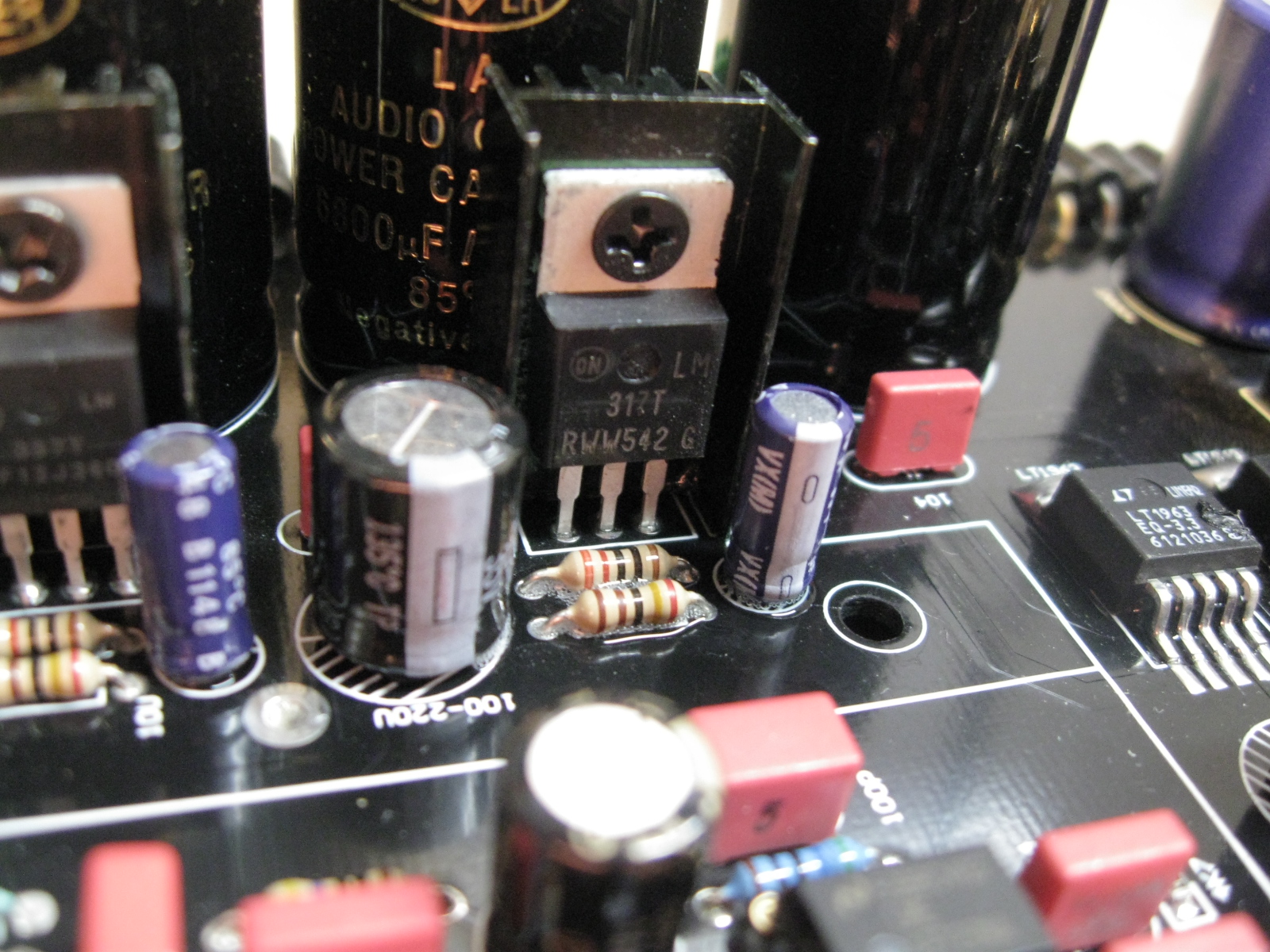

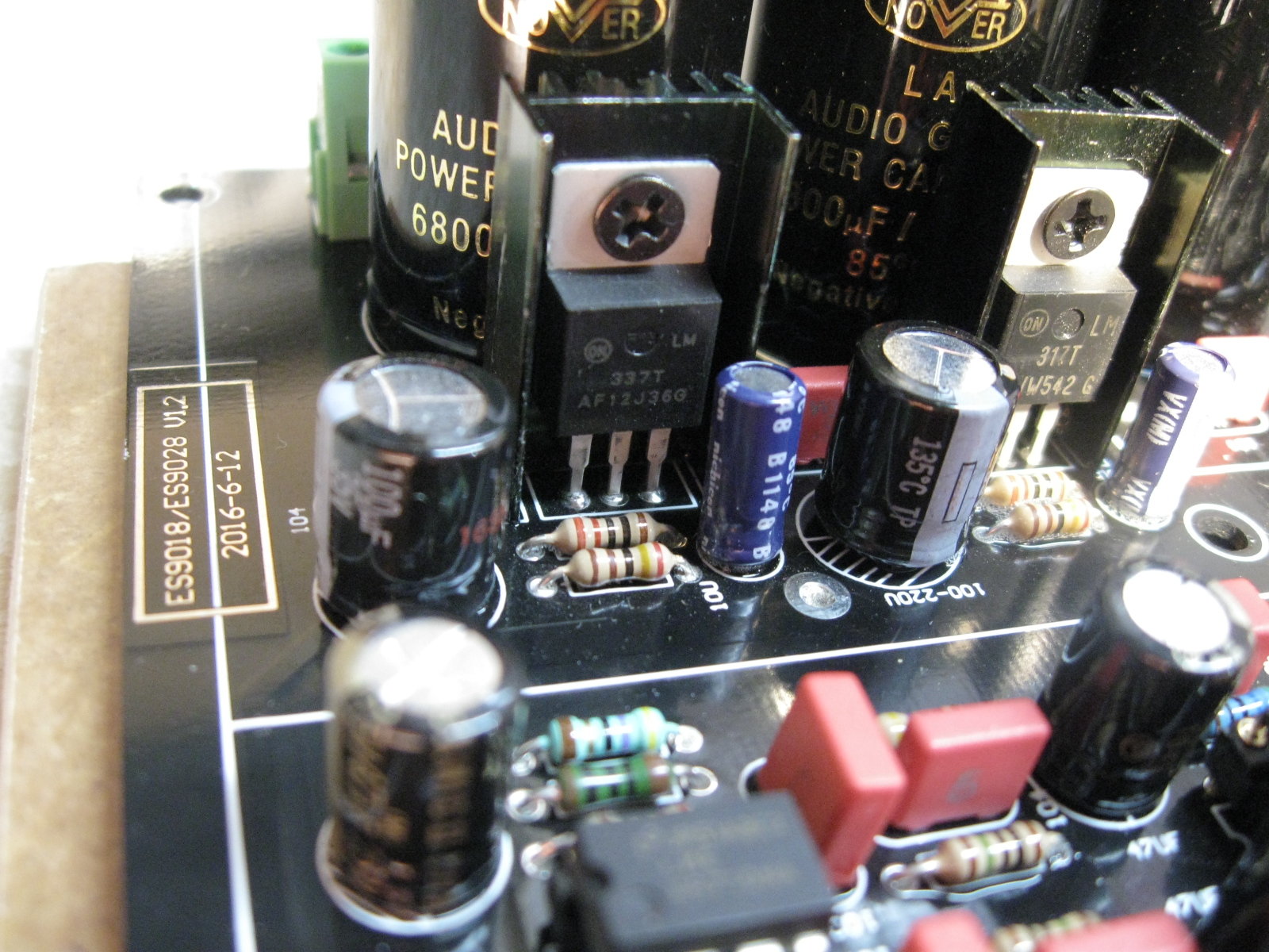

Now we begin the mods.

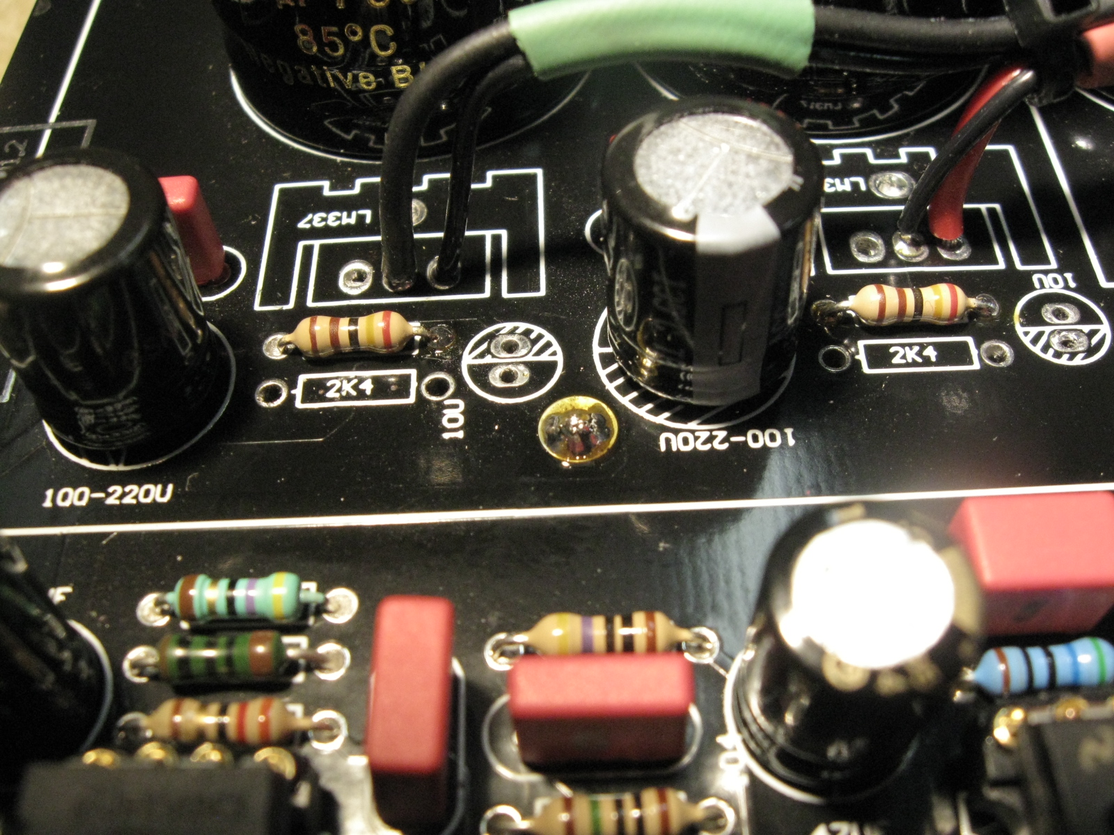

First we remove the 317/337 regs.
Since the regs were removed, there was no need for the voltage dividing resistors to the adjustment pin so I elected to remove those as well as the decoupling cap.
Then a thought occurred to me...... I could put in some pilot lights in there by reusing the 2.4K resistors and some LEDS. That way I can easily tell when my regulator has output.
Next stroke of luck was that there was a large plated hole for the ground point. I grabbed some 12 gauge wire and used that for joining ground to my Sulzer Borbeley PS.
