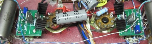

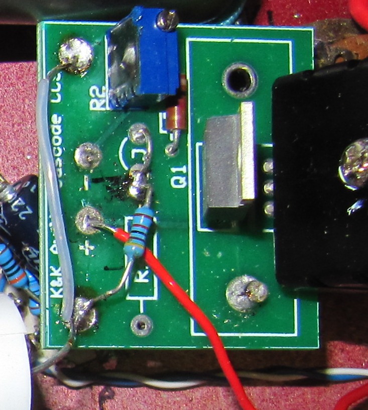

Attached are pix of CCS before choke addition, and how they are now--first choke/R ch, then resistor/L ch.The latter have been mucked about by the changes,but I defy anybody to find a fault in their construction,how can one err with a pcb based item? It stretches credibility that one can be malfunctioning, now,with the choke, and the other not.If wanted, can do better detailed pix.
I am not saying that the CCS fails with the choke, but works OK with the resistor. Your results seem to rule that out, as you have poor HF response in both cases.
Making a mistake in PCB-based construction is dead easy! Most of us on here will have done it. Pictures don't help me, because I have no idea what it is supposed to look like.
You need to measure the output impedance of the stage, as pieter t suggests. Alternatively, try taking output from the anode and measuring frequency response again.

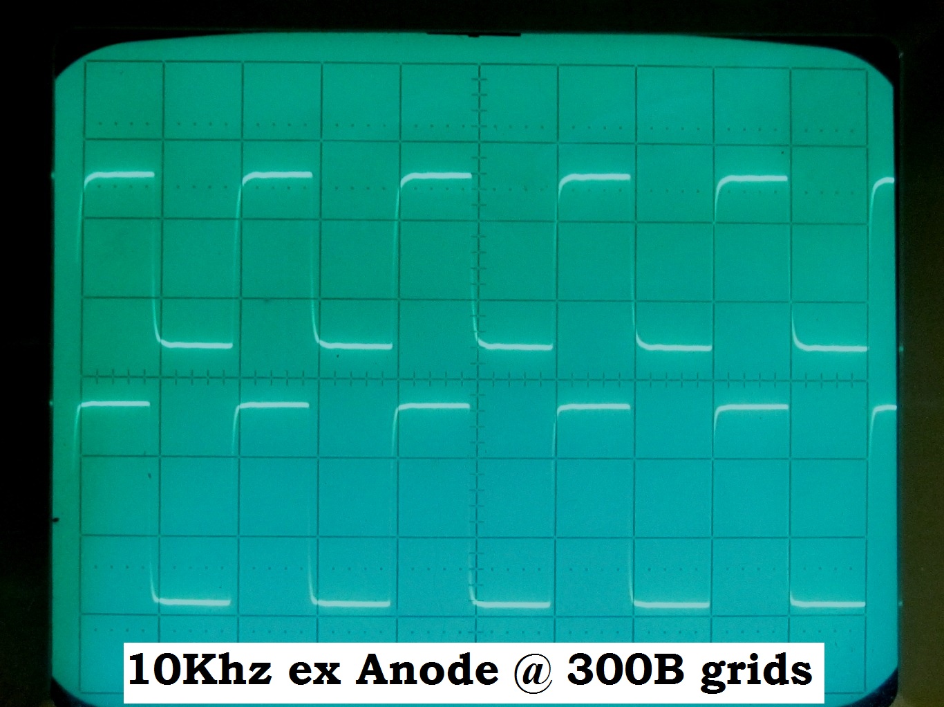

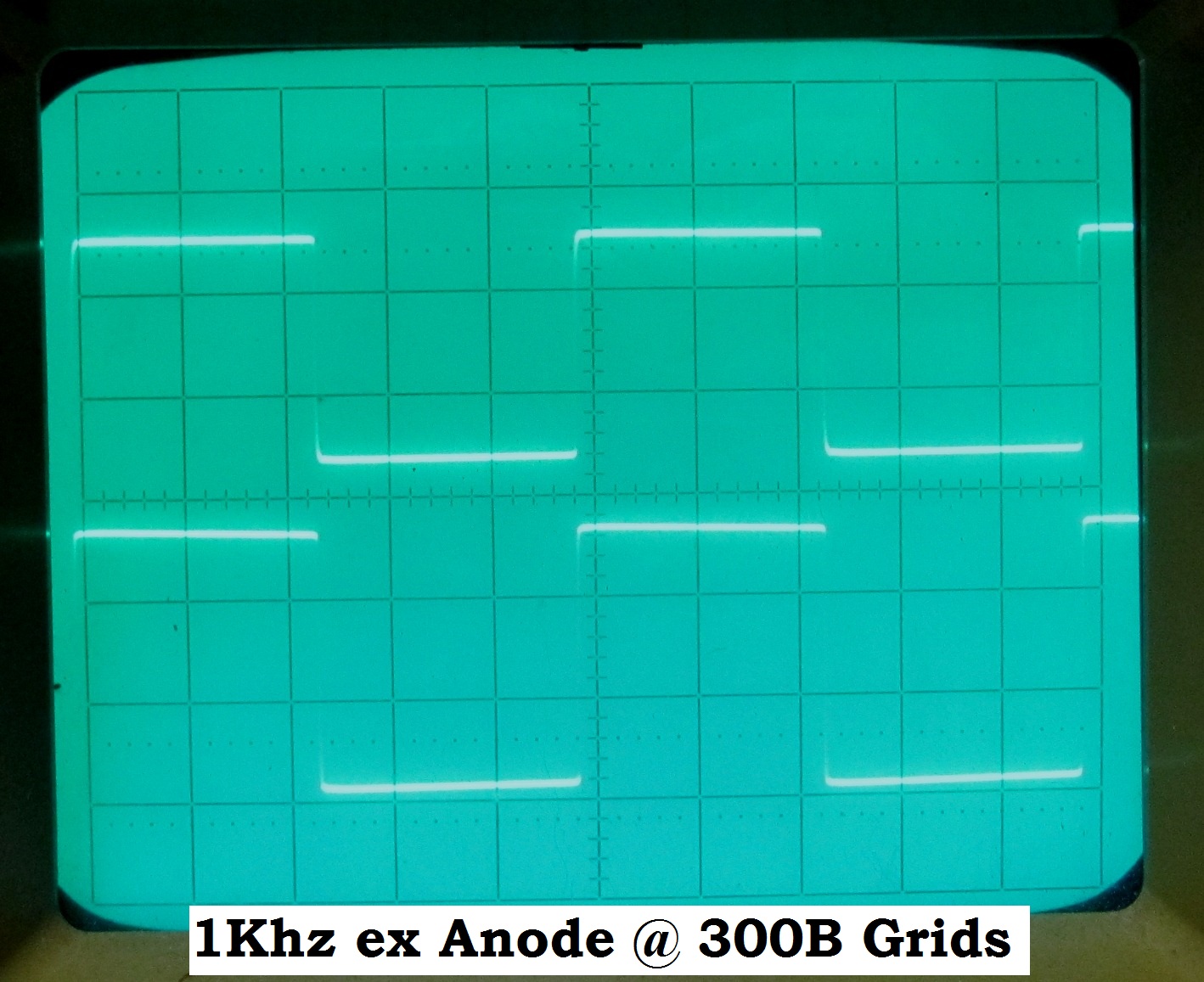

I think the problem is solved.
The CCS survives triple scrutiny, the only anomaly is the pot has not been replaced with a fixed resistor.
When anode is the output point, only minor differences between choke and resistor are seen, and pix demo the FR. Indeed, choke is better @ 100Hz and 1Khz, it's extra capacitance compromising performance at higher frequencies, as expected. BTW DF96--just how poor is poor HF? For Mu/R loading -6dB was 46K;anode/R loading, 88K. [Measured off 'scope as RMS ACVM not trusted]
The amp being needed, this exercise must stop--grid choke loading will be kept, as there is only a minor sacrifice at higher frequencies,but the mu output is set aside in favour of the anode. Sometime the pot will be replaced by a fixed resistor.
Most interesting to see other's scope pix--thanks MelB--how do you like my 100Hz squares? Maybe a larger value coupler is necessary....
Thank you all for your assistance,it's greatly appreciated, even if the output impedance measurement ended up in the too hard basket......
