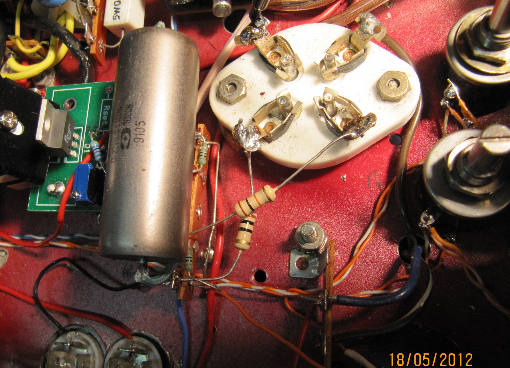

I have a most puzzling phenomenon I hope someone can explain.
The amp is a fixed bias SE300B, driven by triode-connected CCS loaded E180F, as per the Audioroundtable thread. Re: 300B SE Project, Part 9 - E180F, E280F, D3a pentodes - triode connected
I hope others can open these images, I cannot. There is no other way of downloading an image it appears.
Initially, not having grid chokes I departed a little from the schematic--mu output from CCS into 0.22uF coupling cap into 100K grid R. Perfectly satisfactory performance, on bench and sonically,driving just an Edgarhorn.
But the urge to try a grid choke was spurred on by the 640H eBay item, and good reports thereof, elsewhere on this forum.
However,their installation [plus 1uF coupler] had dramatic and unexpected impact on HF response, with rolloff beginning 3dB down at 10K,-6dB at 20K. Previous figures, -3dB 53K,-6dB at 100K. Checking with scope probe at E180F plate, all as before,from mu out,as above. Inserting 91K below the choke made little difference.
Restoring the cap/resistor restored the HF, and a decent 1K square wave....
Maybe the choke size is insufficient,[the original being 1700H], though others seem happy with it.
Does anyone have a simple explanation of this puzzle? It's got me beat.

DF96--thanks for the input--I've yet to master uploading pix but the schematic is in the link in the first post-- click "Open link in a new tab" and the entire article on trioded E180F etc [in audioroundtable.com] is there.
Using the "mu" output and CR coupling the performance is exemplary. It's only when the choke is subbed the highs die.

OK. There must be something wrong with your 'CCS'. The choke will have much higher stray capacitance to ground than a resistor. One of the FETs faulty, or miswired?
Hi DF96, thanks for your persistence.
CCS's are on proprietary PCBs from K&K, and behave as they should--perfectly--as long as they are loaded by an R and not an L, hence the puzzlement. I'll try to load a pic.
I think Miles Prower has the right idea--forget about the choke, and revert to the good ole reliable resistor...still doesn't explain why others use them to advantage and without bother.

To clarify one point--frequency response at the driver plate is more or less flat, out to 100khz. It is similar at the 300B grid, if R loaded.
The answer has to be that, as earlier noted,and I quote M.Prower: "The problem is likely stray capacitance of the grid choke that's bypassing the high frequencies," and DF96: "To wind a high inductance choke with low capacitance is not easy." all occurring in the particular layout of this amp. I'll try for pix to show before and after....

Apologies for the lateness of these images, but better late than never.
Since asking the question, increasing trouble with instrument gremlins leads to serious doubts whether the observed HF roll-off is as severe as thought.
To demonstrate possible differences, have wired the right channel with the choke load and the left channel with resistor load. The 'scope pic shows 1khz square waves, upper trace right channel, lower trace the left. The slight degradation of the square wave in the upper trace suggests high frequency loss, presumably via the grid choke's capacitance, as others have intimated.
Have also attached the schematic, tho the 1700H choke is replaced by the eBay "special"--640H, and coupling cap is 1uF cf 4.7uF, and pix to show the layout.
