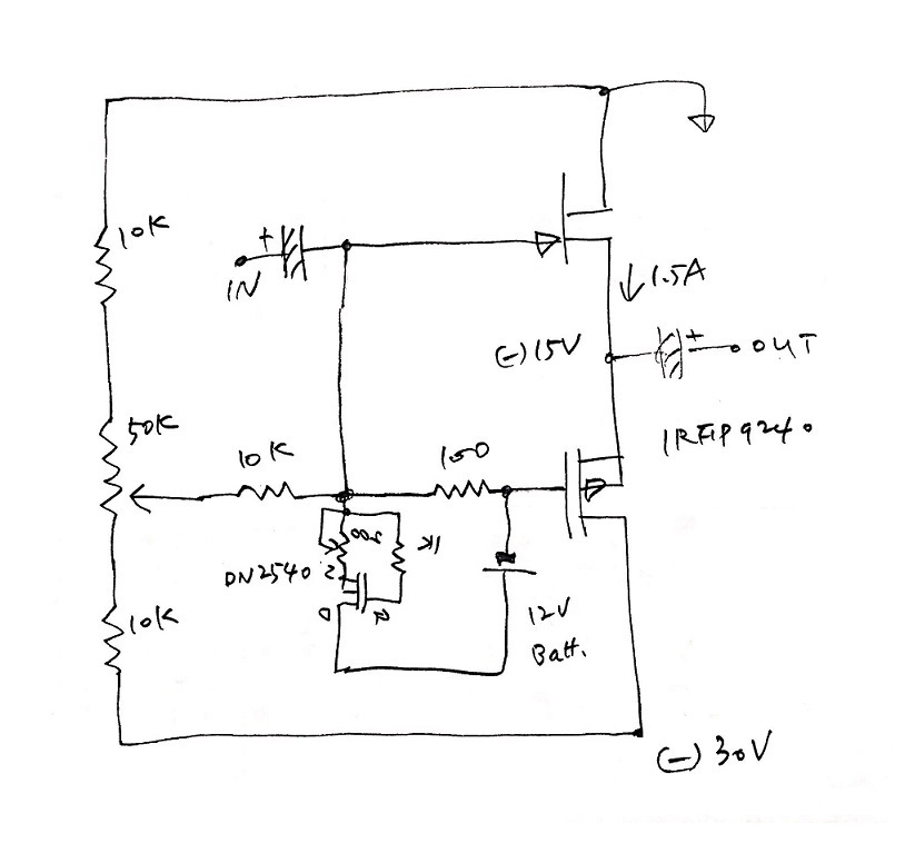

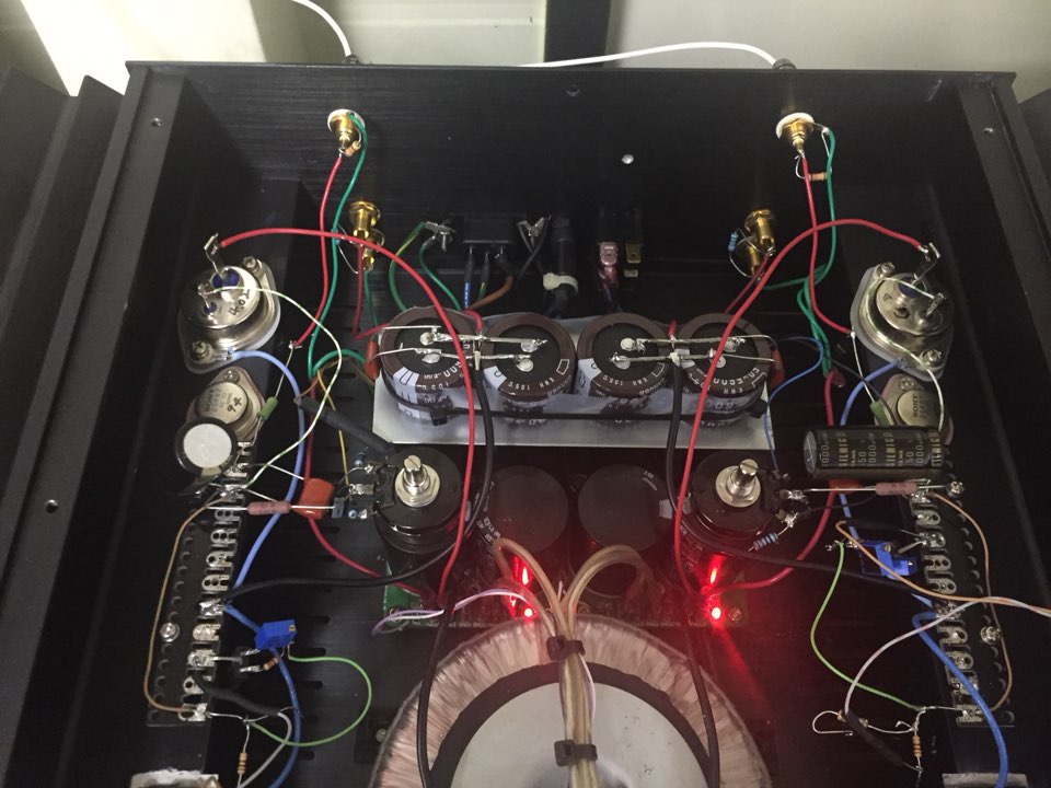

Give me that PCB Might Man!

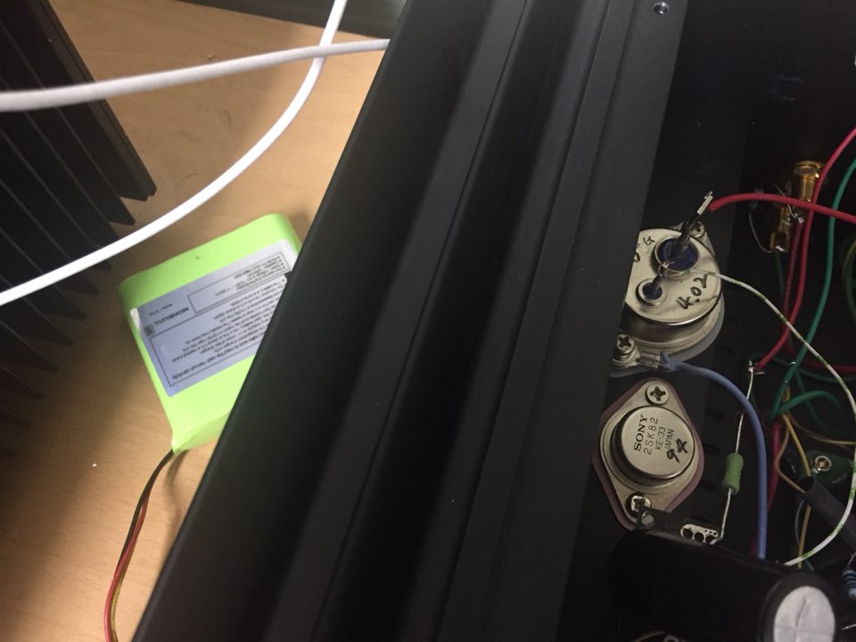

I tried THF51 into the battery biased DEFiSIT.
These wild horses insist Vgs of -0.3V and -1.1V respectively. Ha ha..
I managed to bias them and am listening to them. I had to switch the polarity of CCS circuit.
Even these horses can be used in your circuit? I hope so.
If you know of a quiet bias supply that can replace batteries, please give me tip. Of course until I can use some nice PCB of yours

These wild horses insist Vgs of -0.3V and -1.1V respectively. Ha ha.. ......
you mean - difference between gates , one channel 0V3 and other 1V1 ?
to be more specific , just measure Vgs of each of them , and write here
example - both THF51-S I used in SissySIT prototype are having -3V40 for 2A Iq , while one IRFP9240 is 4V1 , second is 4V5
that means , in first channel , there is (4V1-3V4)= 0V5 window to squeeze optocoupler bjt in , while in second channell window is (4V5-3V4)=1V1
silly me , I didn't even selected those IRFP9240 ...
OK , numbers don't lie ....... but how's that , just -0V33 and -1V1 , for THF ??
I didn't measured them at other voltages/currents other than those interesting to me
so these are values for 15V of Uds and Iq 1A5 ? , where (just) 15V is obviously dominant
conclusion - for any selection , same must be done on intended rail voltage and intended Iq
logical , taking in account their resistive character
