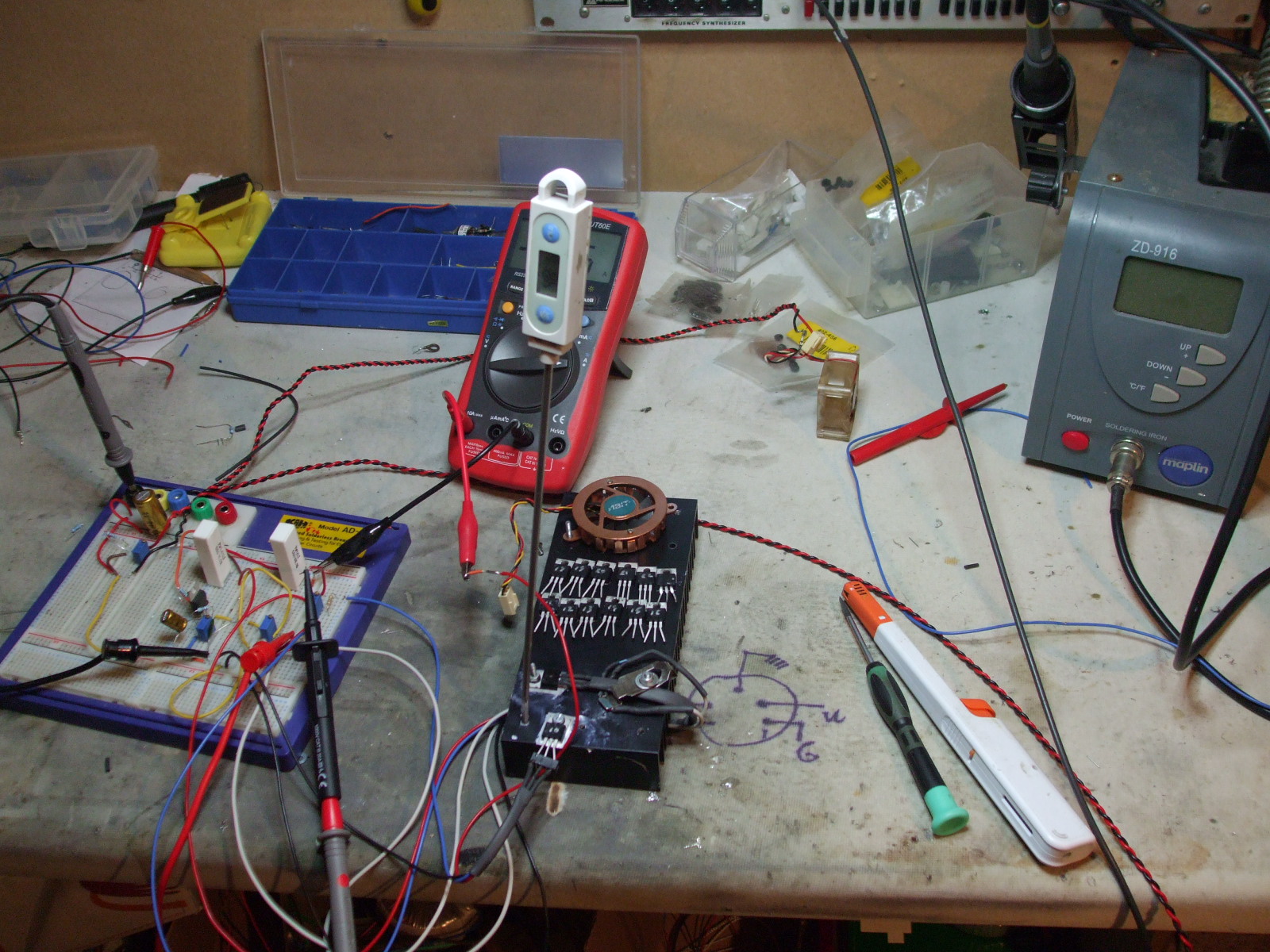

I have made same more progress on Mosfet testing
See the attached documents
The spreadsheet shows a preliminary test on one of the Mosfet from cold
And I mean 7.2C cold at start up.
At the moment is all on a breadboard and should be beter once properly built
still from spread sheet 2 it shows a 15 minute test and the values cycle up and down in less than 15 minutes and are whith in the 2nd decimal place
I will ran the same test tomorow if I can and I expect I should get similar results
Tanks to Nelson Pass for the Matching Mosfet article from which this is derived

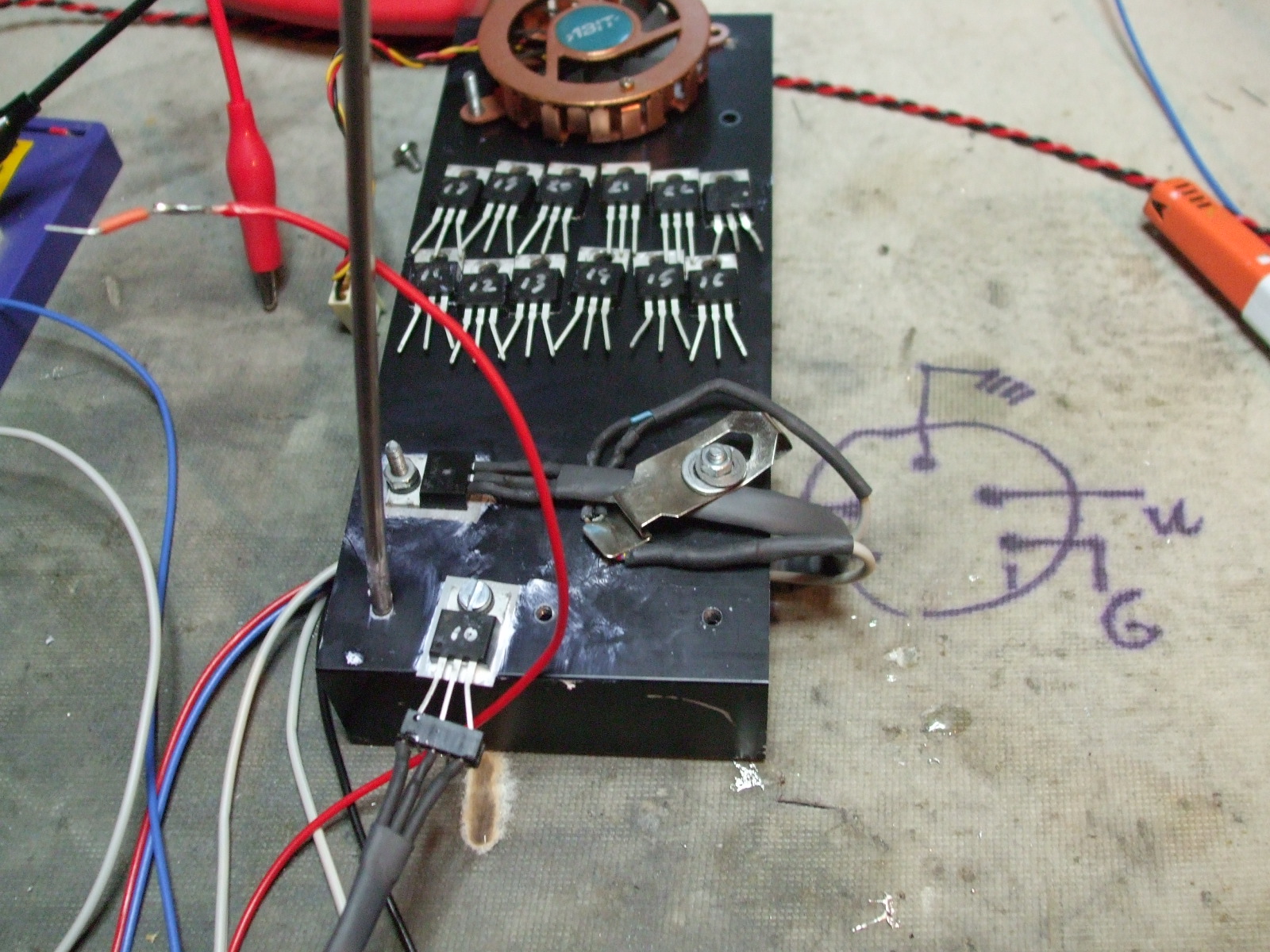

Mosfet test update
Much warmer in the loft today 7.7 C
Also still on the bread board and the supply to the gate is not regulated so that may be what moved the goal post
But even on those condition the 2nd Decimal place is on target
Time to put the lot on a PCB and make things a bit better
The temporary Rig (heat sink and such) works a treat it may be to large causing a bit of lag on the control of the temperature
Slices of foam between same of the fins should take care of that

at 42 fan on 120seconds for temperature to start to drop
Test at 10 S interval

I'll draw a schematic tonight and upload it with more details.Please tel me more
Al
- you can make differential tester - with one mosfet as "etalon" one and another as DUT, but you need controlled temperature for both etalon and DUT
There's another way of matching FETs if you have two matched resistors (0.1% or better).
In this case voltage regulation and FET temperatures are not a problem at all.
Using this method you will match two FETs connected at the same time with same conditions.
differential test, compare DUT to REF.this sound very good
Please tel me more
