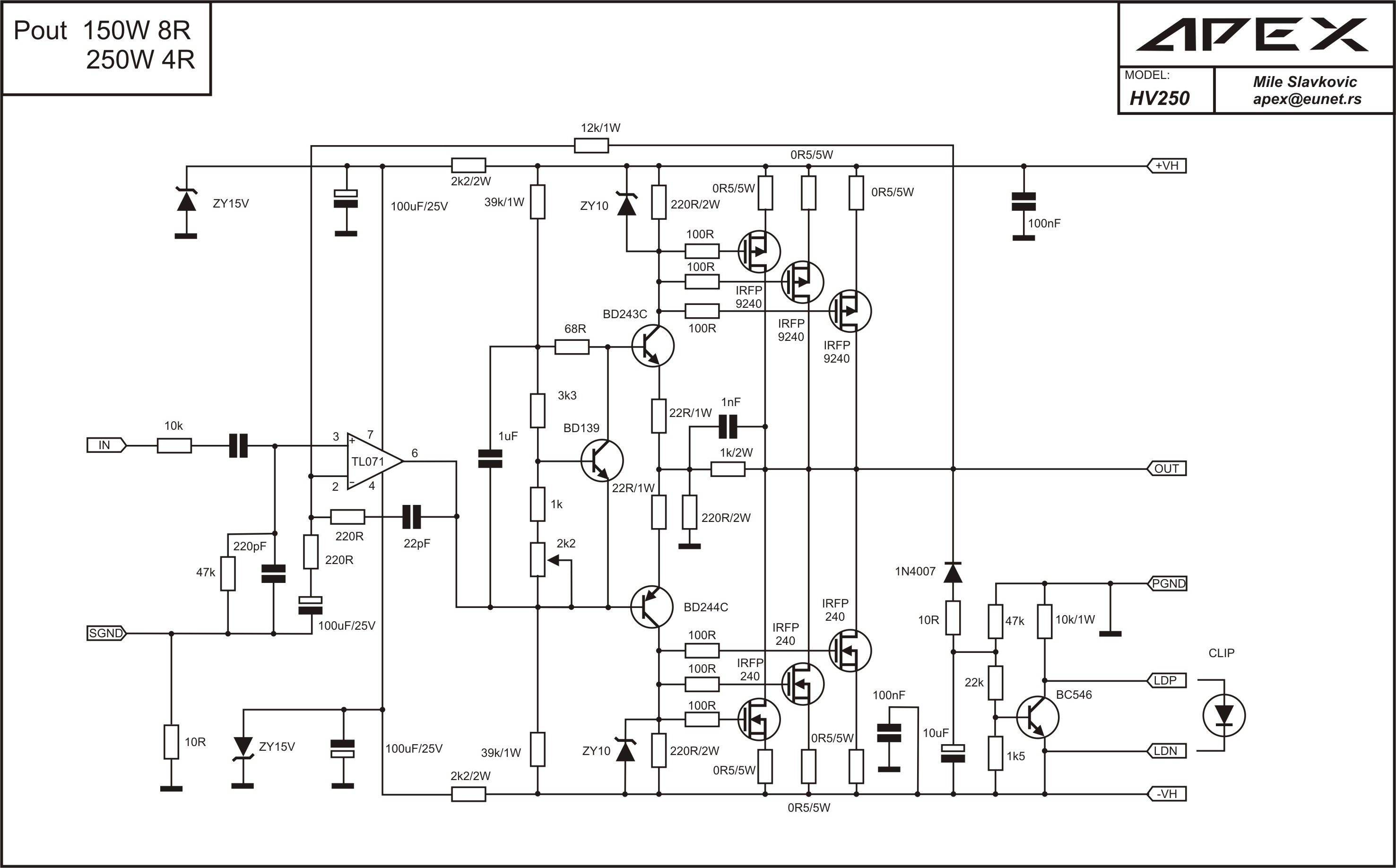

MOSFET Amplifier IRFP240/IRFP9240

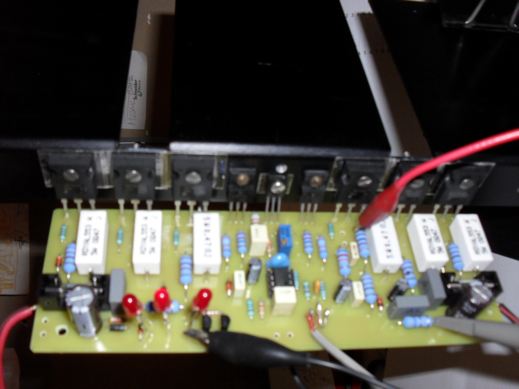

3pair output stage equals 6 source resistors.
Set the bias voltage low to start with, maybe 10.0mVdc across Rs1 and measuure all 6 after they have reached equilibrium.
Then increase in 10.0mV increments allowing time to resettle and re-measure.
By the time you get to 50mV (100mA) you have a table of measurements for all 6 Rs
You will see if they all remain very similar, or some wander off a little, or a lot. This will really show how well you selected for Vgs.
It was a test like this that showed how much better a thin mica is at transferring heat compared to a good quality low thermal resistance soft thermal washer. I had used my last three Thermal washers for all the upper devices and reverted to mica for the opposite side.
Hi AndrewT, thanks a lot for your advice again. So, it`s time to work, soon I gona say something.
Regards

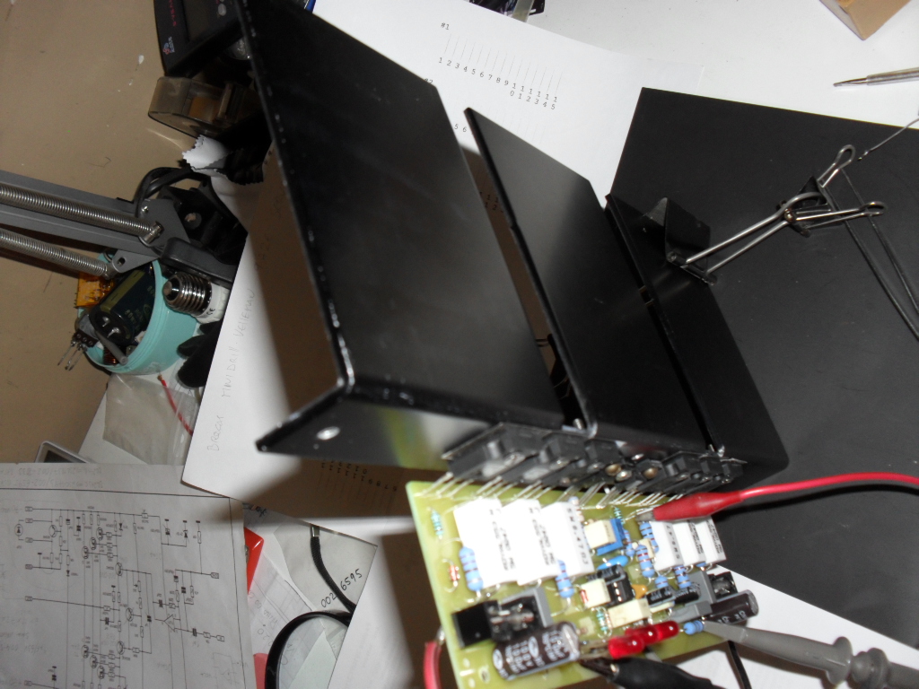

Hi AndrewT, the amplifier is working good the powers are more or less in balance the sound is charming, but I had to run a little beat because heat sink is only for test, is not enough. I put 47mV in S resistors because they are R47. Thanks for your suport and thanks to Mr. Mile also.
Regards and Pozdrav

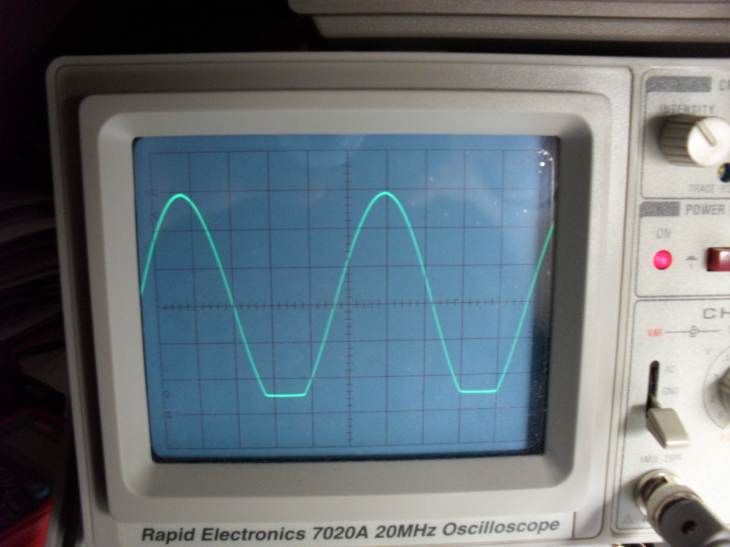

Hi Mr. Mile, I would like to hear something from you. I put 1Khz and 8R resistive load and I got this. The positive side almost clip and de negative side is as you can see in the photo (20V per divsion). I replace the drivers by 2SC4793 NPN positive side and 2SA1837 PNP negative side. Thanks in advance.
Pozdrav
Pozdrav
Bias circuit is in positive side and clip is unsimetrical... it is ok.
Regards
