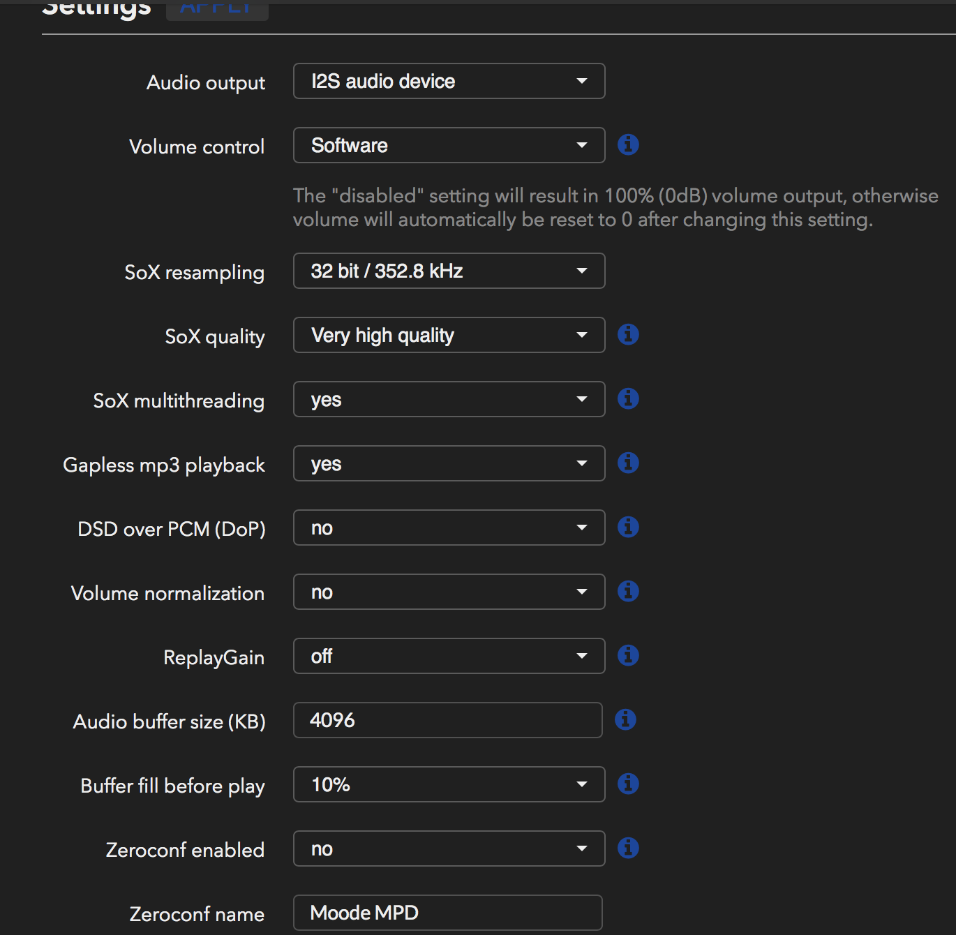

	  M P D    S E T T I N G S
	Version			= 0.20.12
	Volume control		= software
	ALSA device		= hw:0
	SoX resampling		= 352800:32:2
	SoX quality		= very high
	SoX multithreading	= on
	Audio buffer (kb)	= 4096
	Buffer before play	= 10%
	Output buffer size (kb)	= 81920
	Volume normalization	= no
	DSD over PCM (DoP)	= no

I am just not experienced enough to sort out what is going on.
Thx so much!

After turning on graphic EQ, this is what I get:
Code:
pi@moode:~ $ sudo /var/www/command/sysinfo.sh
Thx so much!
I don't see anything suspicious in the Sysinfo output so not really sure whats going on but the UI symptoms suggest that MPD has crashed. Maybe take a look at MPD log for an indication of what might be going on.
cat /var/log/mpd/log
-Tim

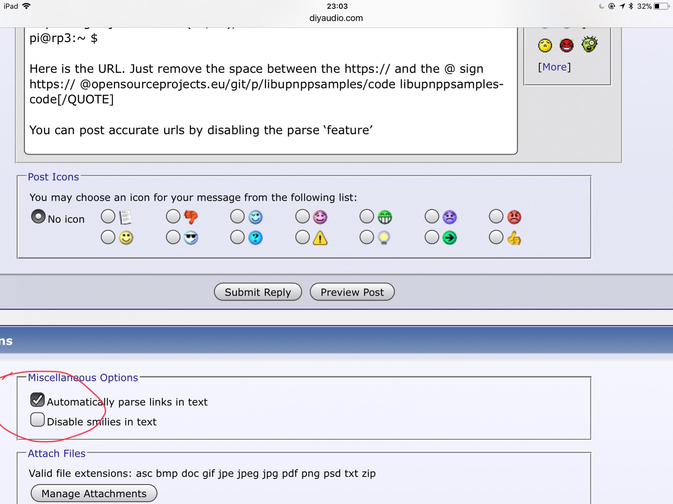

Here is the URL. Just remove the space between the https:// and the @ sign
https:// @opensourceprojects.eu/git/p/libupnppsamples/code libupnppsamples-code
You can post accurate urls by disabling the parse ‘feature’
-Tim

Here is the log after turning on EQ. After clicking the set button, I also tried restarting MDP:
Code:
pi@moode:~ $ cat /var/log/mpd/log

Here's a screenshot of my MDP settings if that helps. Could it be the SoX settings?
________________________________________________________
UPDATE: After disabling SoX resampling and setting SoX quality to medium, it looks like the EQ is working. What was going on? Should I have SoX resampling off anyway?
