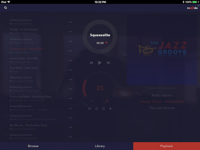

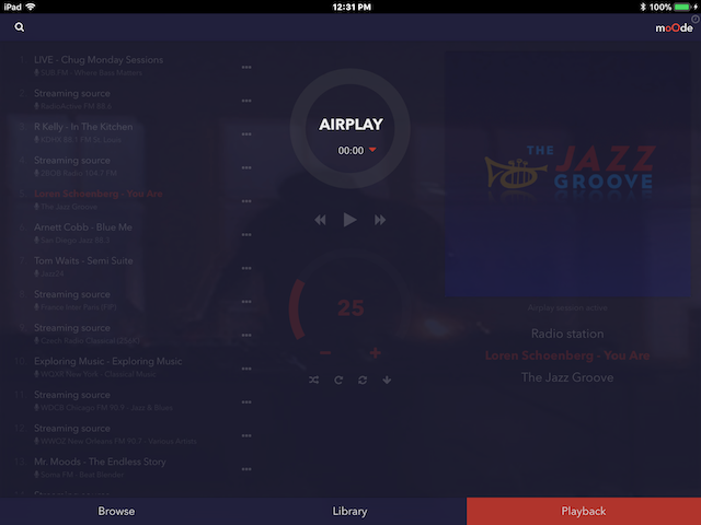

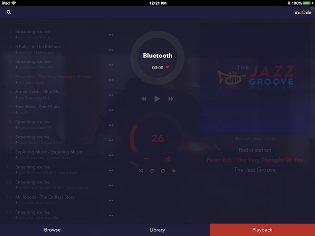

@Tim the airplay metadata option is great when using airplay but it isn’t very often that I use it.
Hi @swizzle,
When it works its ok but its inherently unreliable because there is no resend/recovery mechanism in the metadata protocol. iTunes just sends it once which means when moOde's metadata receive pipe gets stale or the data gets out of sync then its game over. Anyway, the metadata and cover art are already visible on the sending client.
FYI, audio renderer handling has been completely overhauled for the next 41 TR including adding a robust socket based UI updater for Bluetooth and Airplay. This enables Bluetooth to also support "Resume MPD playback" identical to Airplay :)
See the new renderer connect screens below.
-Tim

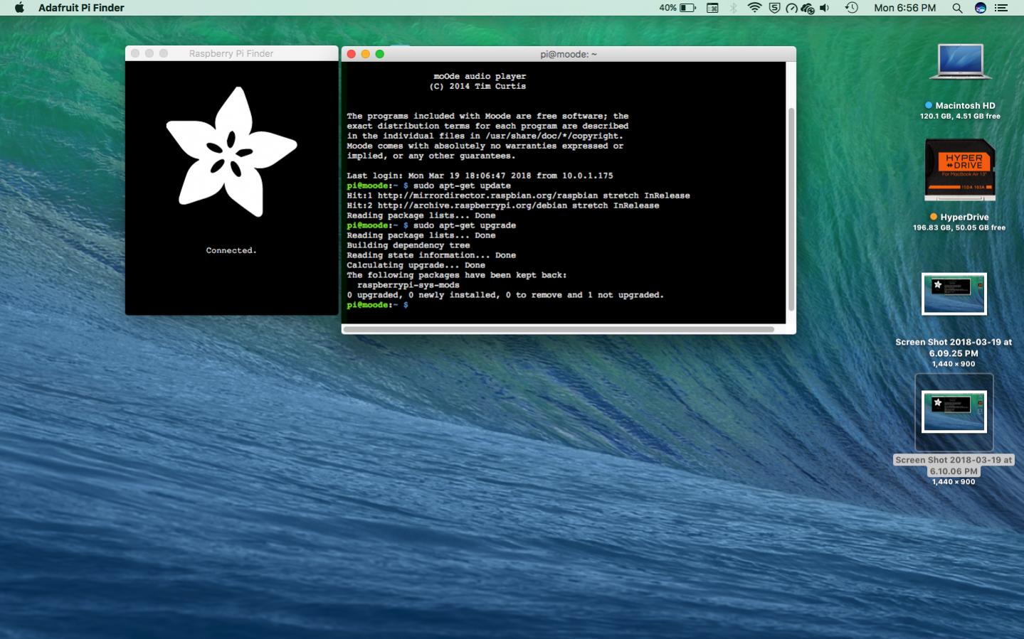

For some reason this did not work for me, I have a fully functioning instance of Moode 4.0 that I wanted to use in a new 3B+ board I received today.
I tried to execute this through SSH and it yielded the following:
@MikeyFresh
The output you show is what I would expect if you had already run through the update/upgrade process and there was nothing new to do when you tried it again. Indeed, it's what I get now that I've updated the copy of moOde Player now on my RPi3B+.

Hi Kent,
Thank you, and in my screenshot it doesn't show but I had nearly the exact amount fetched as you show there, mine said 11.7MB.
But I don't know why the Pi 3B+ won't boot then, the LEDs turn on and the yellow one appears to be flashing somewhat slower than I'm used to, but the Moode UPnP Renderer didn't appear on my network.
I am using Ethernet and not WiFi.
What about the last bit at the bottom in the screenshot below where it states "1 not upgraded"?
