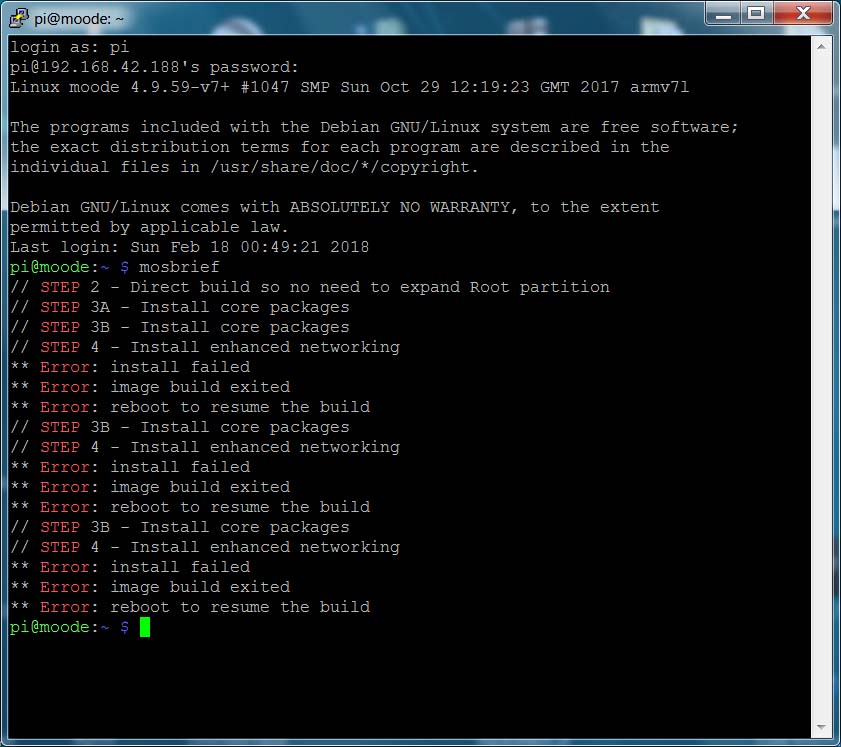

Please could you copy here result of moslast command ?Hello,
install don work...
Any ideas?
Greetings..
By rebooting, it will resume the build, did you try it ? And if so, did he fail at the same step ?
-Eric
