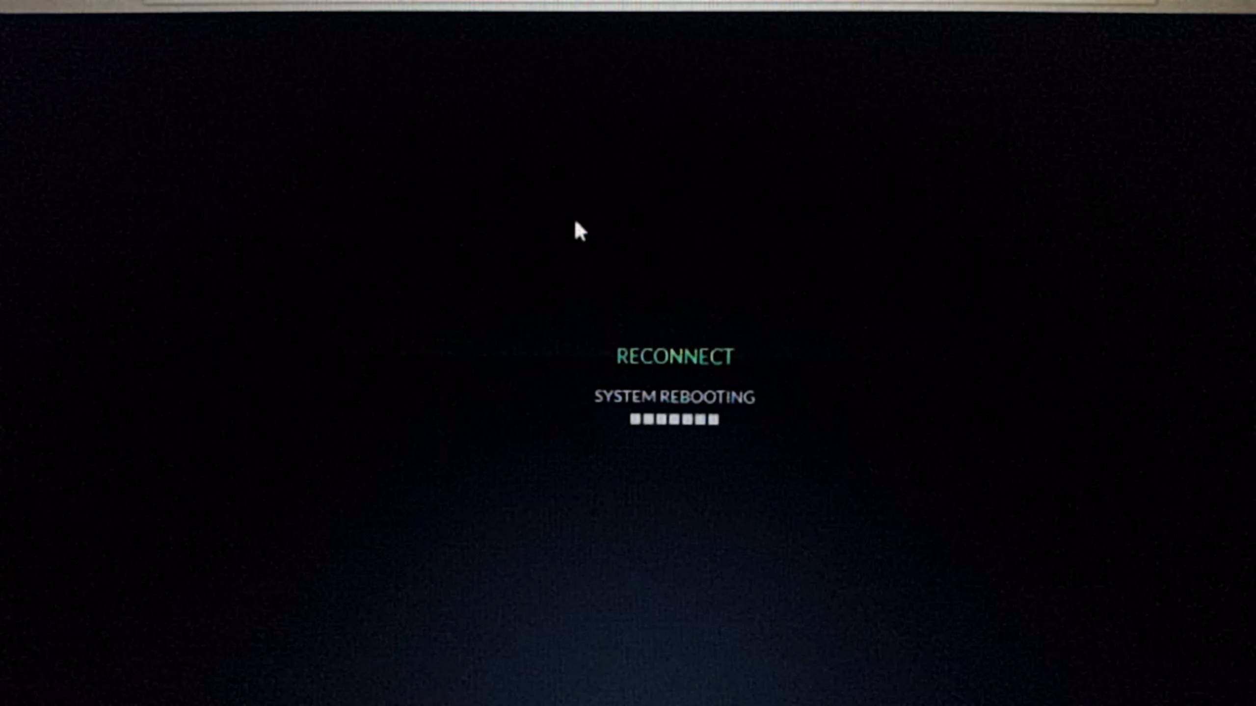

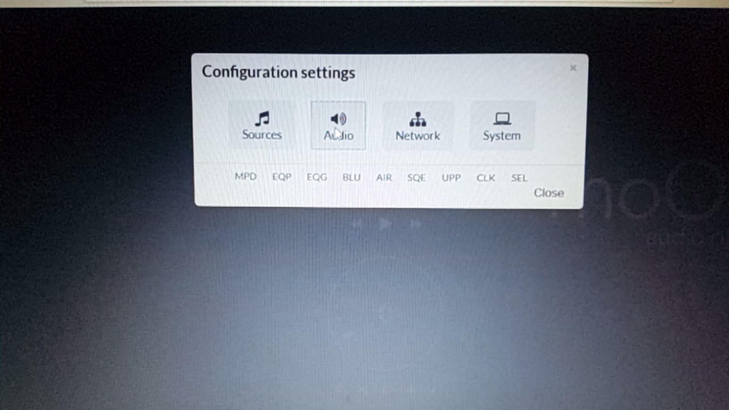

Hello Tim!
Thank you for the latest release! been waiting for quite a while for that one
I have installed the latest version using the image builder, and everything seemed to go to plan with the pi rebooting several times, as I was watching the process using moslog.
After the final step, everything seemed to work fine and I was able to access the pi using the browser.
But then a problem arose: everytime I try to navigate between configuration windows (from source to network or any other option) the interface hangs, and then very briefly flashes (Had to slo mo film it to read it) "Reconnect system rebooting" and then back.
Any idea why that might be?
(attached pics below)
To be noted that any changes do not get saved anymore, And as such I am unable to mount my NAS drive nor a usb hard drive
